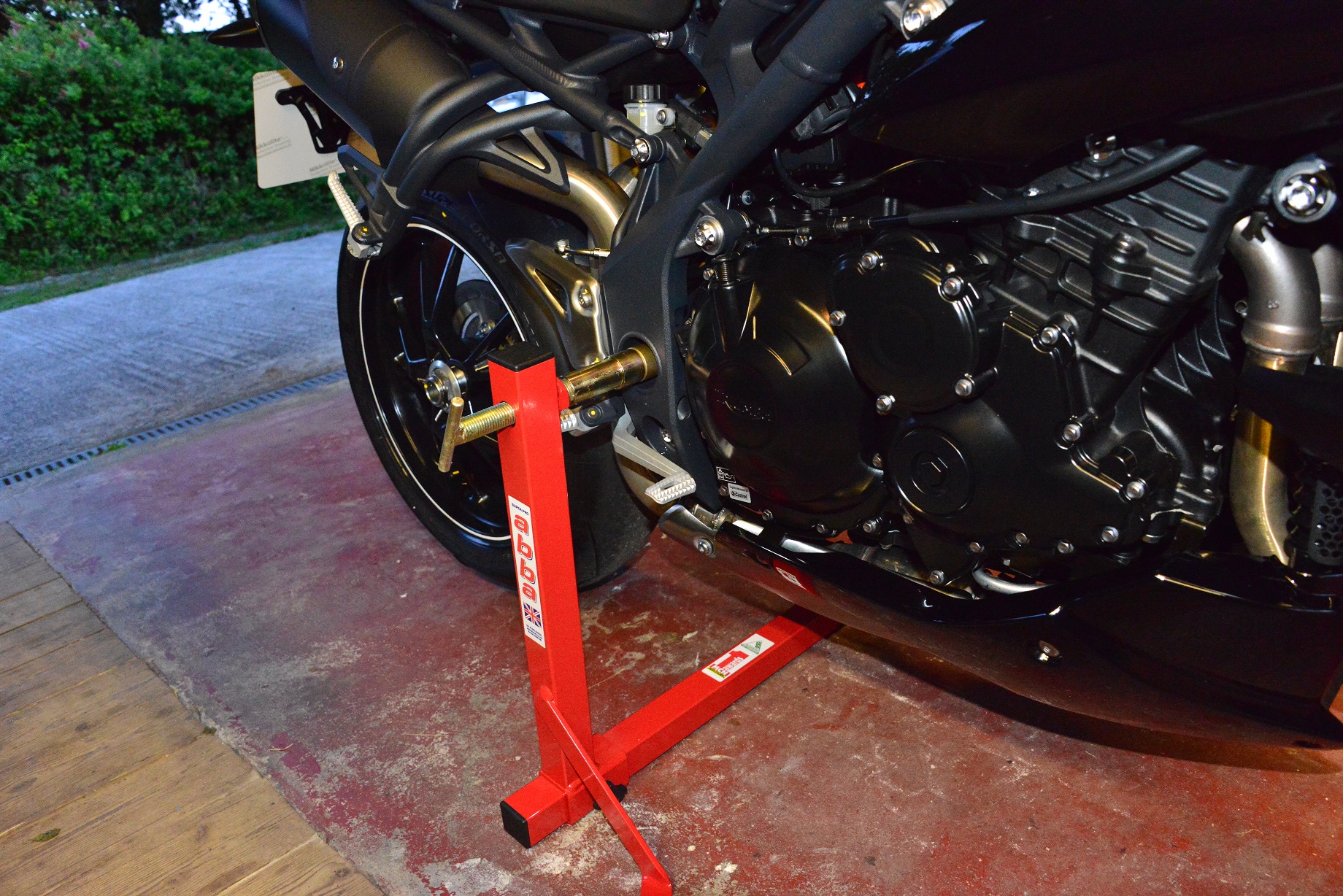

    I use the 'normal' Abba Superbike stand, comes with the spindle adaptor etc to lift the front off the ground if needed..... Not anything like as much as the Skylift though! Depends what level of maintenance you're planning I guess!

    Me too for the normal Abba, being close to centre there's not a great deal of weight on the front wheel. Bike's only a few months old so haven't needed to change tyres yet, but on last bike I put a bottle jack under each fork leg and like you I have a handy overhead beam which I use with a ratchet tie-down strap around the top yoke or handlebar clamps.
    Only slight criticism is that the Abba stand flicks the side-stand partially out of the way on the way up, so be careful to flick it back as you bring the bike back down.

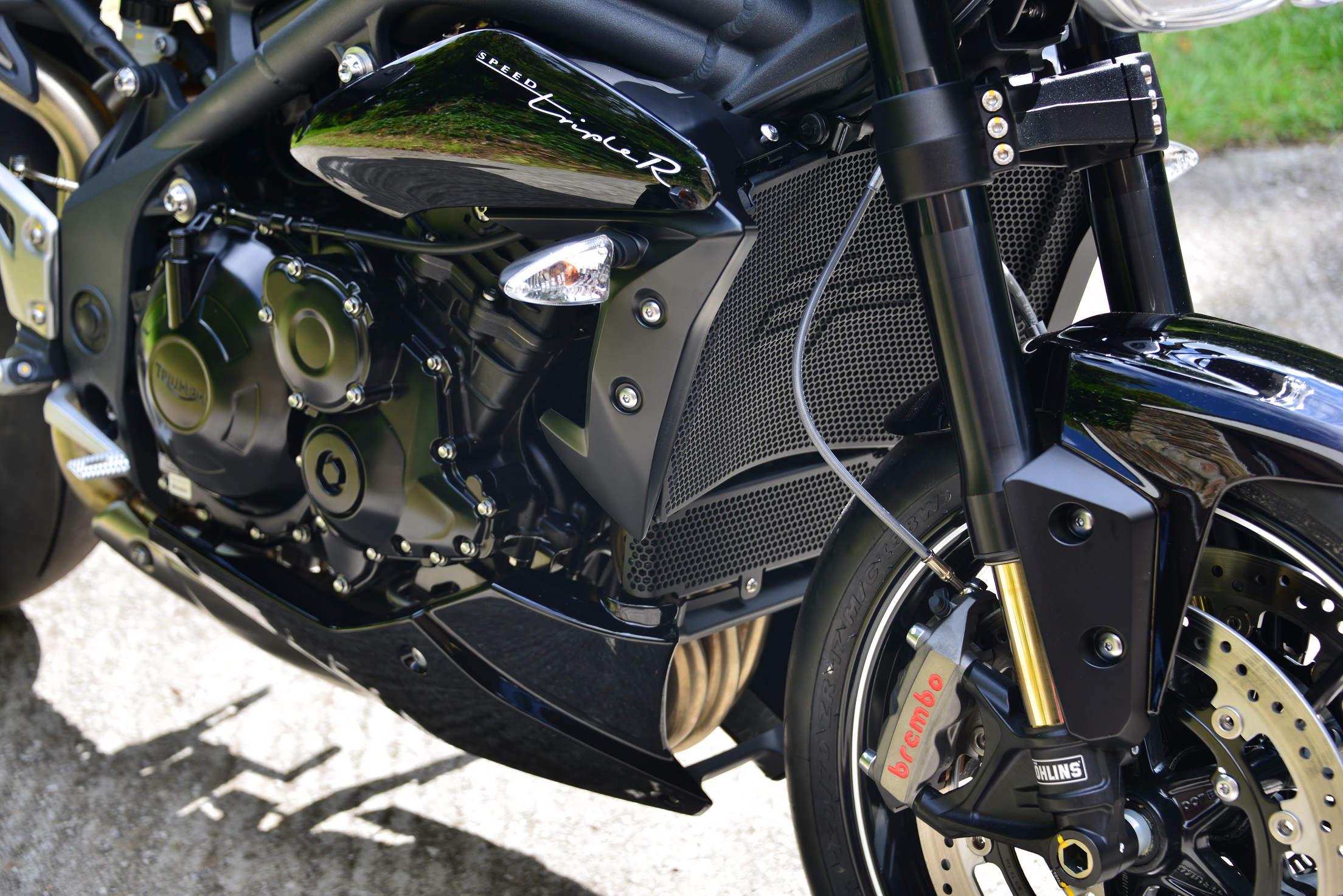

    How about some radiator guards? Stops the fins getting damaged by flying grit off the tyre and I think makes it look neater. I've got bar end mirrors, anodised brake reservoirs and levers on order from Santa. :)

    I have had the radiator guards on all my bikes I think you are right looks great and adds that bit of protection.
