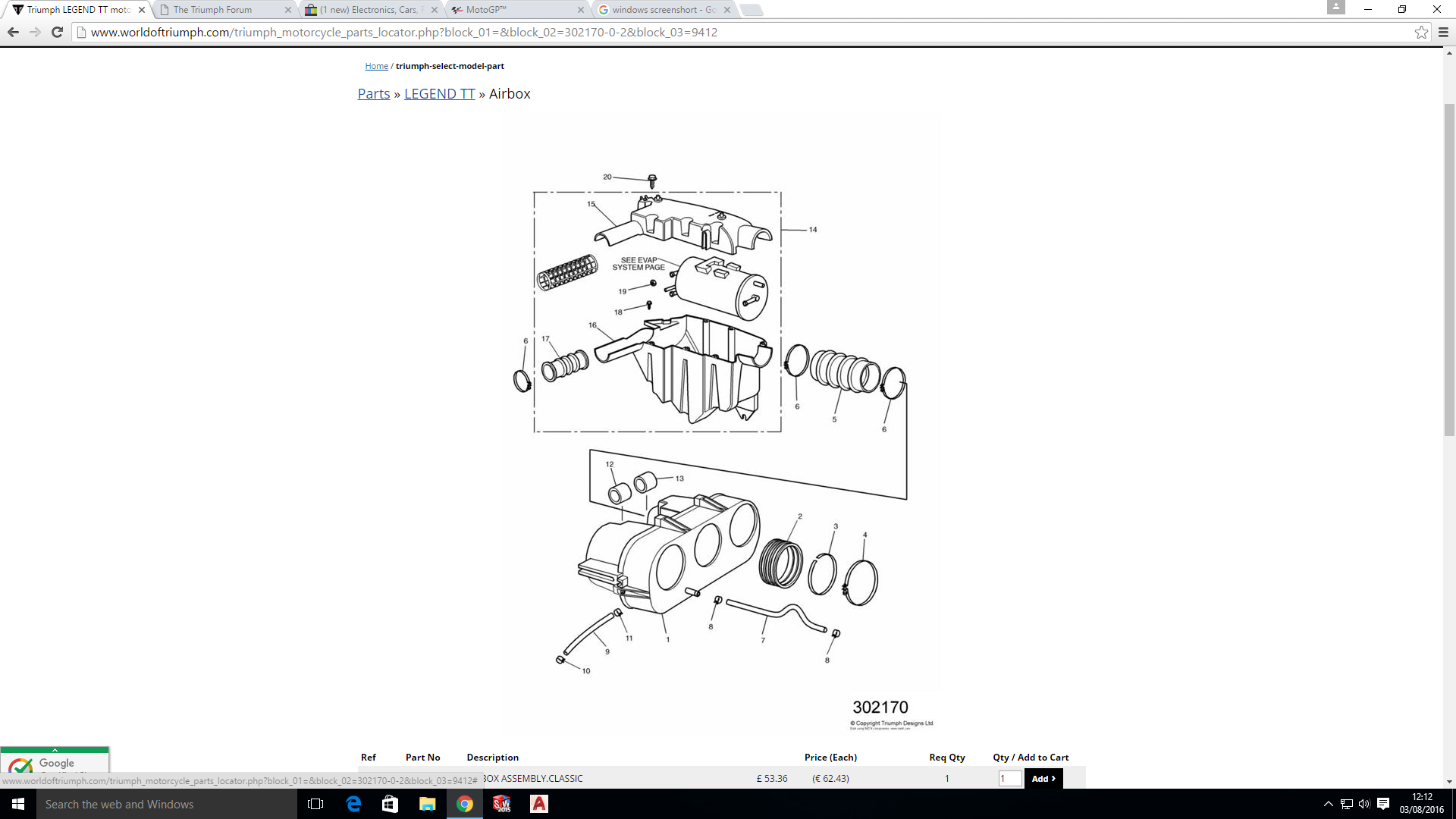

    I have got a 1999 Legend TT, which is a bit fluffy on the throttle, decided to remove tank etc for new plugs. Whilst digging around i thought i would take a look at the air filter....what a.... T#*T!
    Anyway, managed to remove the back cover revealing an extremely dirty, clogged, petrol soaked filter, it also looks as though the foam has broken down beyond repair. Now my first question is, can i just get a replacement filter and if so where from? I have only manged to source K and N replacement type filters, but would i need to re-jet carbs?
    Secondly, i have been told that if i want to replace the original filter i have to buy a complete air box which sounds ludicrous? This cant be right can it?
    Any help would be greatly appreciated.
    Cheers.

    it is correct that you cant buy a filter,only the complete airbox from triumph and they cost £42 plus vat at Fowlers and £53 at W.O.T.
    I know lots of people use k and n on their trident/trophy/sprint etc ( same engine basically as yours),not sure about rejetting, wouldnt think it would make much difference tbh. If I were you i would buy a k and n and put it into the airbox, it has to be better than the one you had in already. If the box is made similar to the Sprint one the screws usually break the threaded inserts and you end up botching it back together in some way,be that glue or self tappers. My bike has a standard new airbox so i cannot say for def, maybe others in here will know better. The original airbox on my bike had what looked like a nest inside it,no wonder it used to run rough,too rich.
    I will also say I had a CB500 and changed to a k and n ,never needed to rejet that bike.

    Been running K&N filter in my Trident for years. No re-jetting needed on mine with either original or aftermarket silencers.
    Good idea to go down that route as removing the air filter is a right royal pain in the arse, as you have just found out! A K&N (or similar) is pretty much a 'fit and forget' option.:)
    Be careful with the plastic airbox as the plastic is brittle and easily damaged.:eek:

    Thanks for that fellas, i am going to order the K and N filter, as i hopefully never have to see the inside of that stupidly design air filter box again!

    i changed my filter to a K&N on my 900 Thunderbird and didnt need jetting,Its Cheaper than the full box change. Also just to note i had to drill out the brass in plastic screws ( stupid design) as the thread part just spins in the plastic. I changed them to self tappers with no issues. You might me lucky and get your ones undone be they will give you trouble at some stage.

    Thanks Wayne, yes i have noticed the crappy brass inserts hanging out of the cracked plastic housing , I'm hoping Araldite may sort that little issue out.
    My only other query is this.... EVAP (Evaporative loos equipment).... i haven't got one... do i need one? what is it? and if i do need it, will it cost me a million pounds?
    The only thing that was present in that first auxiliary chamber was a white plastic loo roll size part with cut outs in, that was loosely covered in foam which had deteriorated to the point that i think it had shot through into the air filter box and fused itself to the air filter, hence causing much of the blockage.
    Sorry there are now two questions.... Do i need an EVAP system and do i need to replace that shonky foam on the loo roll?
