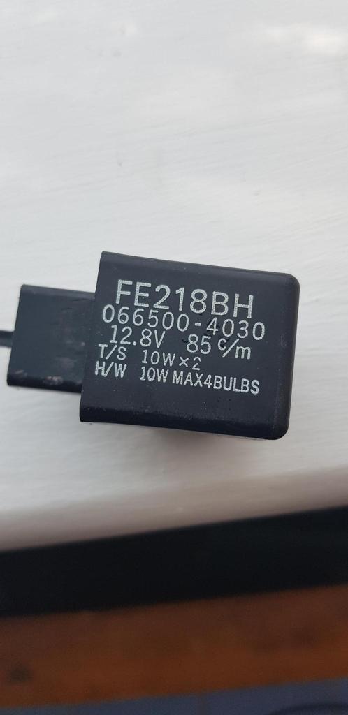

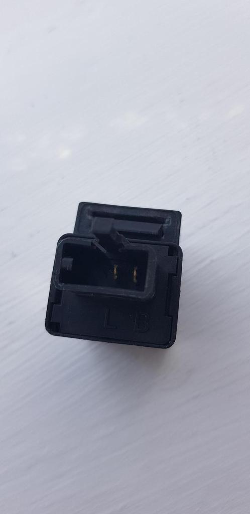

    Swapped my standard indicators for some LED ones. They have built in resistors, so that saved me some pounds. I was informed i need to change my flasher relay to a CF13 JL-02. It arrived today but this is a 3 pin relay and mine turns out to be a two pin, like in the pictures. Can someone tell me where and what is the right one i need?.

    I'm definitely not an expert but if resistors are built in surely you won't need to change the relay?? I thought you needed one or t'other to get the correct flash rate, not both....

    Found a 2 pin relay, plugged in and hey presto the indicators work. Even though the indicators say they have built in resistors i don't think they have. Like you said with the resistors a new relay should not be needed.

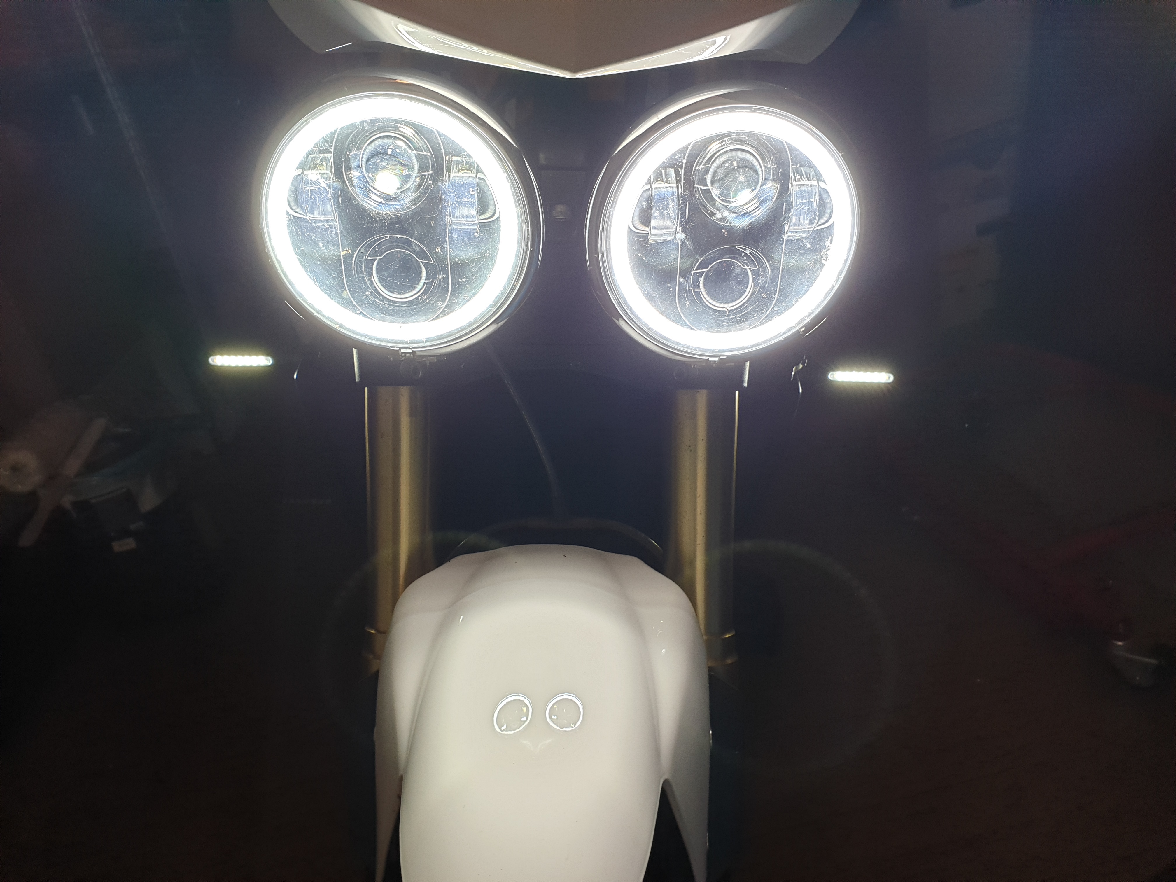

    I've got similar ones. No relays needed, just one extra live wire for the DRL.

    Didn't want DRL. Don't like them if they're not in the headlamp.
  8. Vulpes
    18,562

    Wow, £200 or £12 massive savings, i wonder what the look and feel like.
    I had a close look at the Triumph ones and felt in love with them straight away, amazing build quality and attention to details no wonder they so costly. Really want to get those, but its hard to resist the bargain of £12.....hmmm not sure
  10. Artemij
    Artemij Well-Known Member
    Feb 24, 2019
    48
    Tockwith
    Are DRLs and indicators in the same unit and change from white to amber when indicating?
    Thanks
  11. Vulpes
    18,562
    Yep.
