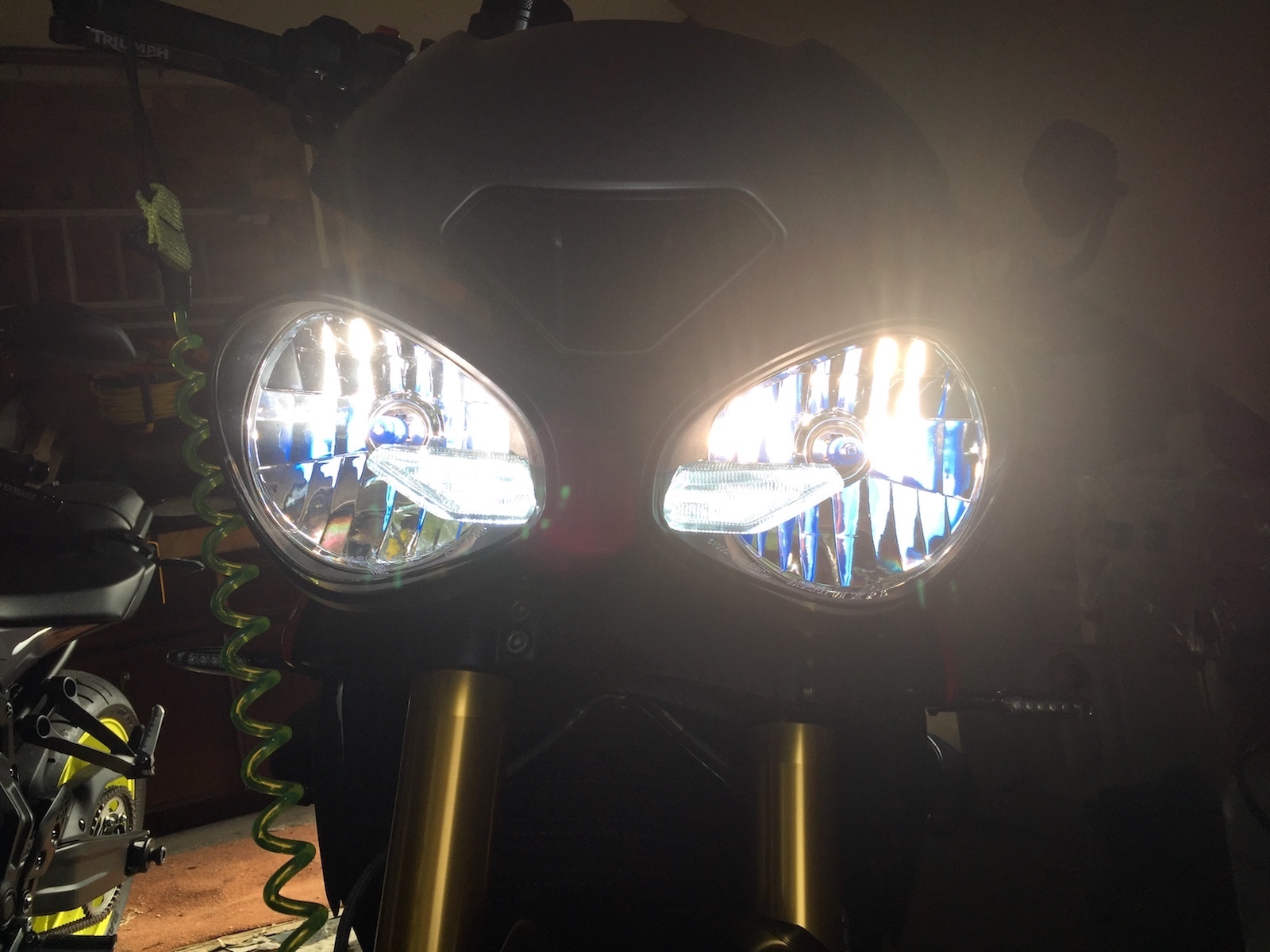

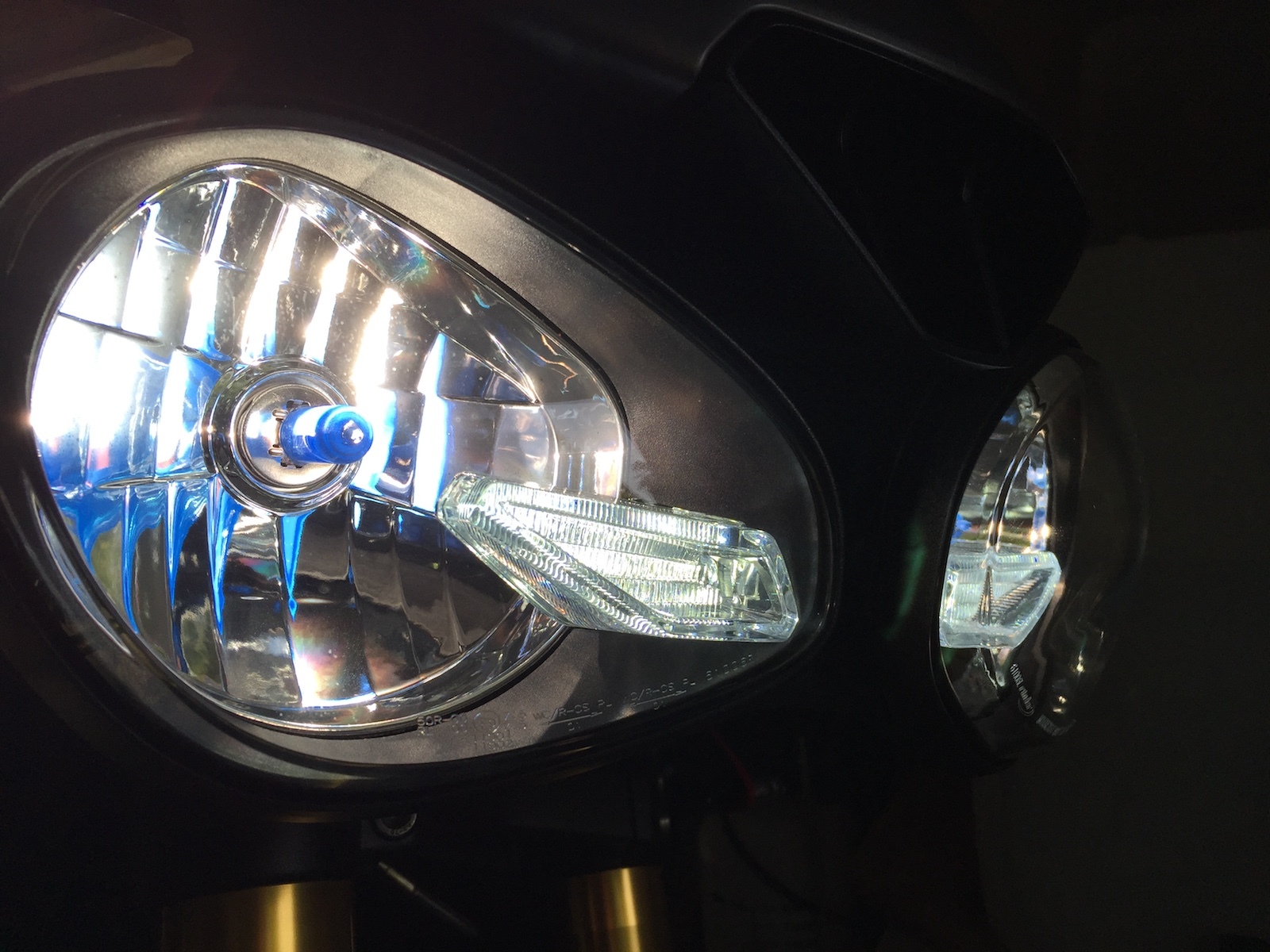

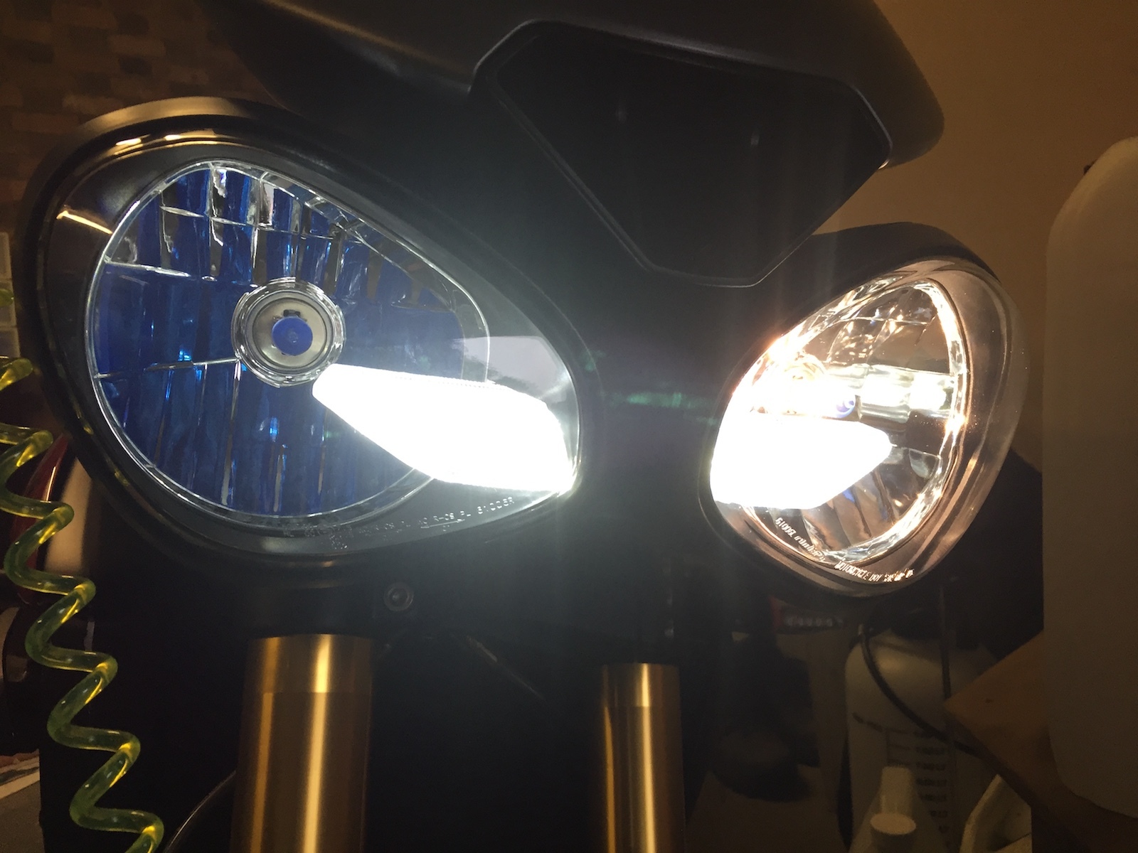

I've had Philips Diamond Vision 5000K H4 lamps fitted for the last 18 months - they are bright and very visible but don't light up the road as well as the stock ones did. They're coloured blue, which creates a distinctive blue reflection when they're switched off. When on, they produce a cool white light as expected, and give a bluish flash from the reflectors as the viewing angle changes. Summary - they look amazing, but they're not as effective. I rarely go out in the dark Headlamps off / DRL on: Headlamps on / DRL on: Headlamps on / DRL on: Note: The blue colour is only seen on the reflector...they do not shed a blue light.

Are you telling me that the DRL isn't on when the headlamp is on ? I thought it remained on...but dimmed slightly - is that just the headlight shining through? I swear it looks as if it's switched on. I did say I didn't go out at night.
OK. I've just been out to check. The DRL dims but remains ON when the headlight is ON. I disconnected one side to prove it to myself. To answer your question...you just press the rocker switch Left headlight disconnected...DRL still on while right headlight is on:
Thanks for doing that, I always presumed the DRL was off when the main bulb was on. What I don't like is if you have the main light on full beam, and switch the rocker to DRL, the main beam stays on! Just really wish it was possible to flash the main beam when the headlight is on, instead it changes from full beam to low beam
