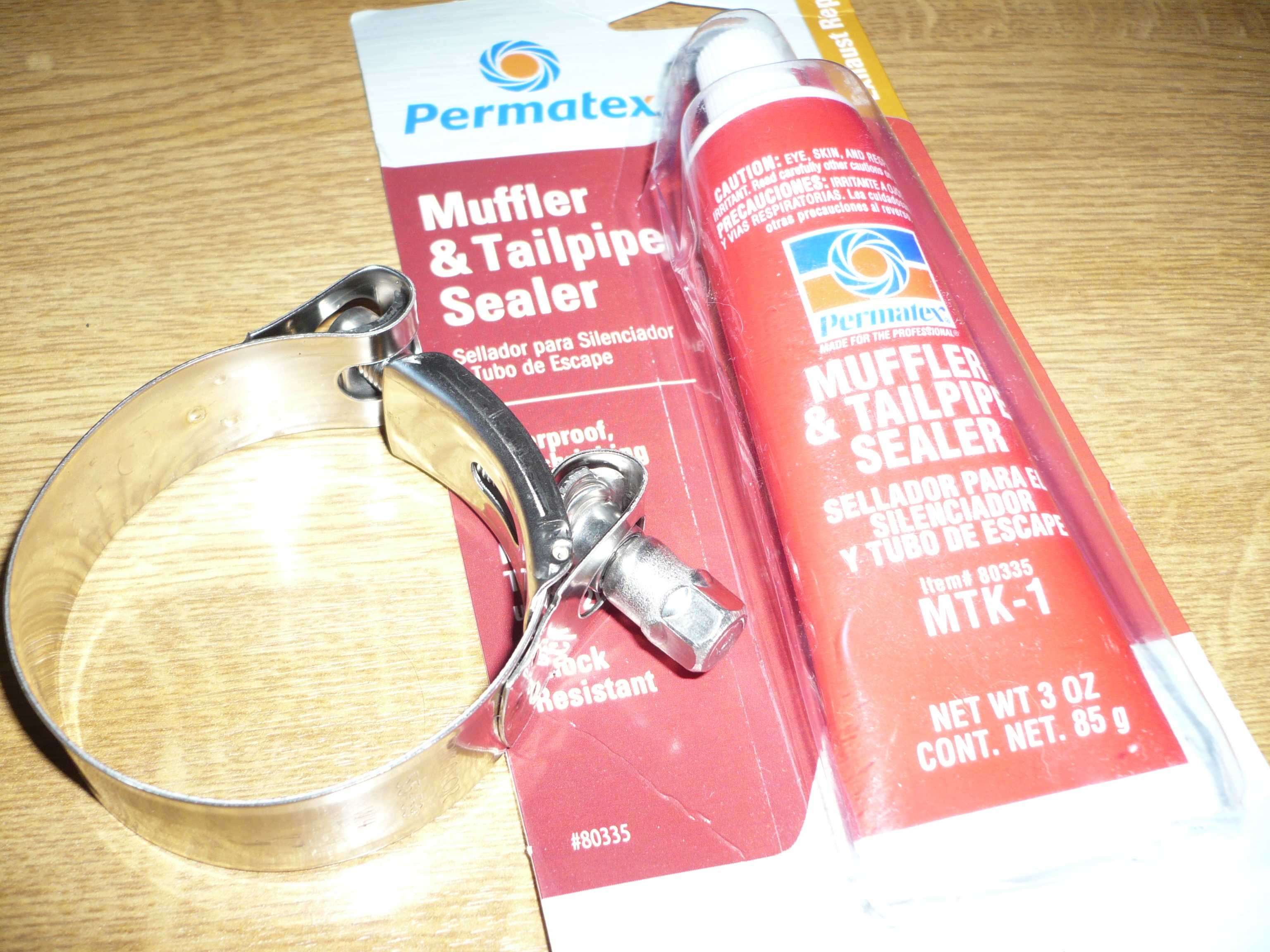

    Not to worry mate, will slice the end can (see below) with a 0.8mm cutting disc then clamp it tight tomorrow.

    Finished fitting my mates TEC (Tatty Exhaust Construction). Problem sorted (or bodged). Can has been slit at slip on end, sealant and clamp. The whole experience has been a messy one. Personally I would not recommend this product. Others have had better positive experiences. This product supplied is very low quality, rough machining and poor welding. Wafer thin metal, 2 out of 10 tops!
    Add the cost of the bits below and time spent sorting it, ......go Arrow!
    I picked mine up for around £290 on eBay new
