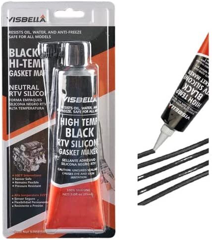

    You may have to remove the whole lot to tighten everything up or use some high heat silicon.
    This is the stuff I use, it turns into rubber and seals/holds really well.
