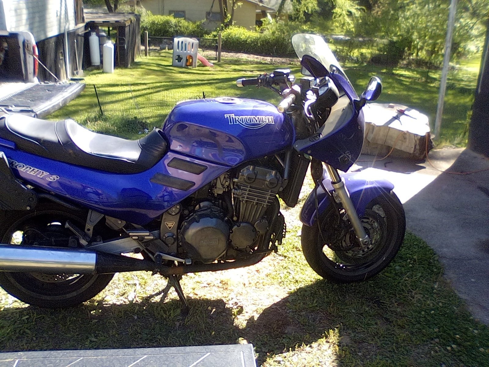

    So I am going to change my sprag clutch myself because I cannot find any shop willing to do it. The bike is a 1995 Trophy 3 900. I have questions and will have more questions.
    First question is, "Once changed do I have to worry about it going out again? Or will I always have anxiety every time I hit the start button?"
    Also. The shop manual says to not reuse the engine mounting bolts because they might loosen up. That really seems unlikely to me, but if it is a thing wouldn't some locktite be a solution?
    I'll wait to post more questions and will post pics soon.

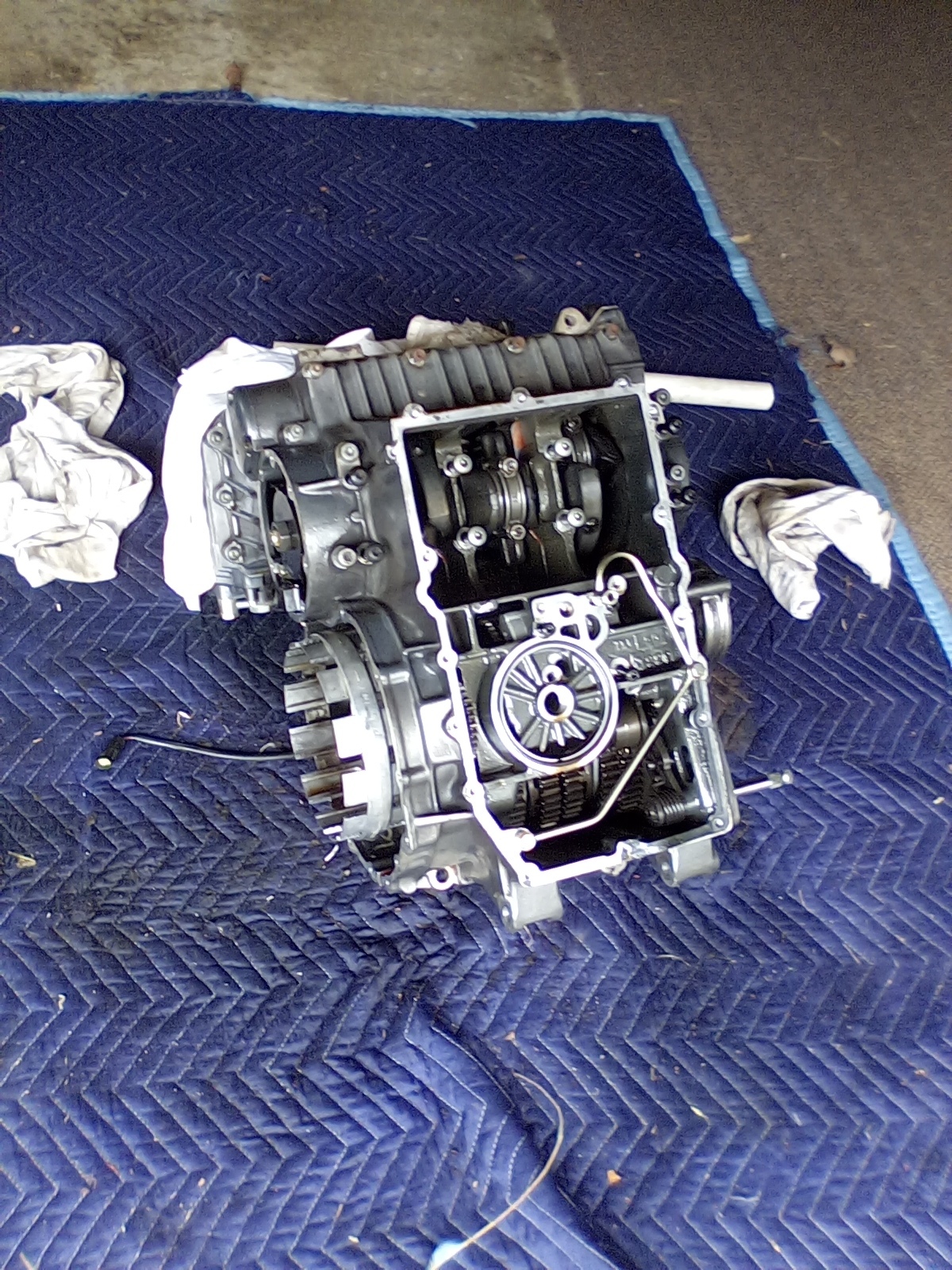

    Your pictres made me thankful that I have an ealy model with the lid over the sprag! Enables change without stripping the engine.

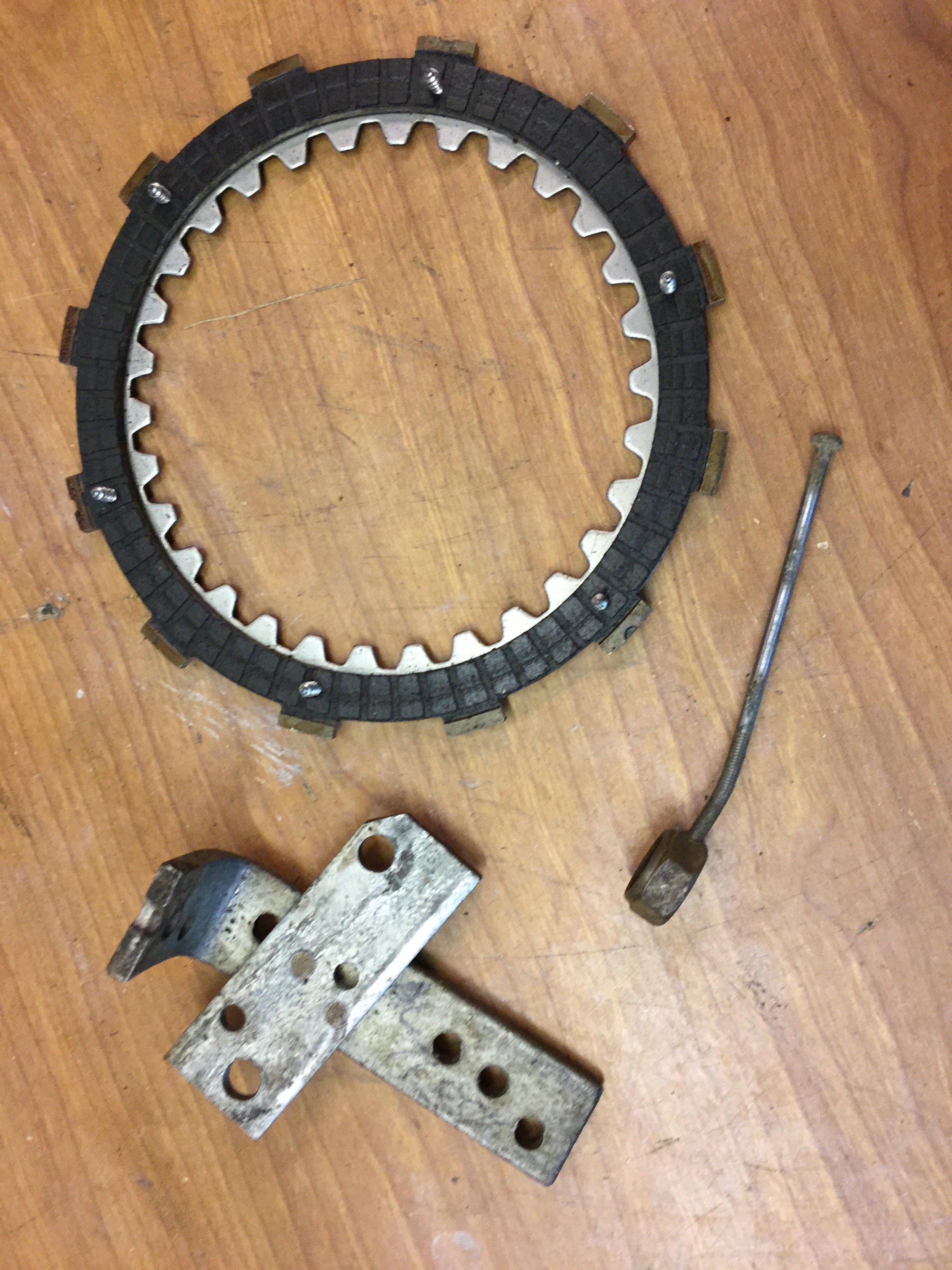

    I have today put new chain and sprockets on my Trophy and came across the "special "tools that I used for the tool to lock the alternator drive to allow undoing the bolt on the other end, and the clutch locking plates to allow clutch center nut to be undone and tightened up again.
    The nut on a stick is the one that hides behind the gearbox on the end of the bolt that holds the left footrest, it is the standard nut with a 2BA bolt about 3inches long screwed into one point of the nut, once the footrest bolt is tightened the 2 BA bolt stays in place until the next footrest removal. I gripped the extension with a small vice grip to give enough length for the job.

  11. Triumphant Tony
    Triumphant Tony Active Member
    Jan 30, 2023
    83
    Western North Carolina
    #11 Triumphant Tony, Mar 30, 2023
    Nice!
    Normally in doing a major project I will not attempt anything else to make troubleshooting simpler. However I am tempted to do a valve adjustment while the bike is unridable to not lose the season.. I am fairly certain it has never been done. I think there is about 30k miles on it.
    Thoughts?
  12. Triumphant Tony
    Jan 30, 2023
    83

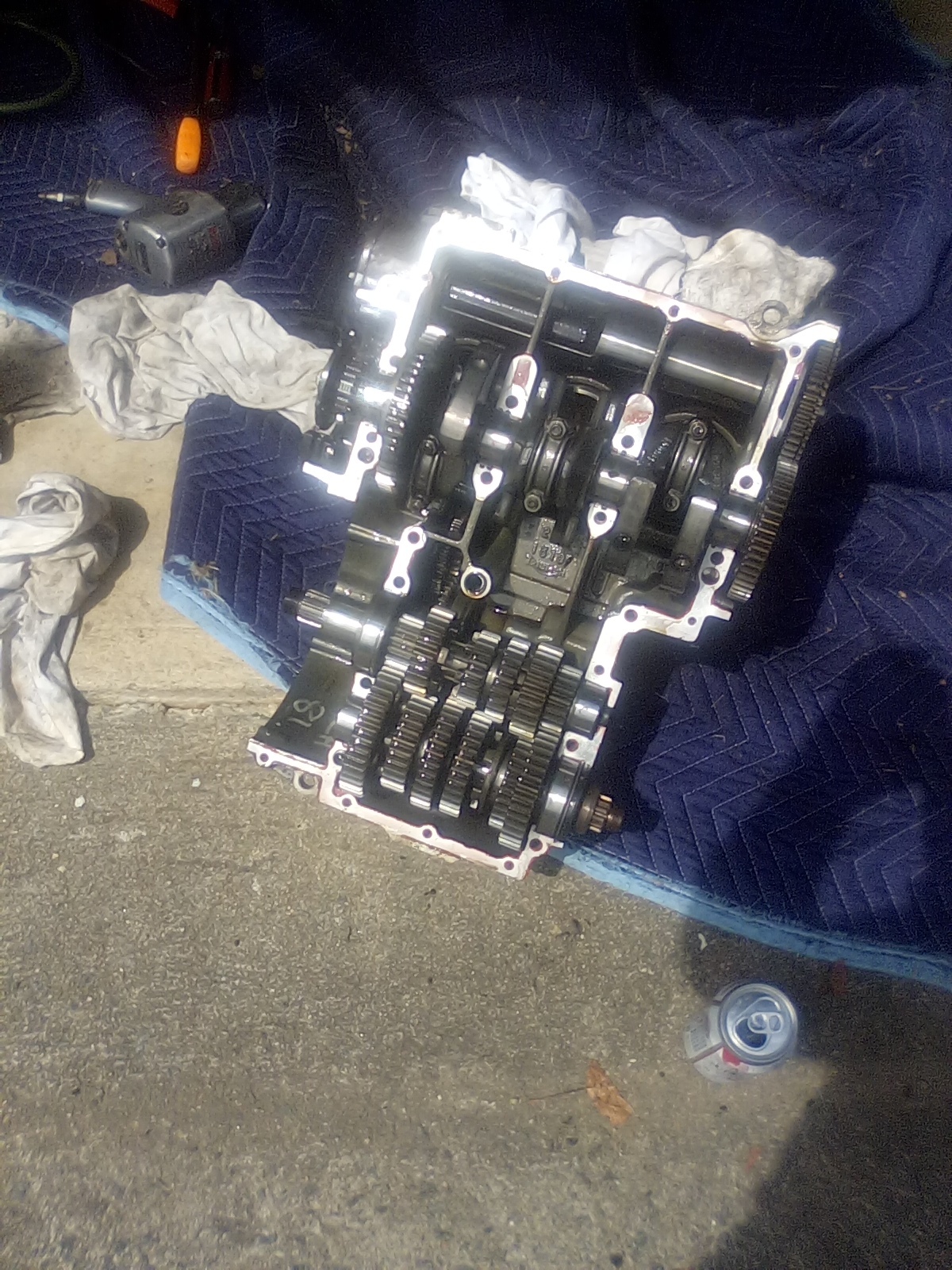

    Well I got the bitch back to this.
    I've been thinking that I would sell it because I honestly don't want to stress about that damn sprag clutch! But 2 test laps, and I kinda want to keep improving her and riding her.

    The battery it came with is a 220 which I have had tested. All they could test was the state of charge which was a 100 since I had it on a charger. Once I broke open the case it was obvious it was not the first time.... I do like the bike though.
    p.s. Only had two extra screws!
