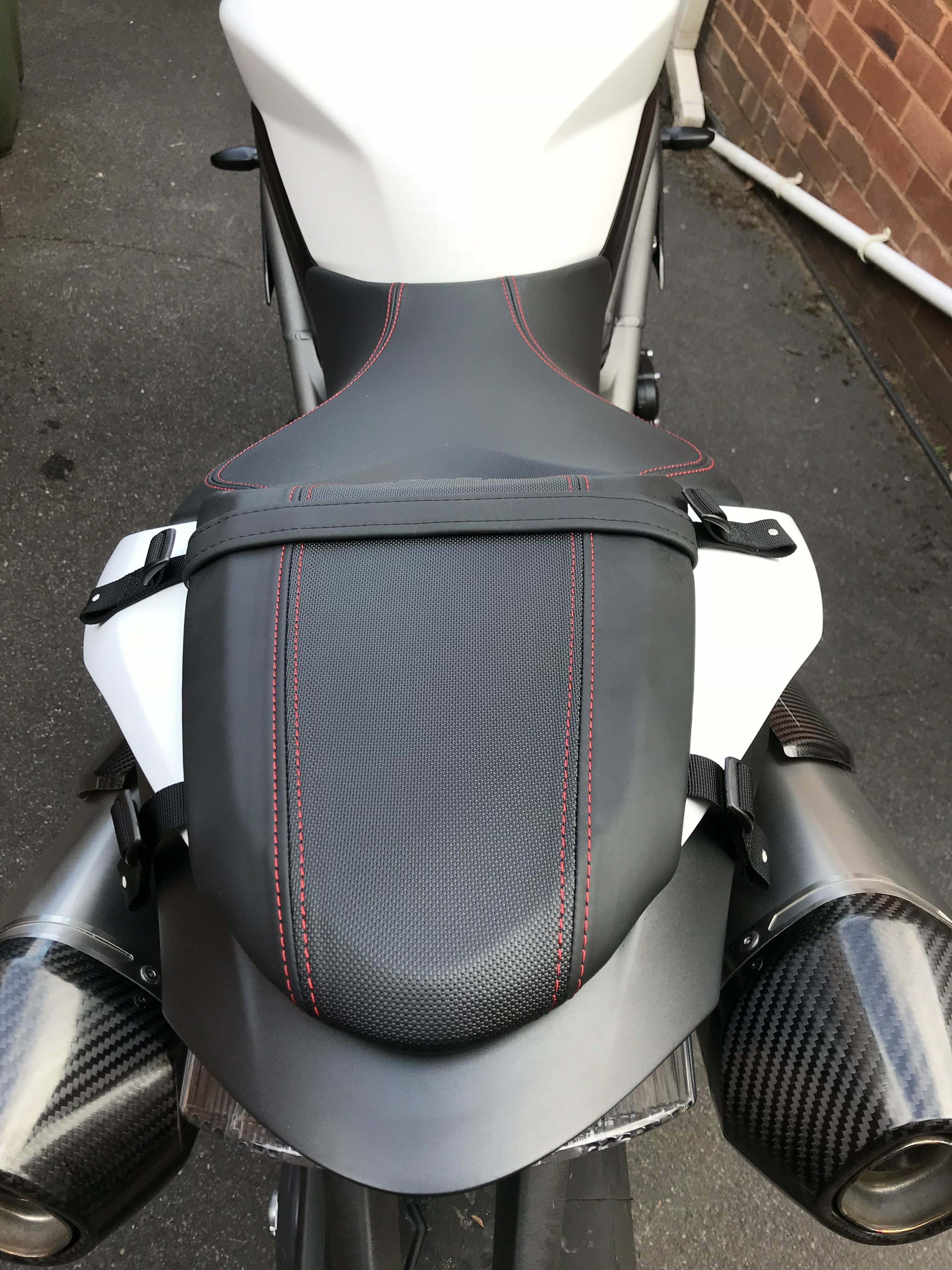

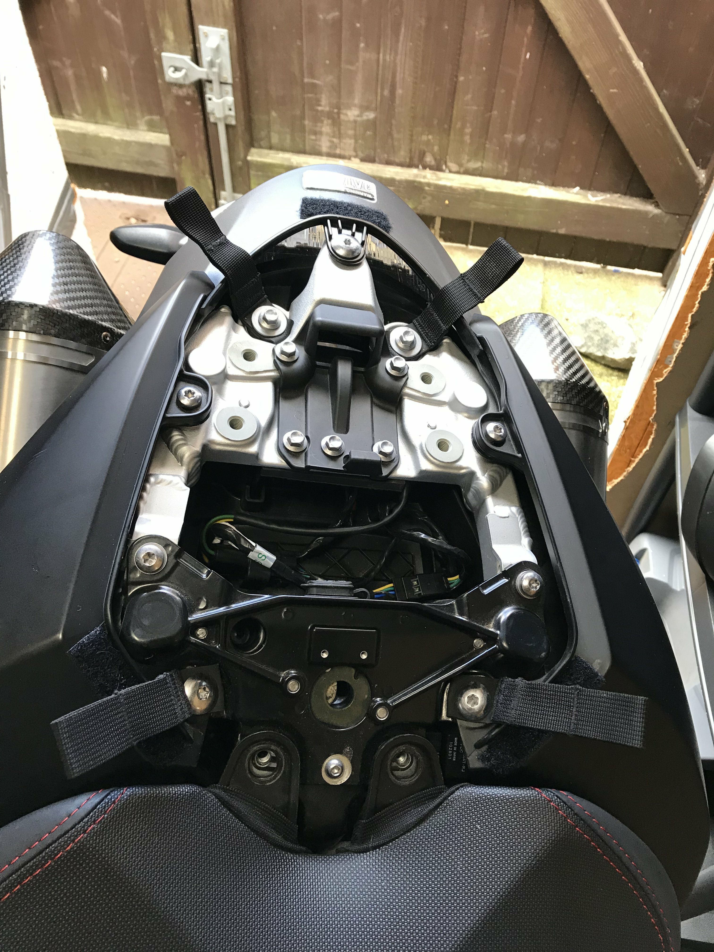

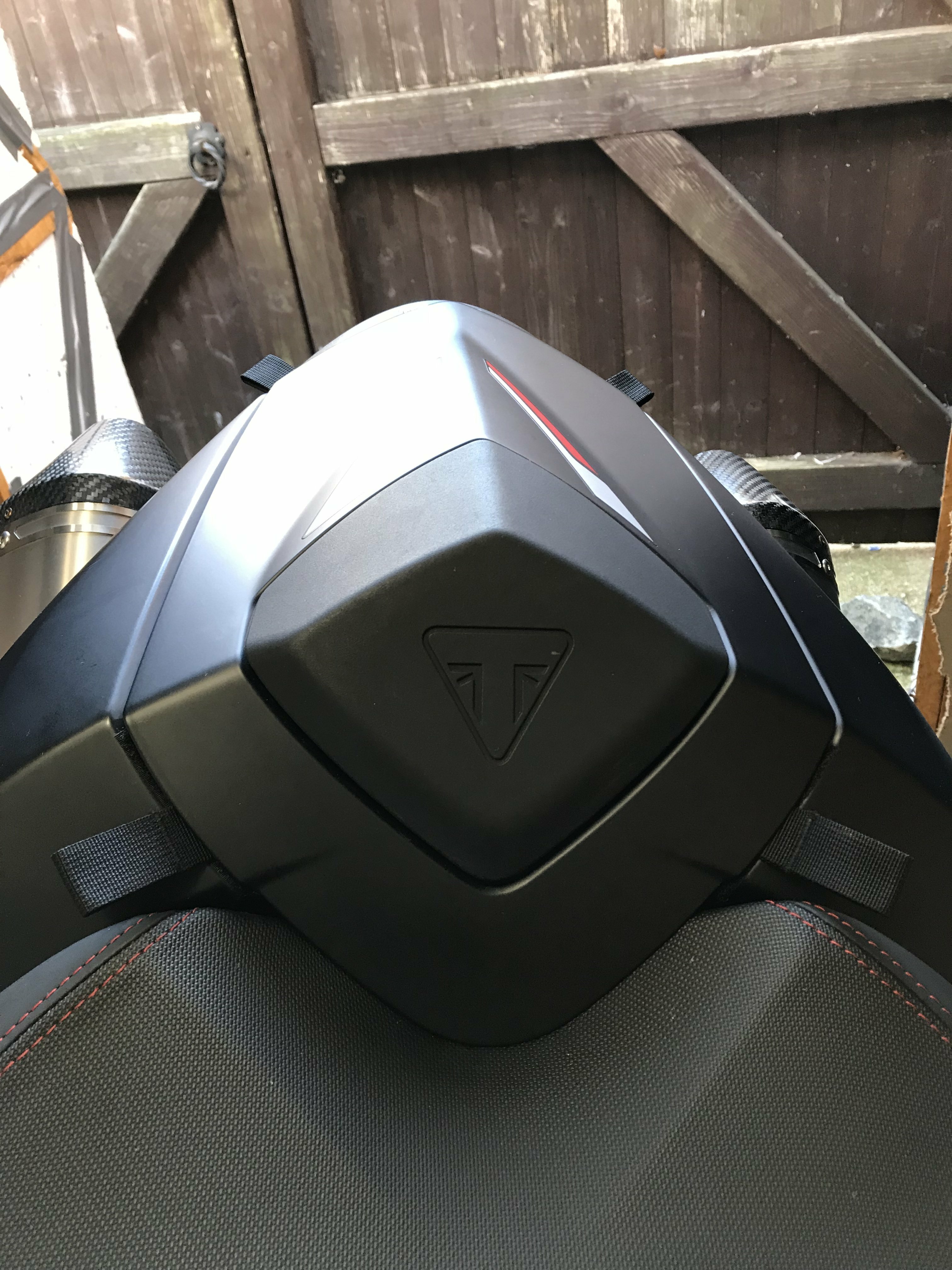

    Here's what I did.
  6. Bad Billy
    6,800
    I did the same on my Street RS when I went to Spain last year, just used some strapping that came of an old freebie visor carrier, used the end of a soldering iron to make the holes to bolt it to the underside on the seat and jobs a good un!
    View attachment 51434 [/QUOTE]

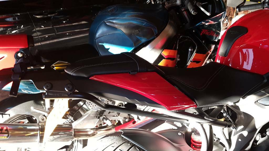

    I went for a diff approach, not an rs but same butt, fitted a sw motech rack, not that offensive and with an intergrated light unit looks good.
    I can now safely attach my kre rucksack with laptop in. IMG_1551022876366_67226.jpg

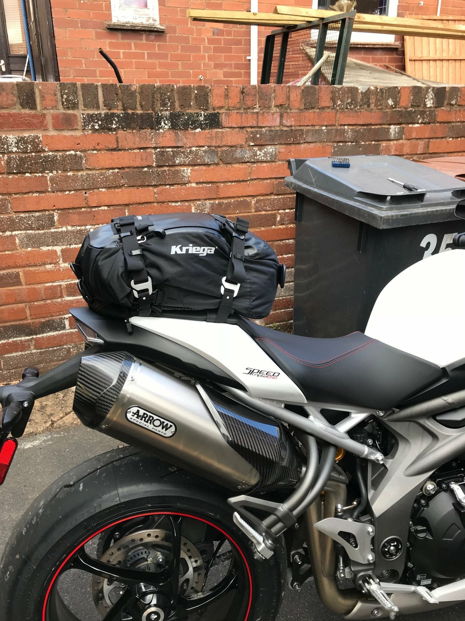

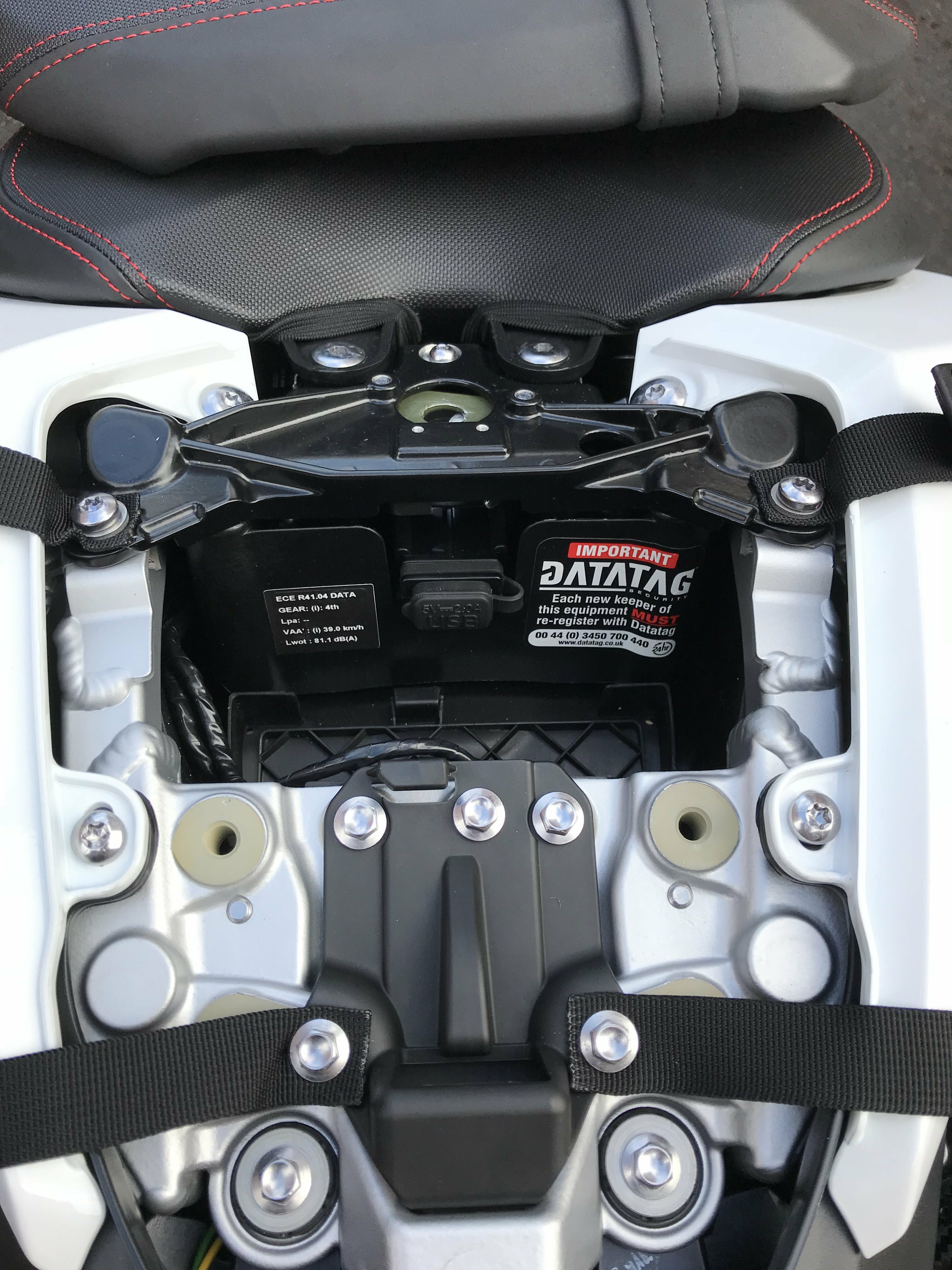

    Kriega have just released a fitting kit specific to the Speed Triple RS. I just got back from a trip using this with a US 30 and it was excellent. It's pretty much what's shown above in the other pictures. One set fit to the underside of the seat and the other to the mouting points of the number plate hanger.
    The link for the kit is https://kriega.com/sports/touring/speedtriple IMG_1577.jpg
