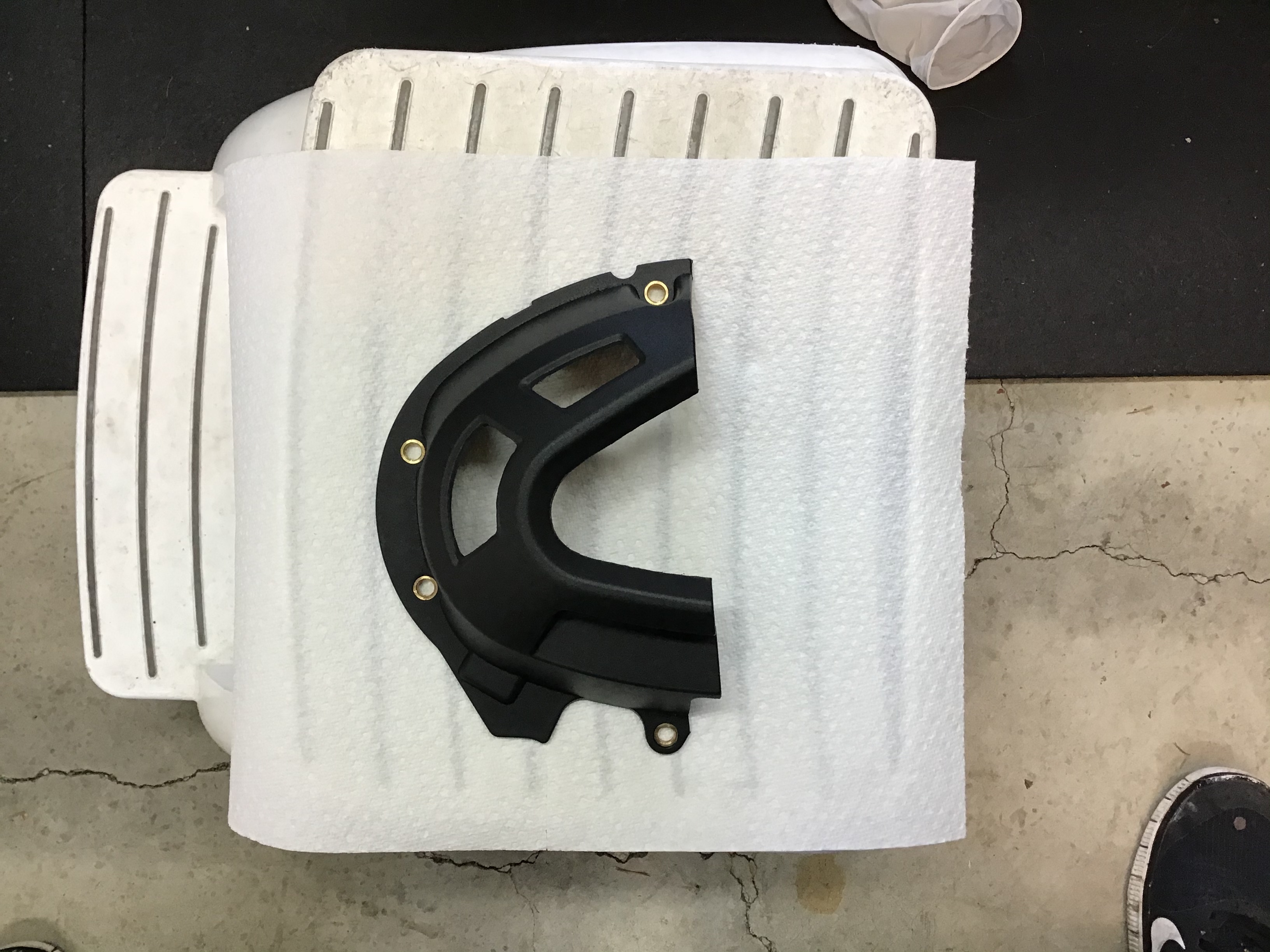

    Did this to my cover a while back. Might have an advantage over looks alone.
