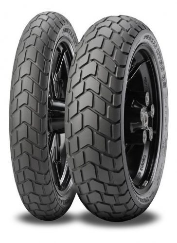

    Pirelli MT60 RS is an off road style tyre fitted to Triumph and Ducati Scramblers - not a serious off road tread, but should be ok on gravel. They describe it like this - "Available in the most common sizes of 120/70 ZR17 & 180/55 ZR17 if you fancy green-laning your Honda CBR600RR or similar."
    Michelin Anakee is another 80/20 knobbly tyre in that size.
