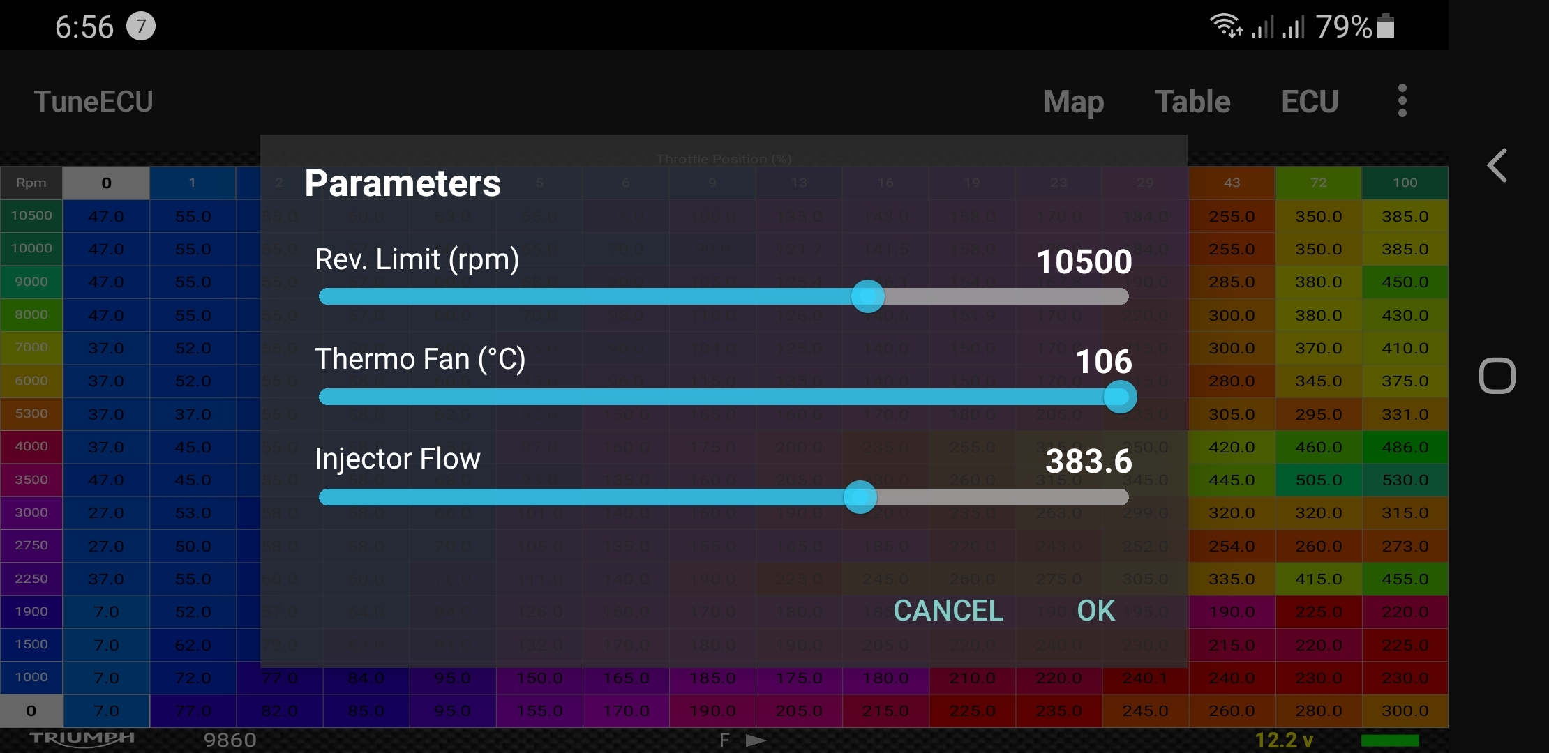

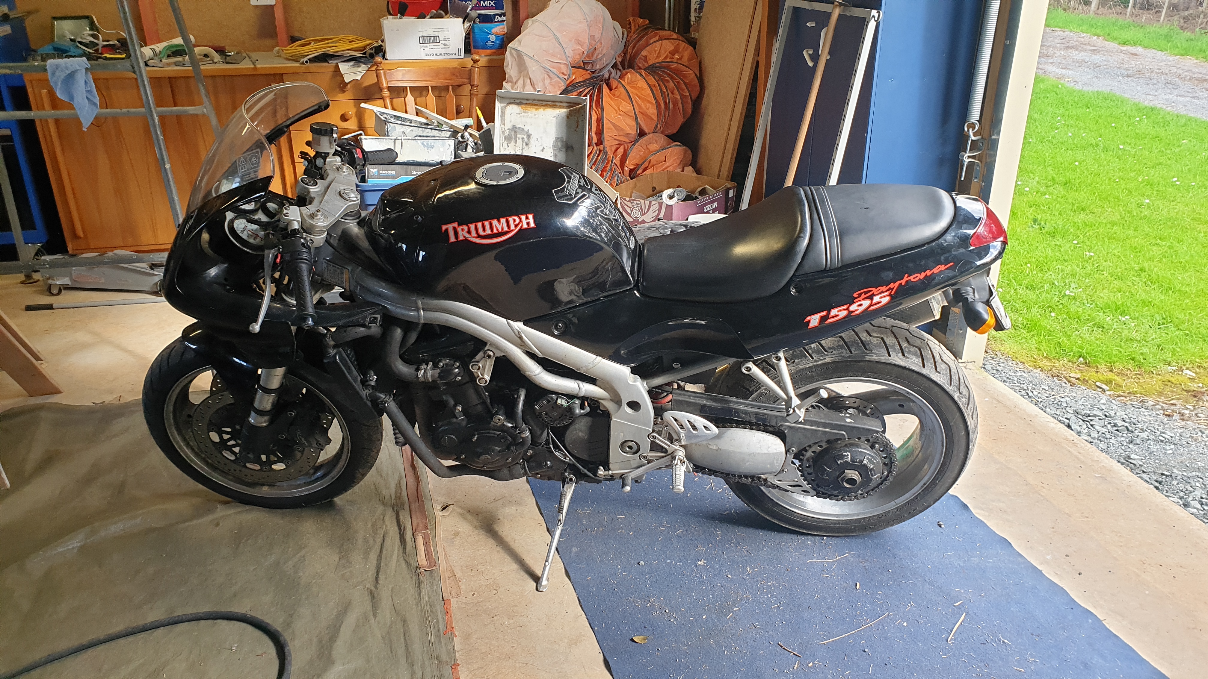

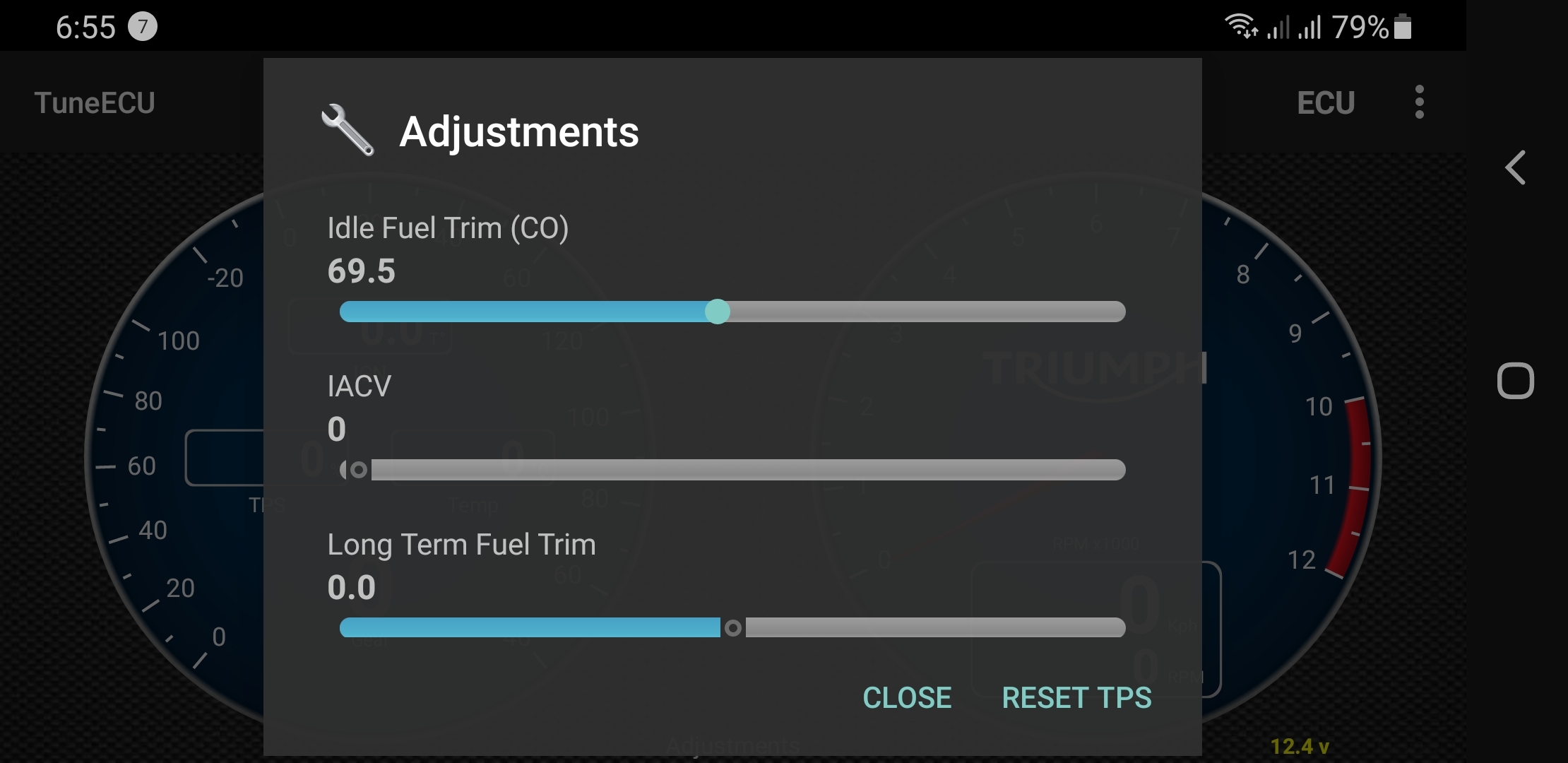

    My ride is a black 1997 T595 which I have owned for around 4 months and although I purchased it with issues I love this bike. So far have replaced the fuel pump and neutral switch which has fixed the issue of it not running, but still have a starting issue. If I either pour fuel directly into the TB's or spray engine start in airbox it fires then runs great. It will not start cold without doing this. I also have tuneecu bringing up no error codes. Running correct tune 9860, new plugs, new battery tested fine and is fully charged. Anyone have a checklist on possible reasons why it is doing this? It does have a noisy sprag clutch and the IACV reads 0 anytime I check in tuneecu. Any help would be greatly appreciated. Cheers J
