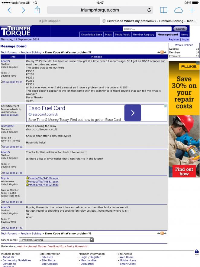

    Had a very quick look for codes but only found some on the image below. Clicked the media files but you need to be a member to download them, sorry but no time to join and get them but you can of course.
  11. timnorth
    timnorth New Member
    Sep 6, 2014
    4
    Thanks you are a star
