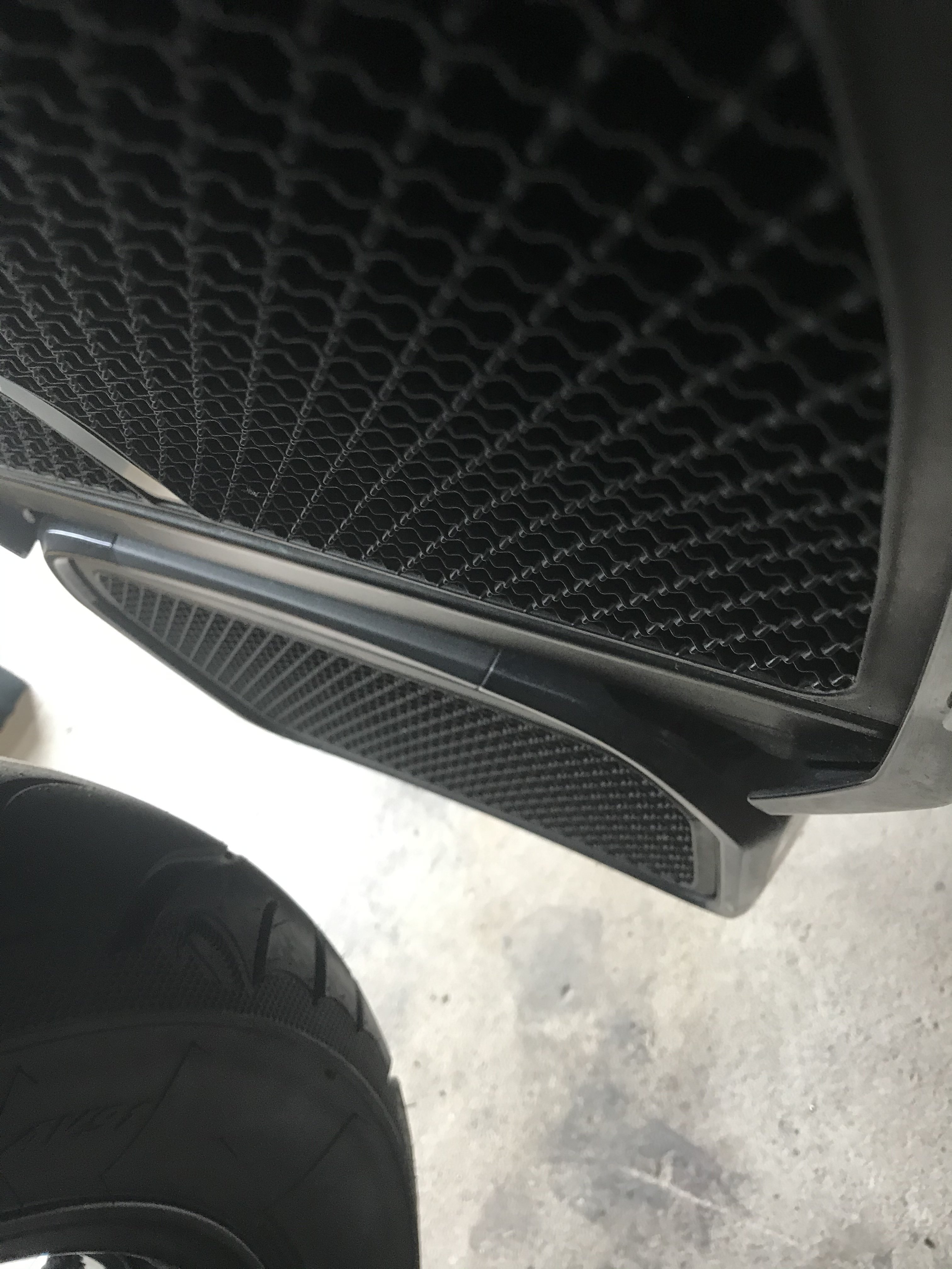

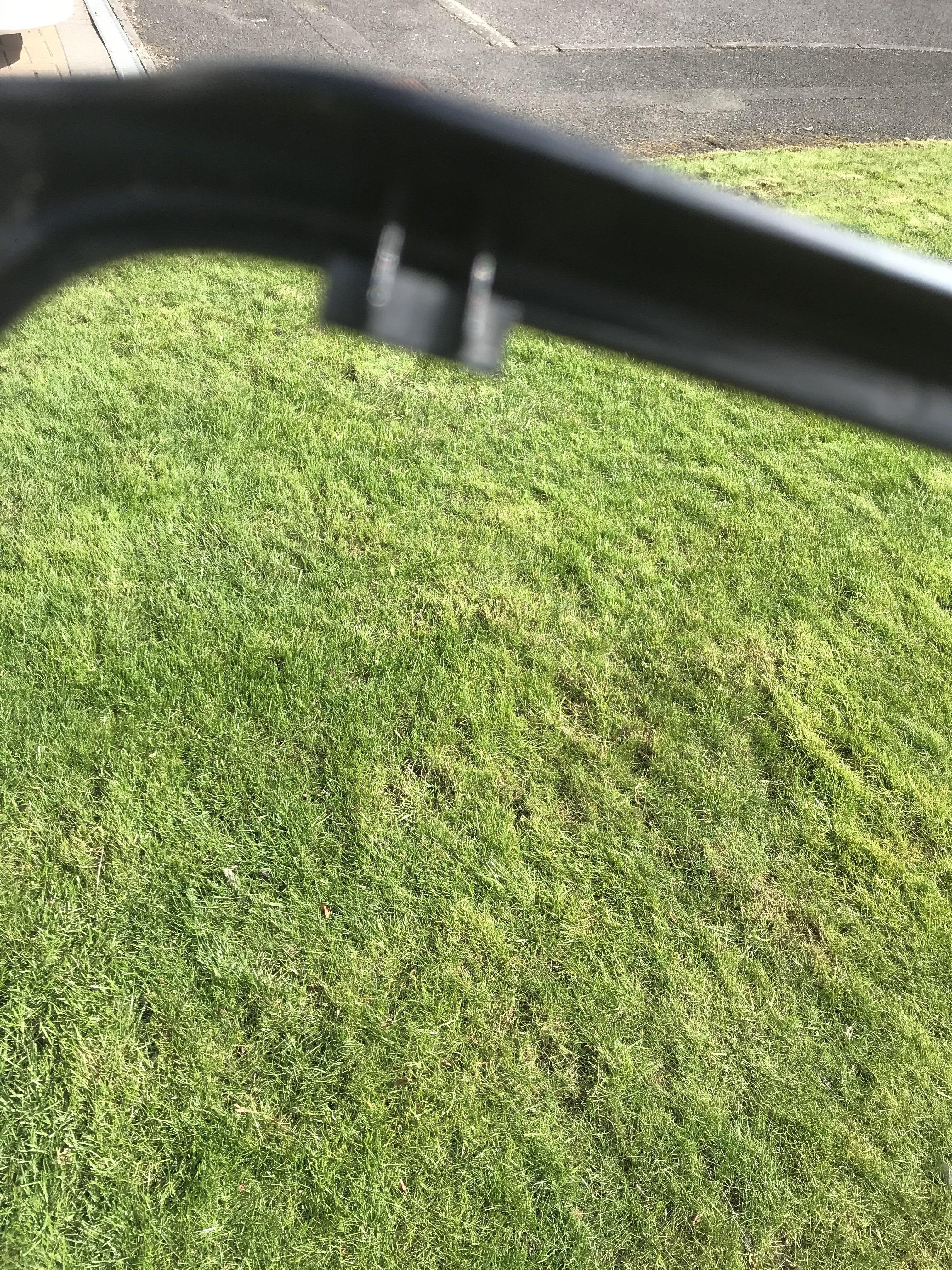

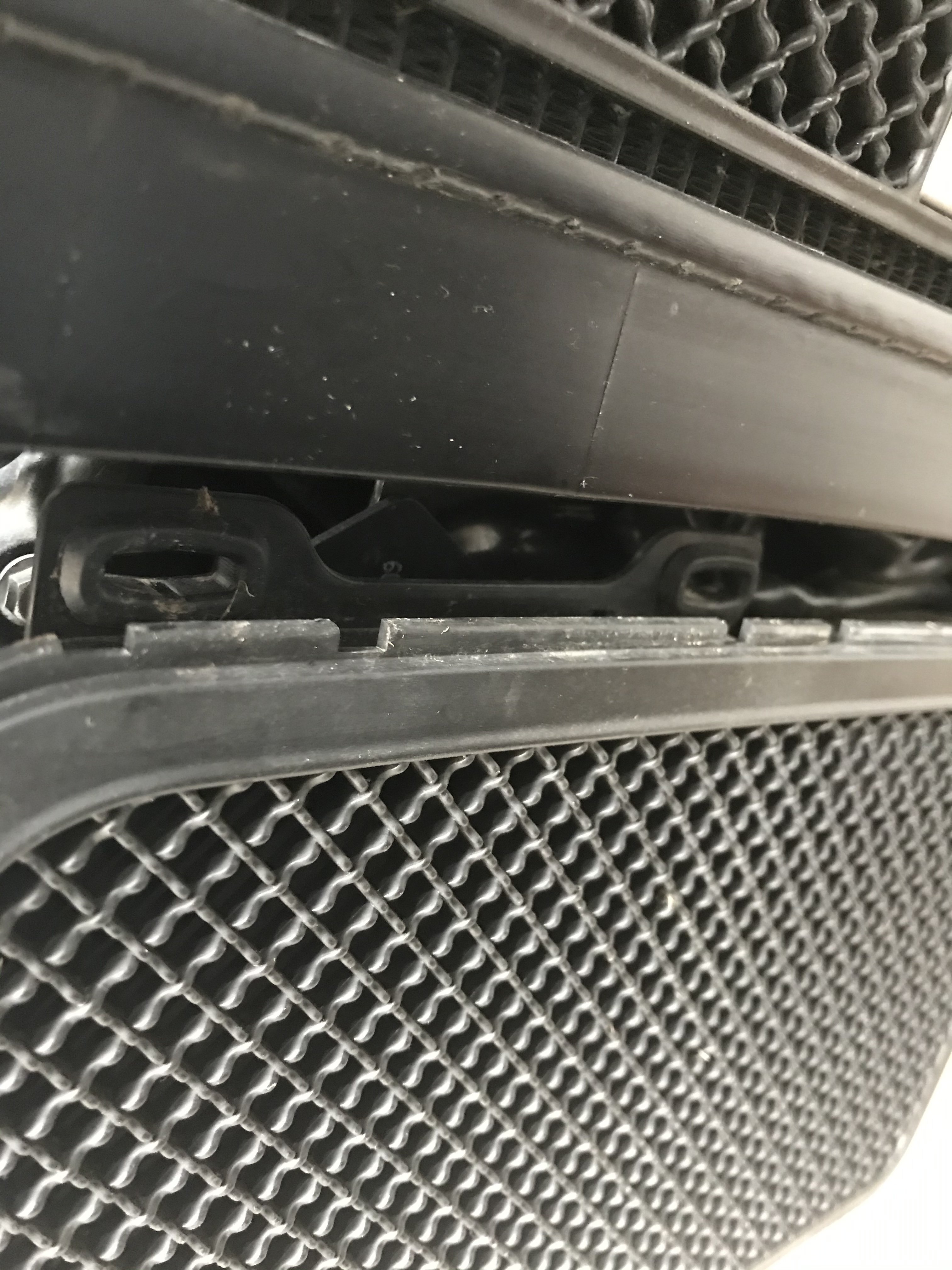

I noticed while cleaning the bike yesterday, that the lower part of the front grille (not sure really what's actually behind it) looks like it's hanging off: https://imgur.com/a/2dGcdHN In the first photo, it's the bit closest to he camera, the second pic is from the other side, I tried to get an angle that showed it not being flush with the line of the upper grille. I'm not sure if it's always been like that, something new, or if that's just the design. Could anyone with a Rocket 3 please let me know if theirs is the same? I had a quick look/feel, it moves slightly, but not very much, and I could see anything clips or anything that would hold it back in place.

I did already get down and have a look, pushed it a bit, it doesn't want to go back. I just had a fairly proper look, lying on my back. I can't really see any 'problems' except that it isn't sitting right. The painted surround of the grille does seem to be loose against the grille itself, so I can push it back a bit, but not far enough to even have it sit right - let alone stay there. There's a bracket that holds (what appears to be) the frame to which that whole thing clips/sits. and there's a slight bend in it on the side that's hanging low, which I'm not sure if it's supposed to be there. I tried to take some photos, but I couldn't get an angle that showed anything useful. If I try to push up on the bracket from underneath, the bike starts to move on the sidestand before the bracket would bend. The only thing I can think is that perhaps the dealership had the bike jacked up while doing the service recently, and perhaps didn't do it right? On the 'good' side of the bike, there's still about a 5mm gap between the bottom grille, and the top one, is that the same on yours too @dilligaf? On the 'bad' side it's probably about 10mm.

I couldn't actually work out how to embed the image in my post @Dozers Dad, and I was previously told on this forum that it's a standard easy place to dump images, it's not a spam site. I just tried dragging and dropping, which I didn't expect to work, but here they are ...

Thanks for the help guys, I have taken another look, and in my fiddling, the clip on the other side came undone, and it won't clip back in, but I can't actually see a corresponding clip on the side that was initially dropped. I can now however see how I can get the whole thing off, 2 bolt underneath. But they're nice and tight, and without undoing them, there's no way it's going to just fall off. If I grow a pair, I might try and remove it tomorrow, and see what I can see when it's all exposed. But given that I'm fairly satisfied that it won't catastrophically fail, and given that I probably won't be on it much (apart from 'essential shopping runs') I might just wait until the dealer is open again, and get them to take a look.

I have been looking at this since the first pic, it looks like an unattatched mounting tab to me. Can you look and see a possible missing bolt/screw? Good old vibration could be the culprit here.

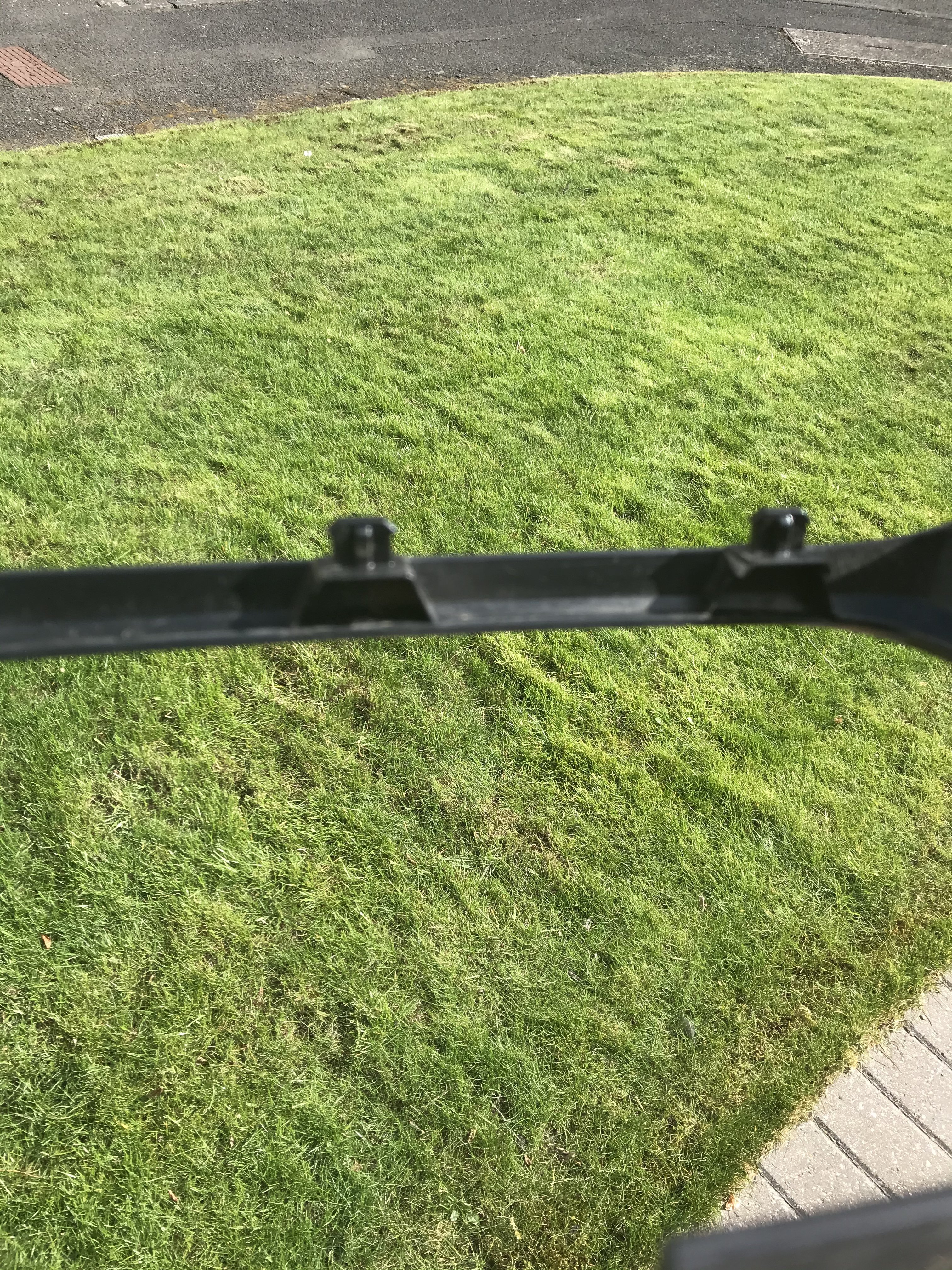

Right this was bugging the shite out of me So I pulled the cover off CERBERUS and decided to remove this cover Piece of piss Two Allen bolts underneath Then it just pulls off towards the front wheel....easy it is held in place by two push lugs here One in the centre and one on the R/H side of the bike it doesn’t have one on the left the two push lugs and this on the left Can’t see that it does anything except maybe a lining up guide hope this helps mate Gonna put it back on and put the cover back on CERBERUS I suspect that when it was at the dealer it was put on a ramp and it got snagged when it was wheeled off Take the two bolts off and re-align the cover Probably just the centre one been popped out you owe me a drink
