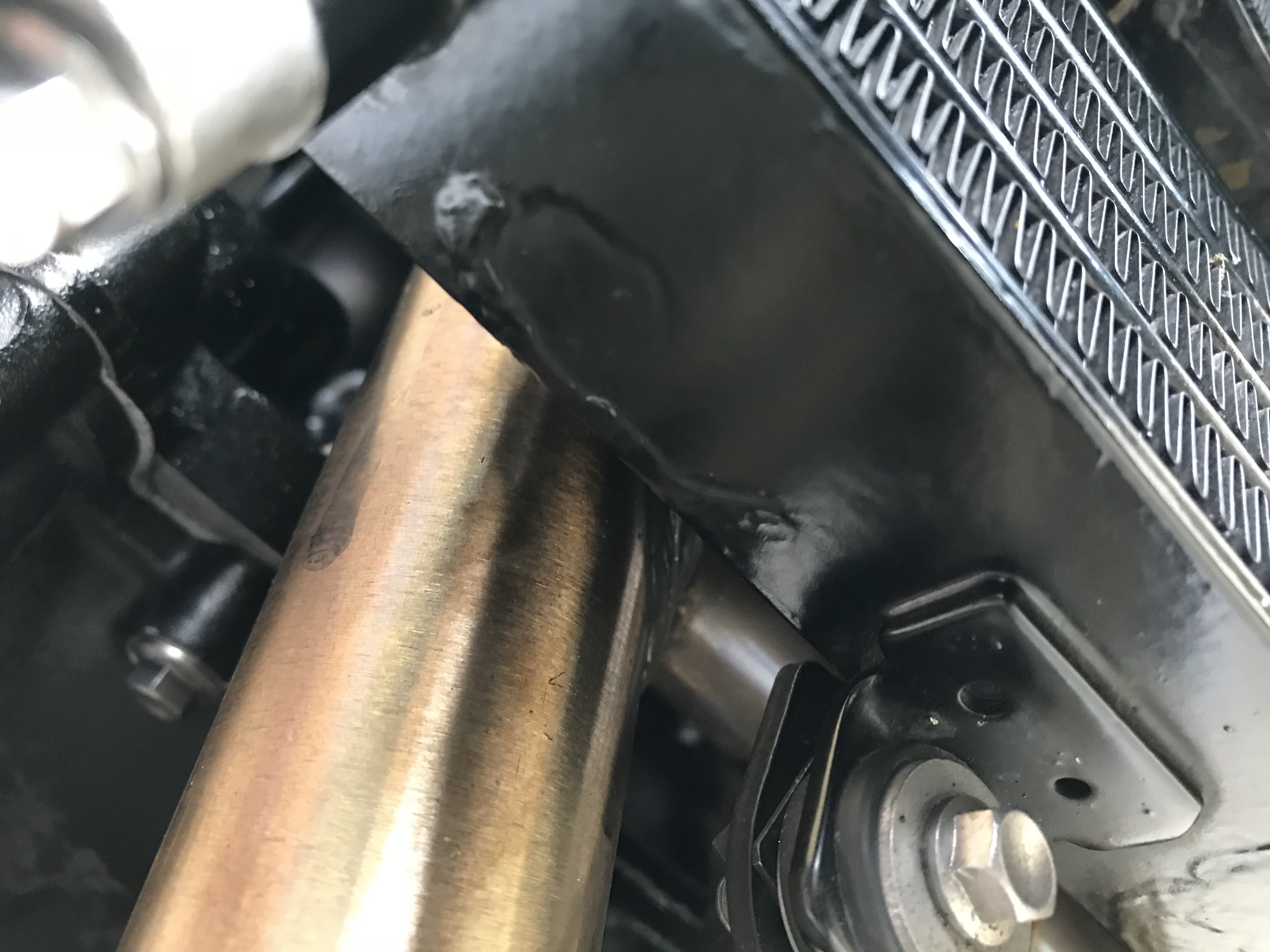

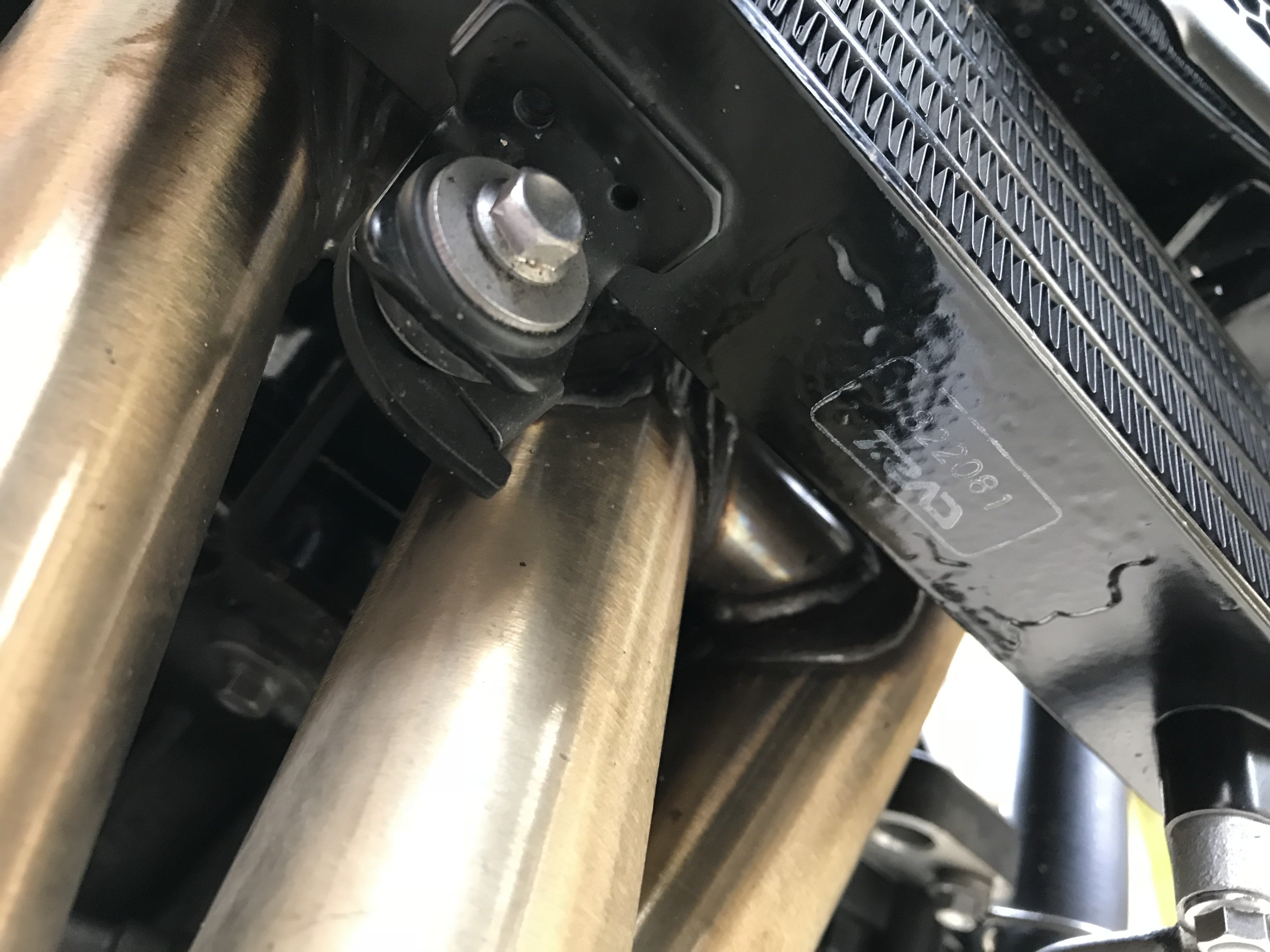

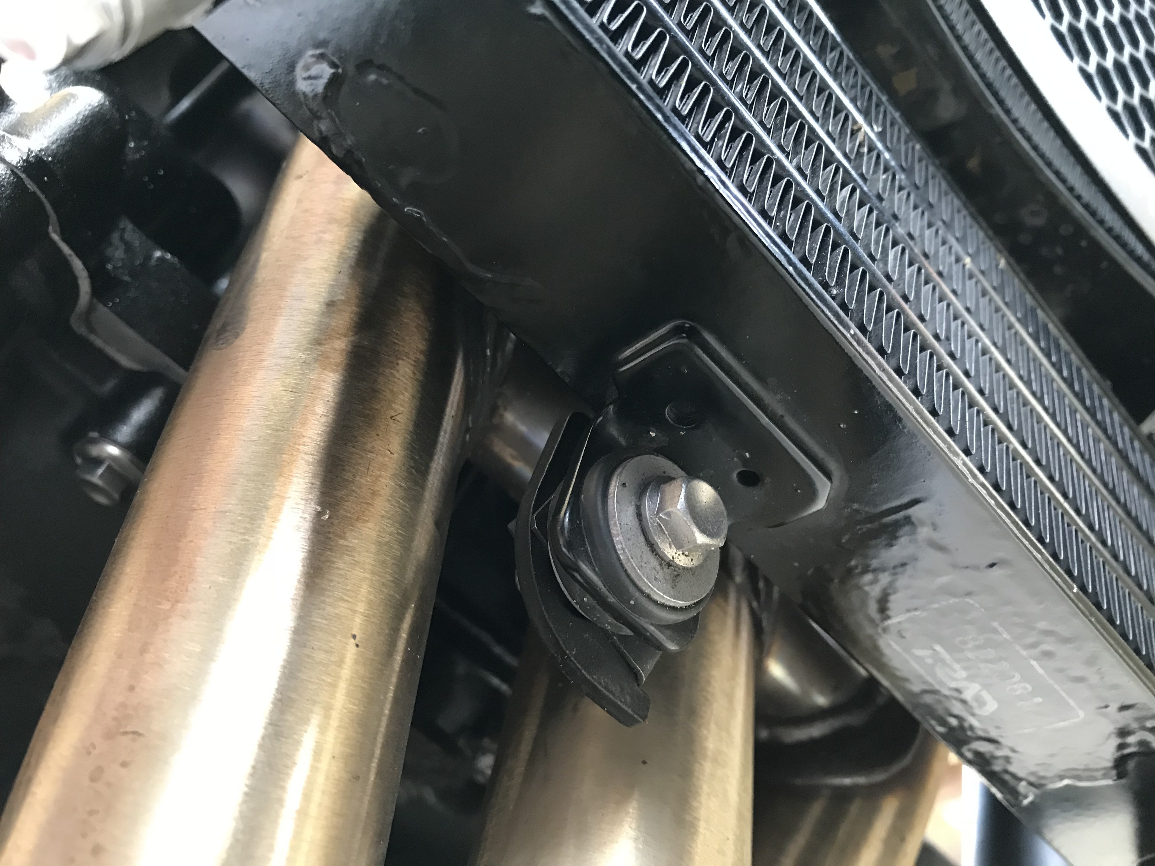

    5902374F-61DC-486D-BEC6-697537D2232B.jpeg C2450E2D-6B6C-49D4-95DB-396A9129B917.jpeg CF1EC179-0E88-426D-AEBE-90C7ED1974F2.jpeg Notice this on underneath of oil cooler today.
    800 mile Speed Triple RS, new a few months ago.
    Is it just been painted over where paints flaked off ?

    Welcome to the forum! Since you can read the decals, it might be a bad 'clear coat' over the paint. It looks like the coat was too heavy and that the piece was turned vertically, allowing it to run. But it may also have been caused by some type of solvent that softened the paint and clear coat, if you used something to clean off bugs and dirt at that location. It would be good to add a little information to your introduction and maybe post a picture of the whole bike. ;)

    Looks like powder coat put on too heavy and sagged when baked to me.

    To me that looks like aluminium corrosion under the paint. Providing you have no stone chips which would allow water in you should be good under warranty.

    Only my opinion but it does look like corrosion under the paint,viewing on a phone so maybe get better view on laptop not acceptable anyhoo.

    It’s both possibly a run in the coating and where the decal is that’s corrosion painted over. It’s possibly bare metal stored damp then just picked up off the production line, not prepped and just blasted in paint. Stick a sharp knife blade in and see if it flakes.
    For corrosion to get that big it could take 18 months from the start if left bare at the quickest if the alloy is cheap and porous which would be out of your hands anyway and the component manufacturers would be responsible.

    [QUOTE="Michael Greenhaf,it looks like weld and as its out of view I would leave it as long as rust does not break through
