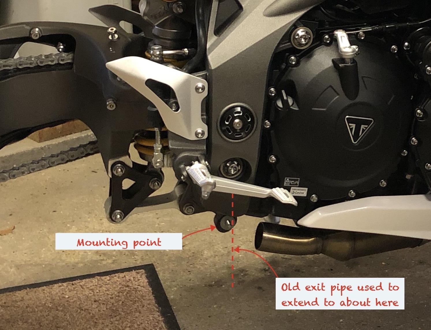

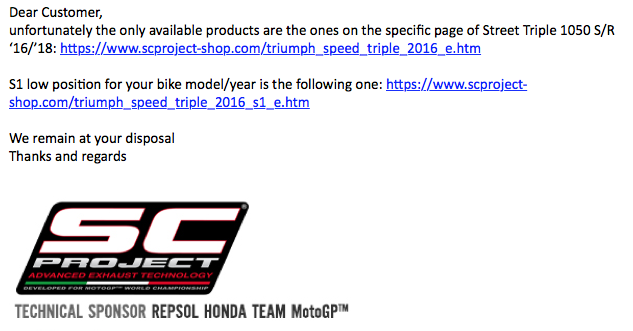

    The link pipe and catalytic converter exit pipe are different on the 2018, so I emailed SC, asking whether they had plans. I got this garbled reply:
    I'm no expert, but the main change appears to be that the exit pipe from the catalytic converter used to be attached to the lower mounting point on the frame. For 2018, they've chopped the exit pipe short, and the longer link pipe now attaches to the mounting point instead (if you see what I mean).

    I admit that I wasn't specific - I'm referring to the low systems...where the link pipe is replaced.

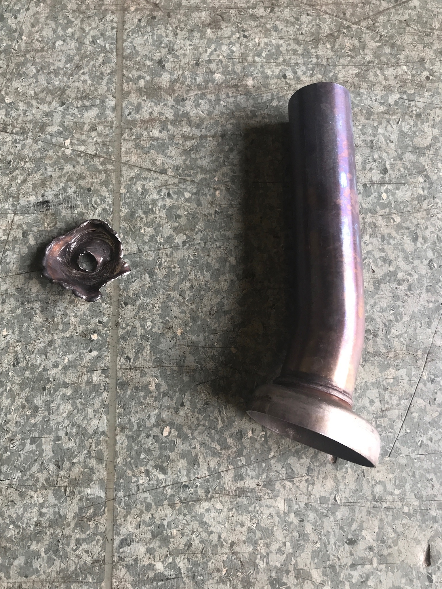

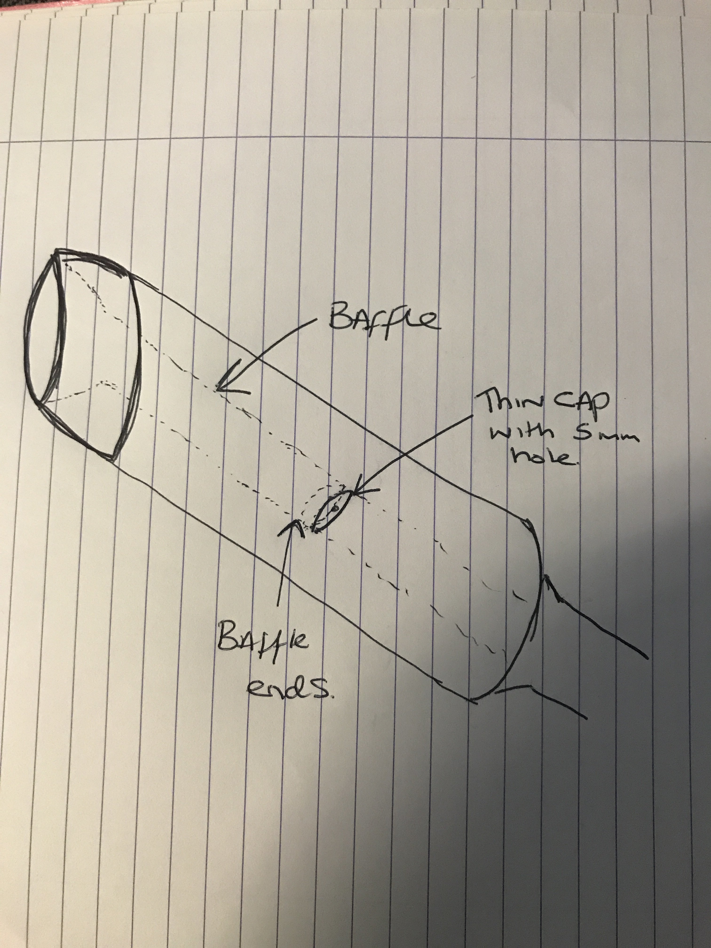

    I’m not sure if this is much help, however my bike went to a specialist race bike builder for the work with the cans, the internal part of the baffle is not welded to the can, it purely sits in there as one long solid tube, it is held on by a 1-2 mm weld on the end of the can.
    As for looking at the internal part of the exhaust you do not see that mesh, it stands out in those pics because it was fresh metal without any blacking from the fumes etc.
    In regards to the small disk at the inner most part of the can this was spot welded in place and had a small 5 mm hole in the centre of it.
    Since removing the baffles the sound of the bike is unbelievable, so much deeper but as it moves up the Rev range it doesn’t lose that raspy note that is so distinctive to the new Rs.
    The cans Do run a lot cooler now compared to before and the bike appears to just breathe better, I honestly think with the baffles removed and the suspension set up bespoke to yourself the bike is in a league of its on.
    I can’t recommend enough getting the ohlins set up the bike handles so much sharper.

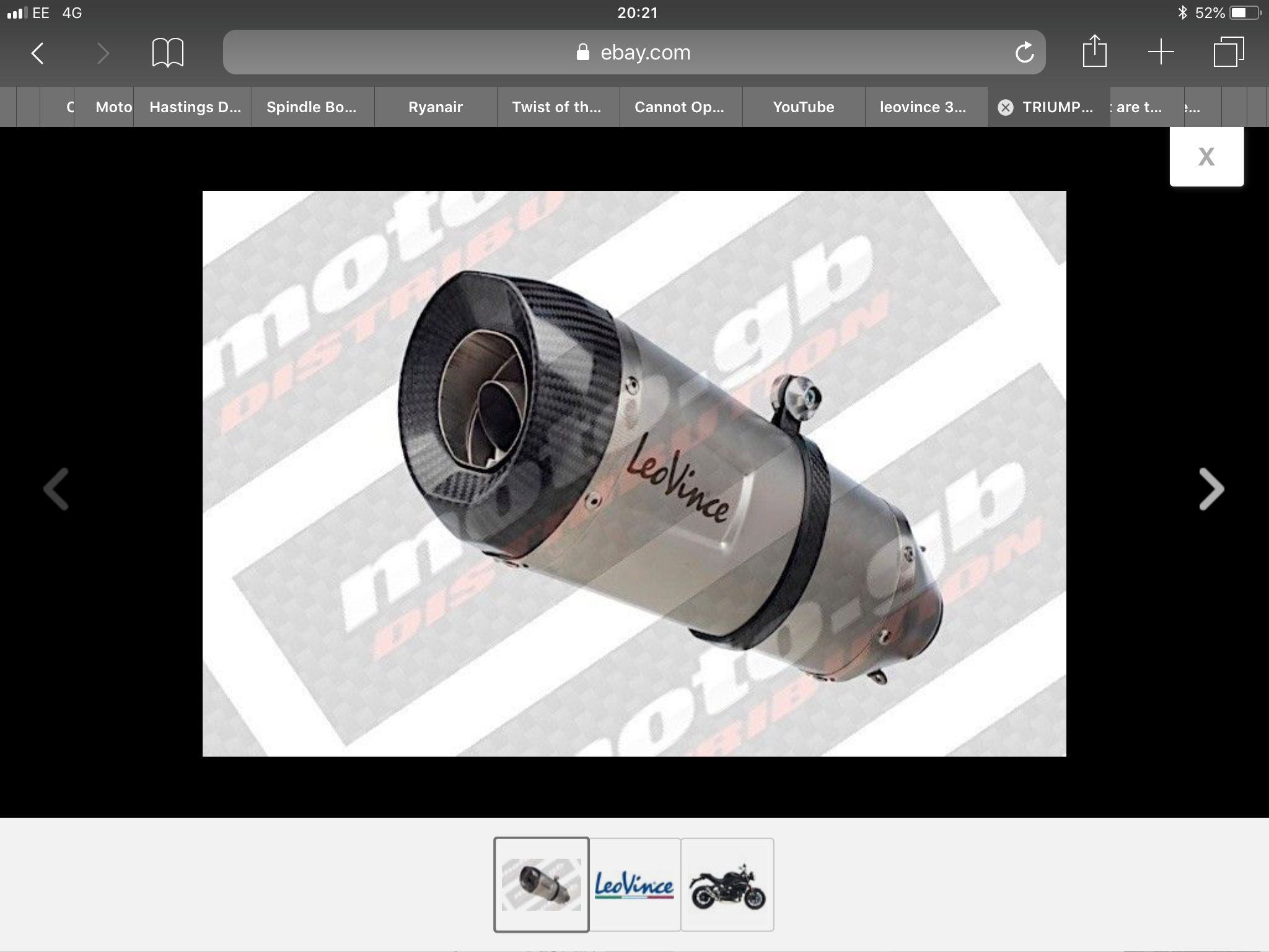

    On a side note please find below a pic of the baffle and the small disk that was removed inside the cans.

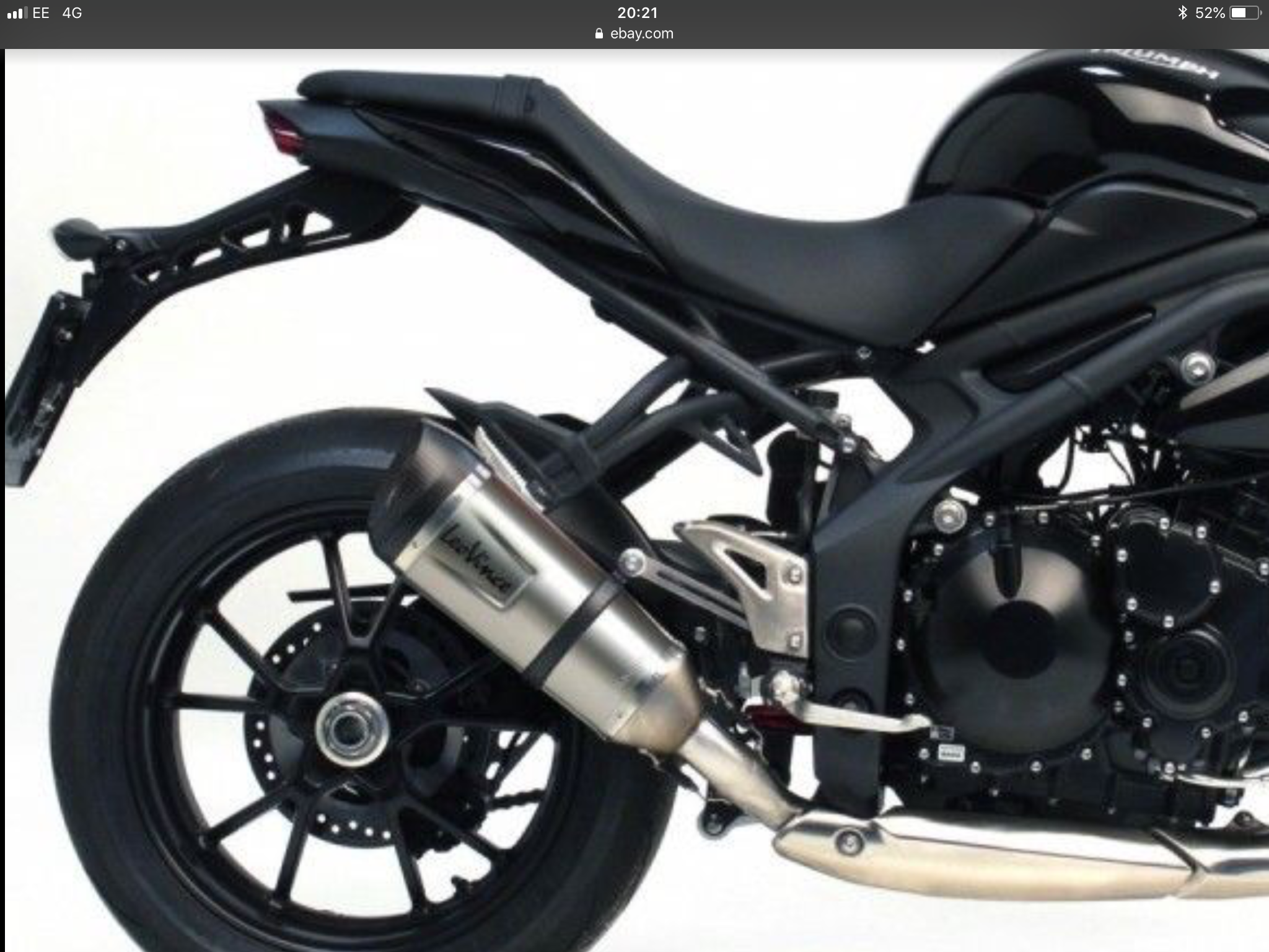

    Also a little lowboy option by Vance and Hines
  15. Woodywoody 84
    Woodywoody 84 New Member
    May 7, 2018
    London
    Sorry I meant Leo vince exhaust not Vance and Hines

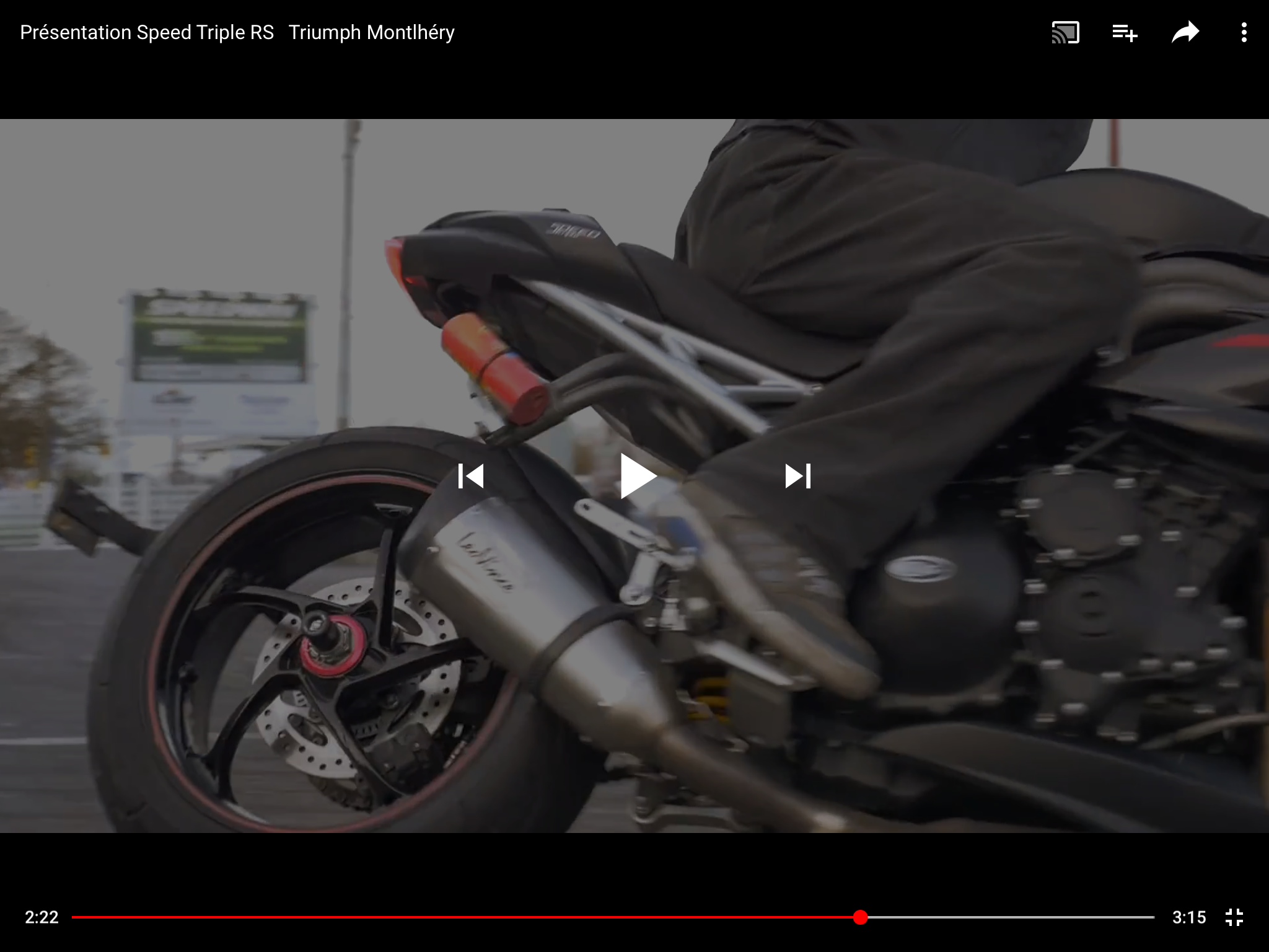

    This is it on the rs I spotted on a you tube video....

    That’s amazingly helpful - thanks for all the extra info. Just one question...I understand the 1-2mm weld that has to be cut, filed or ground away, but I’m not clear about the inner end of the baffle. I presume you mean that the disc (with the small hole) is spot welded to the baffle tube (and not spot welded to the main can in any way) - so why does it need to be separated (in a hacking kind of way) from the baffle? Why would the whole baffle not slide out (albeit with plenty of encouragement) once the main weld is removed?
    I’d like to fit a small bolt so they can be re-inserted if necessary, so any extra info is much appreciated.

    My question as well, I can understand the carbon cap end and it needing cutting / grinding etc. I'm not sure exactly where the other bits attached to? I might be missing something on a posting? As for making them to refit I would be doing that but it's simply a small self tapper easy enough. Hope you guys don't mind the daft question but I just want to know what I'm getting into before I start the job

    Hi, sorry if I’m not being clear guys, I’ve drawn a very crude pic, the baffle will just pull out, and to be fair you probably could stop there, however the end of the inner baffle sits up flush against this metal disk which is spot welded to the inside of the can. To remove it we simple placed a large long metal chisel down the inside from the carbon end and knocked it out.
    But like I say you wouldn’t actually need to remove that. And it would open the can up plenty!!! However mine now has a huge hole all the way to the cat!! And you do not need to remove the cat because you will not gain any more noise. If you did desire to remove that for power reasons, it would probably require a hilltop remap and you have to be careful about fitting a custom link pipe because it could effect the warranty from triumph when you remove the cat.

    It does not damage the can in any way knocking that spot welded disk from the inside of the can.
