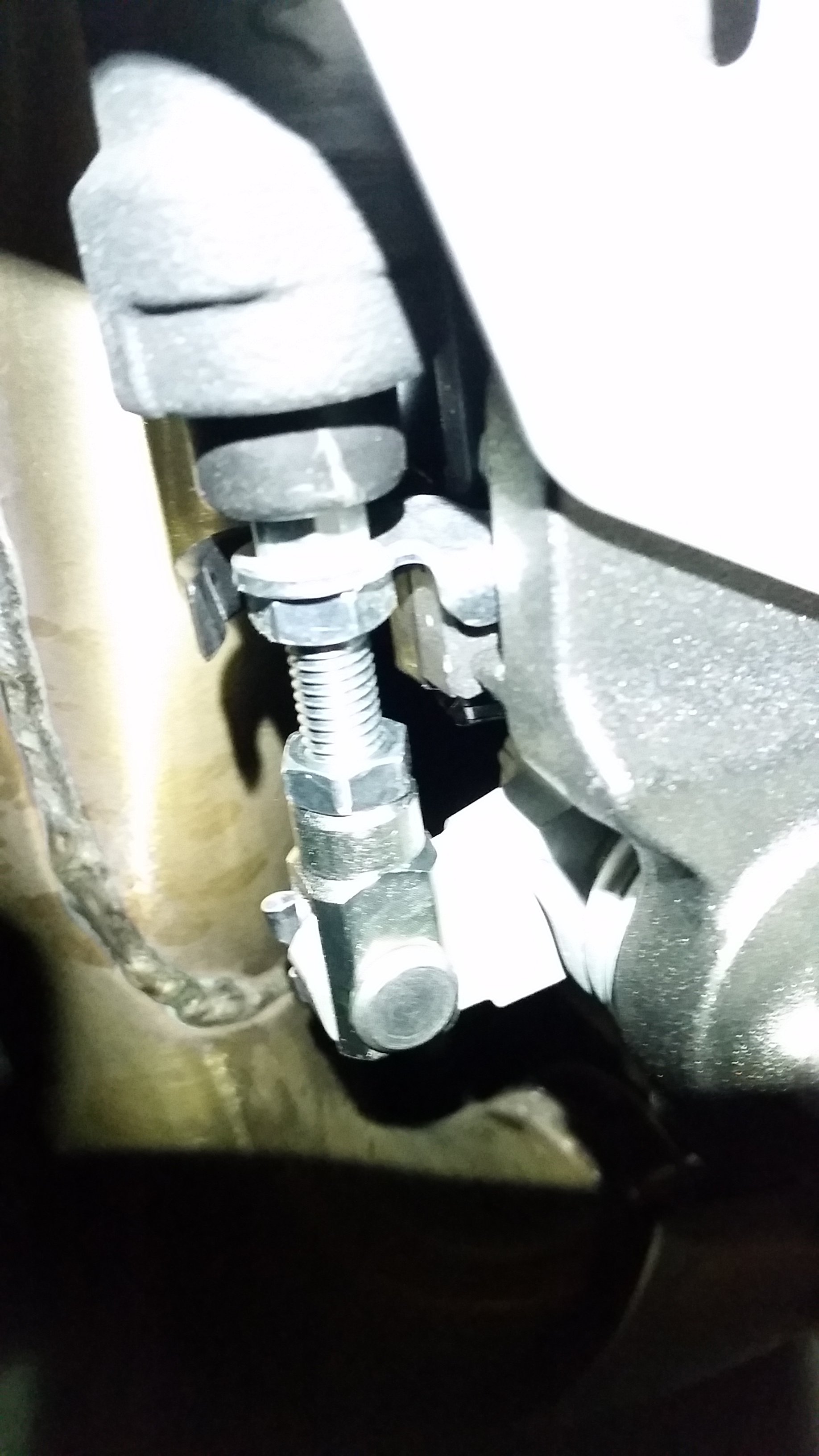

    Well, the attached picture shows what I'm looking at. The disposition is nothing like the one on the video, the locknut is 12mm and there is a small plastic cover that prevents me from getting the wrench in place.
    Any ideas?

    This is the not you have to loosen

    I did loosen that nut, but I can't move the rod without getting to the nut on top. If I understand correctly, after loosening the lower nut, I need to turn the upper nut in order to shift the rod up or down, correct?

    Alternatively you can push the pin out from the clevis (there's a clip on the back) and turn the clevis half a turn at a time, that might be easier.
