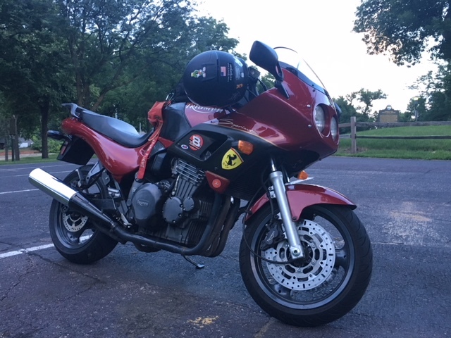

    Been experiencing a very unusual headlight flicker on my 1996 Sprint, 40K miles. South Dakota, USA.
    Been a great bike and have had it since new, but last year put in new head light bulbs and now a year later at night I am noticing an intermittent flicker that is not a consistent pattern, or due to bumps and jars in the roadways, or engine RPM changes so I am not sure where to begin to trouble shoot the problem. At idle in garage and varying revs the lights are normal, I can't get it to do it on the stand only riding conditions.
    It's a bit annoying but does not stop me from hitting it hard every chance I get.
    Looking for advise on a possible path of investigation...I hate electrical.
