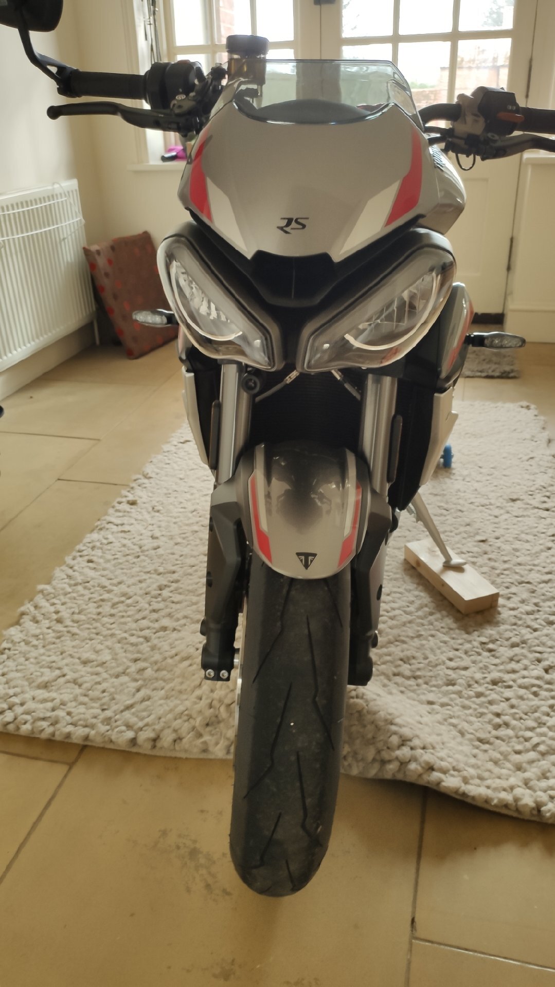

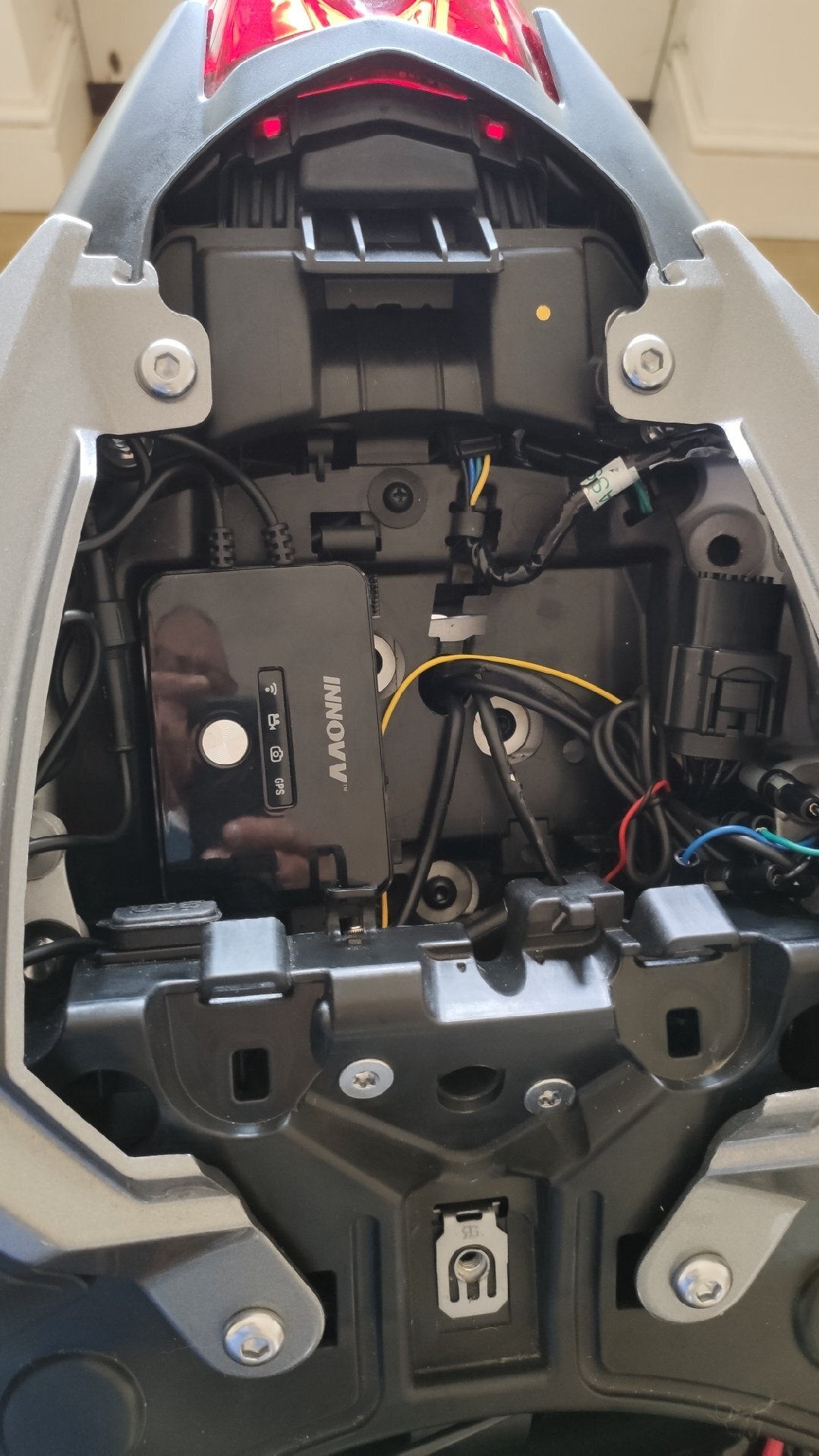

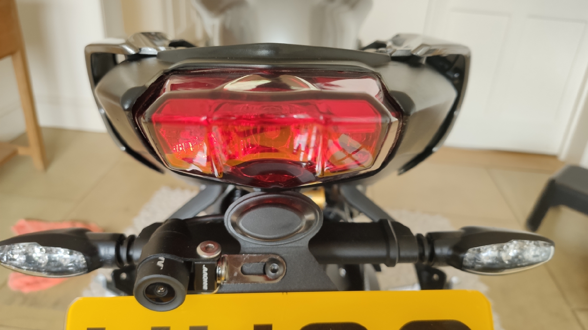

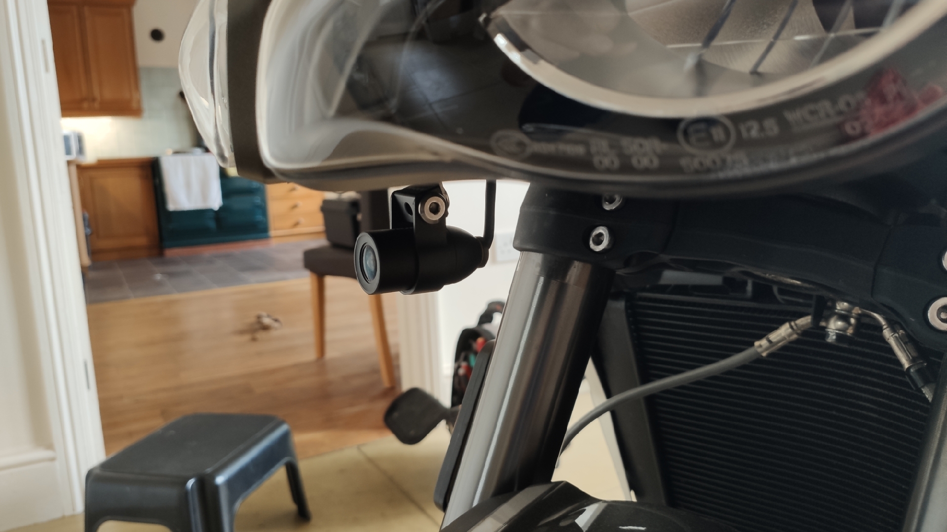

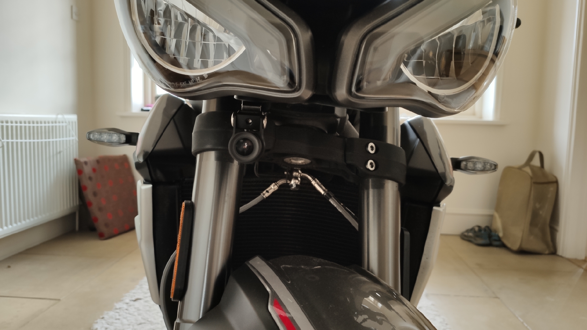

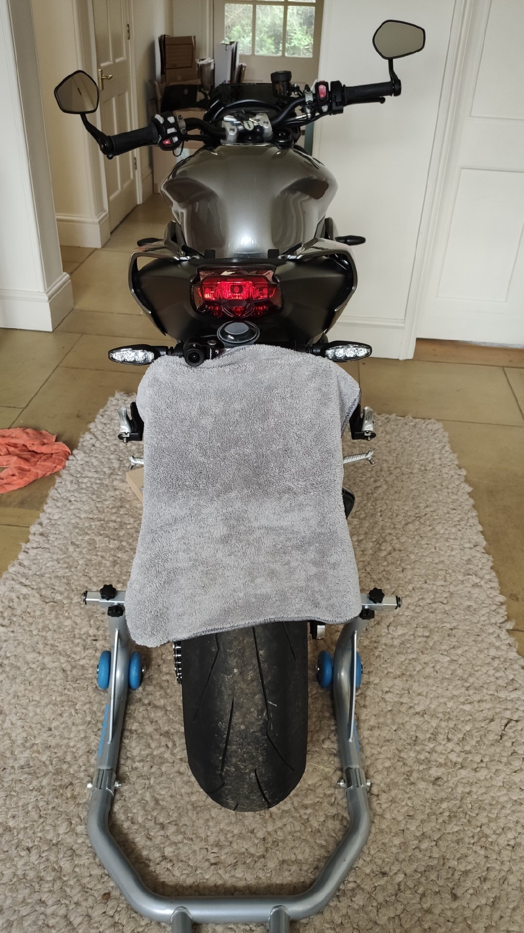

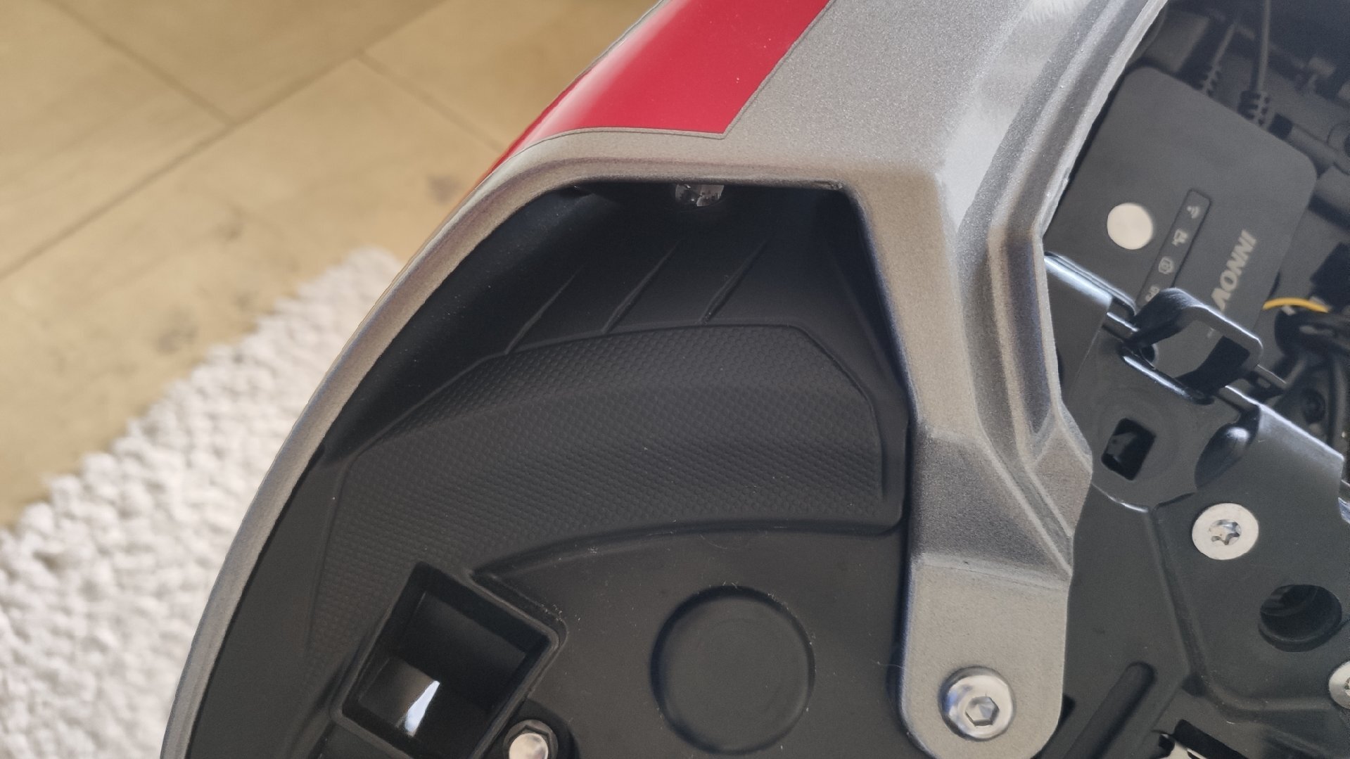

    Hi all, thought one or two might be interested in my dash cam install on my 2020 Street Triple.Hope someone finds it useful. Pics only I'm affraid Video is a step too far for me. J

    Very neat. Cost? Easy to fit? I’ve no experience of these things. How do you download the footage?

    Install is fairly straightforawrd, but long winded if you want the neatest of results.The wiring loom is complete,you need to make a splice into a switch live, I used the rear light loom.I would recommend laying it all out on the floor connect everything and power up using a phone charger or battery, there is a dedicated port for this purpose, connect the app and make sure you're happy with it all before installing

    Very neat installation. Bike looks great!
