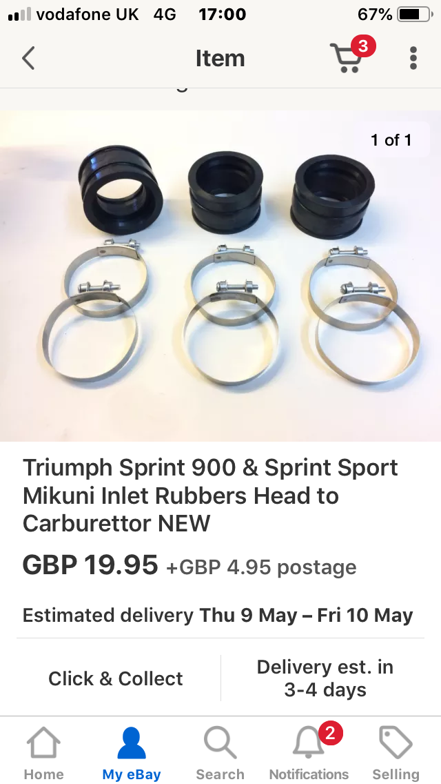

    Hi, a question for those knowledgeable in carburettors.
    My sport has Kehin carburettors and the only new inlet rubbers I can see are for Mikunis. Are the two types identical bar for the name? I’m needing the rubbers between the head and the carbs, so would like to know before I take things apart. Cheers!

    www.triumphparts.gbr.cc have them listed £6.95 each for Keihin carbs. Mikuni are £5.95.
    To be found in the 'Fuel, oil filters, air filters' section.
    Hope this helps.

    Cheers. Just ordered three. Thanks for the link and where to find them
