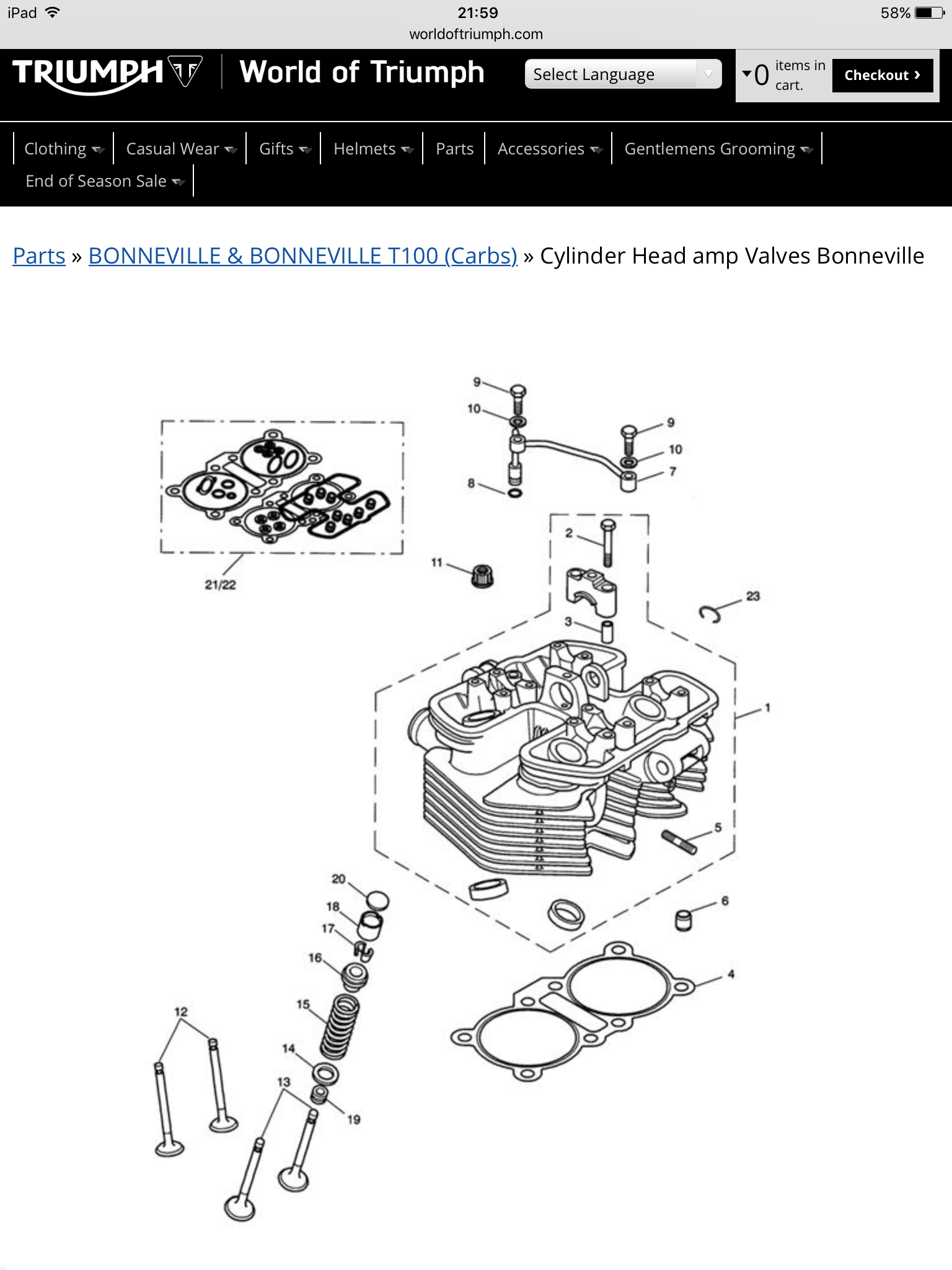

    IMG_0810.PNG Had a look over the weekend at the clearances and three are out, one inlet and two exhaust all on the same cylinder hay ho.
    It was worth a punt so I will put it in to the dealer and get them done.
    HOWEVER when I was picking up a new gasket in the dealership one of the tech guys came out and started chatting.
    I told him I was going to have a look at the clearances and try and save myself the £560 service bill.
    He said whilst I was in there I should replace the o ring on the banjo bolt that holds the oil feed pipe on......
    The original o rings had a habit of starving the head of oil so they have a modded one which costs about £2 and takes nano seconds to fit whilst in there replace the two washers as well.
    Part No's 8 & 10 on the diagram.
    So overall it's a bloody easy job to check them but if nothing else it's worth doing it just to replace the o ring.
