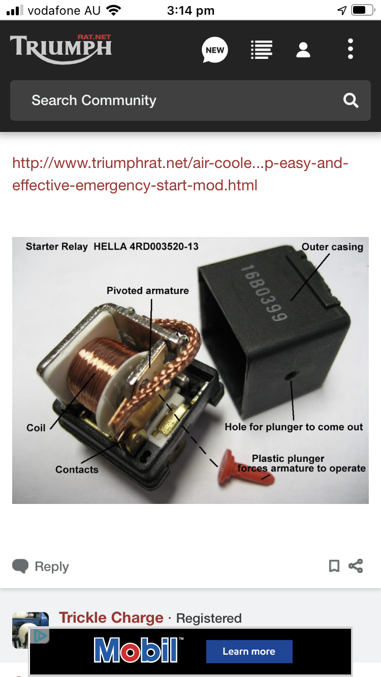

    I bypassed this battery volt drop problem ,now the bike can sit for weeks and still starts with out the tricle charger ,I had a auto electricton do this when I had a short in the clutch switch I couldn't find

    you can do this and you can start the bike
