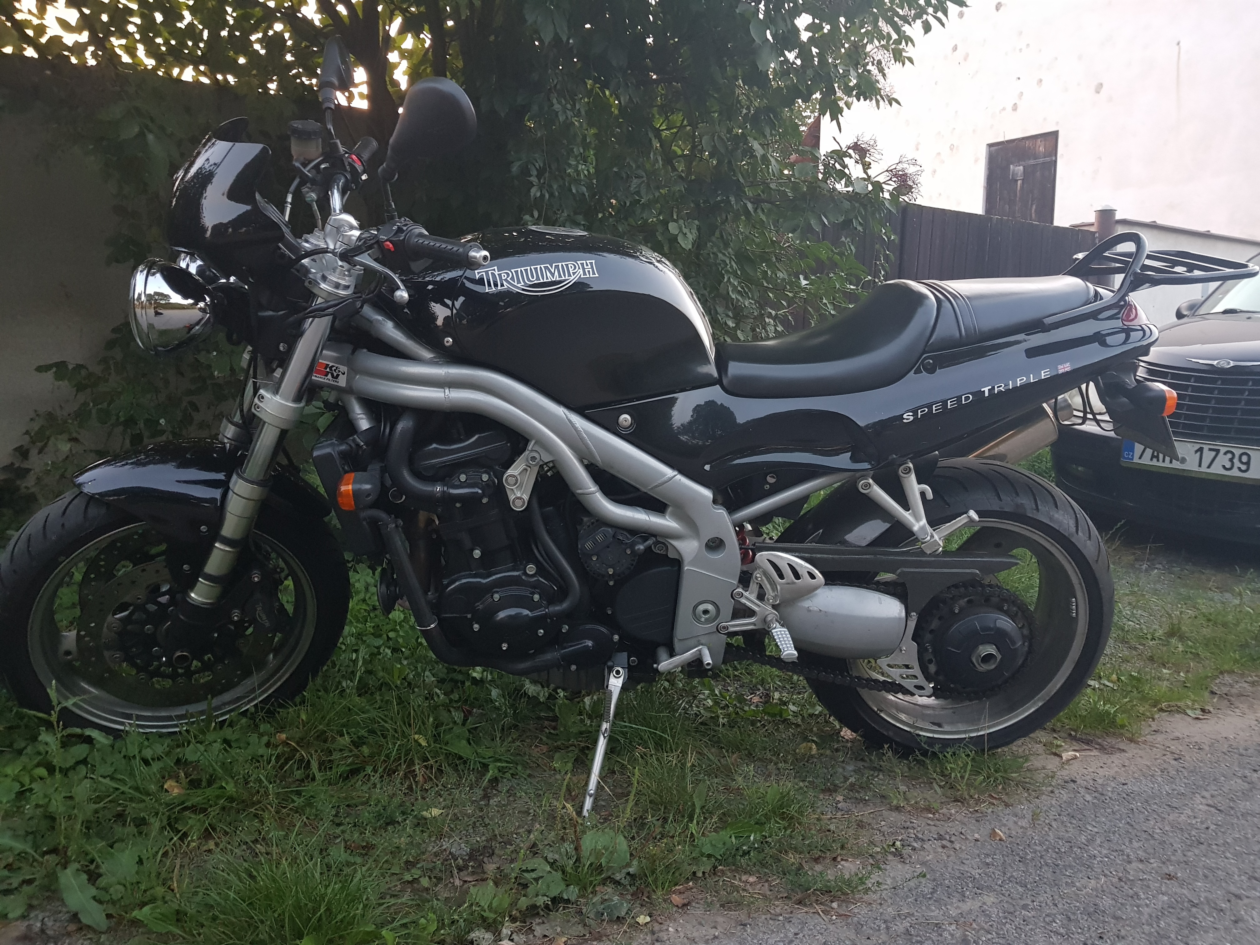

Hi all, A Brit living in the Czech Rep. Stopped riding when I moved some 15+ years ago and just got my first bike here. The roads are a nightmare and potholes are more like the Mariana Trench. Just got myself an old 2001 955 Speed Triple. She needs some engine work, but I look forward to putting her on the road properly next year. This being said, I will be looking to you all for help and advice at various points. I'm not a mechanic, but have a logical mind and a fairly good working knowledge of engines. As I build my workshop, so shall I improve my collection of motorcycles. For now, I'm happy just to have two wheels back in my garage. Better pictures and discussion to come, thanks in advance and take it easy on me if I do ask something stupid. Ride safe, Dave 'Mad-Dawg' Munns

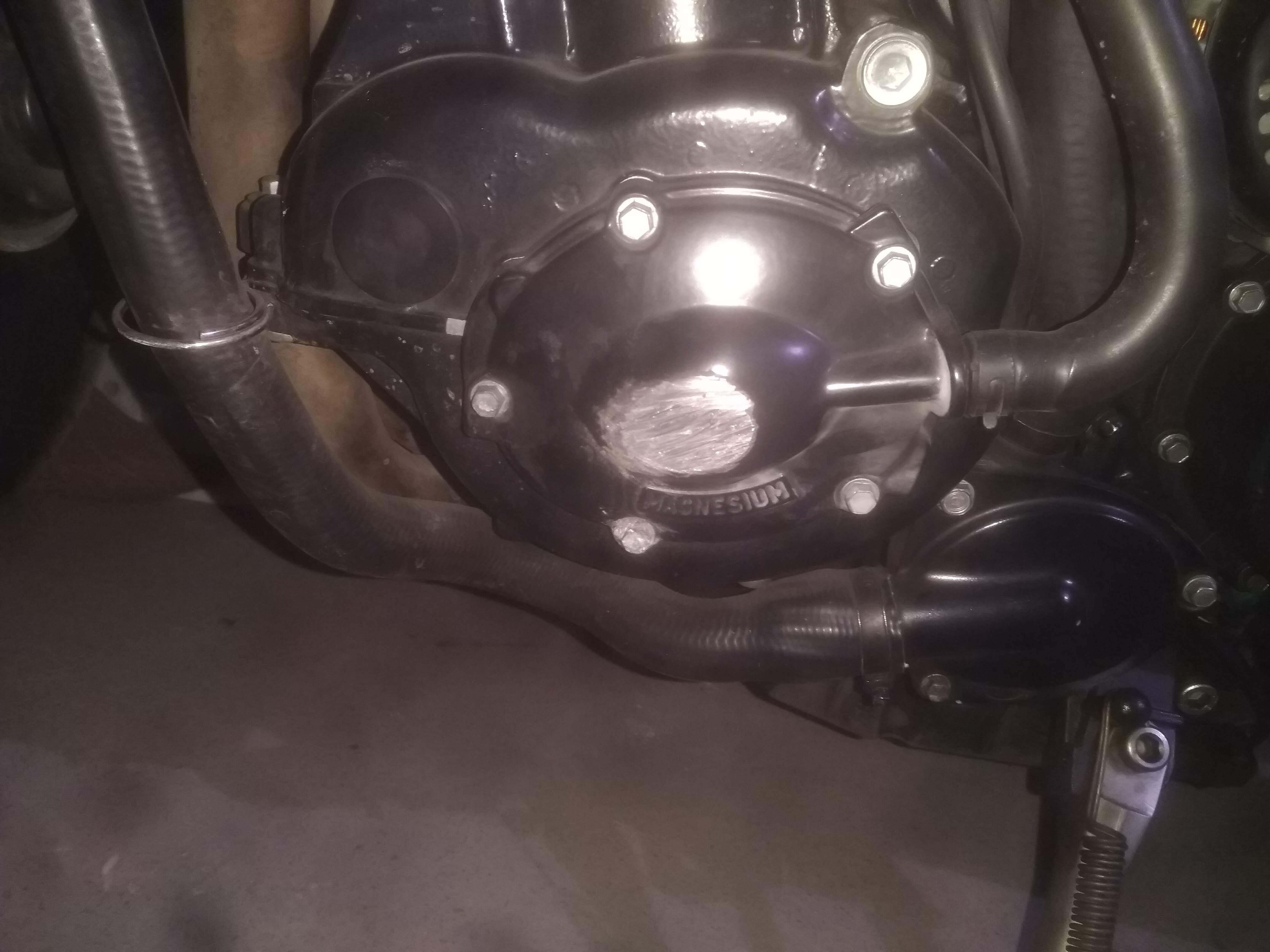

hahahaha, thanks, I guess they get worse each year all over the place Oh, these engine issues are there, it's not just the usual noise. Cold start is fine, but once it warms up (5 minutes) there's a definite tapping, then once warm it stalls when I pull up to junctions or when idling. it did just a few km's last year sitting for most of it and was dropped at slow speed on the left hand side scuffing the casing. I have a fair bit to do before she's road worthy for next season.
reset the Throttle Position Sensor in Tune ECU if you can - and check you have the right tune on the ECU... also visually check the condition of the hoses to the throttle bodies from the stepper motor air idle assembly... check shims and throttle body balancing ... sounds like one of those lets work through the possibilities problems.... just remember - as long as it starts and runs it's not a basket case
