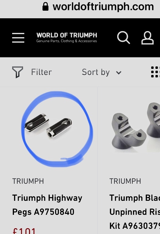

    I have checked World of Triumph and pegs and highway bars (sit in front of pipes mounted to forward peg bar) are available but not the peg attachments. (partsA9750850) Hopefully you can source in US :cool:
