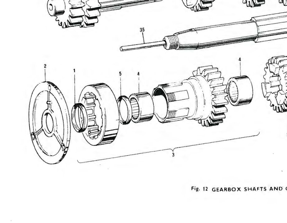

    Sorry my bad. You mean these numbered 4

    I can't say I remember doing one. Sorry. But from the looks of the drift, and the description "they both press out together", from any one end will do it.
