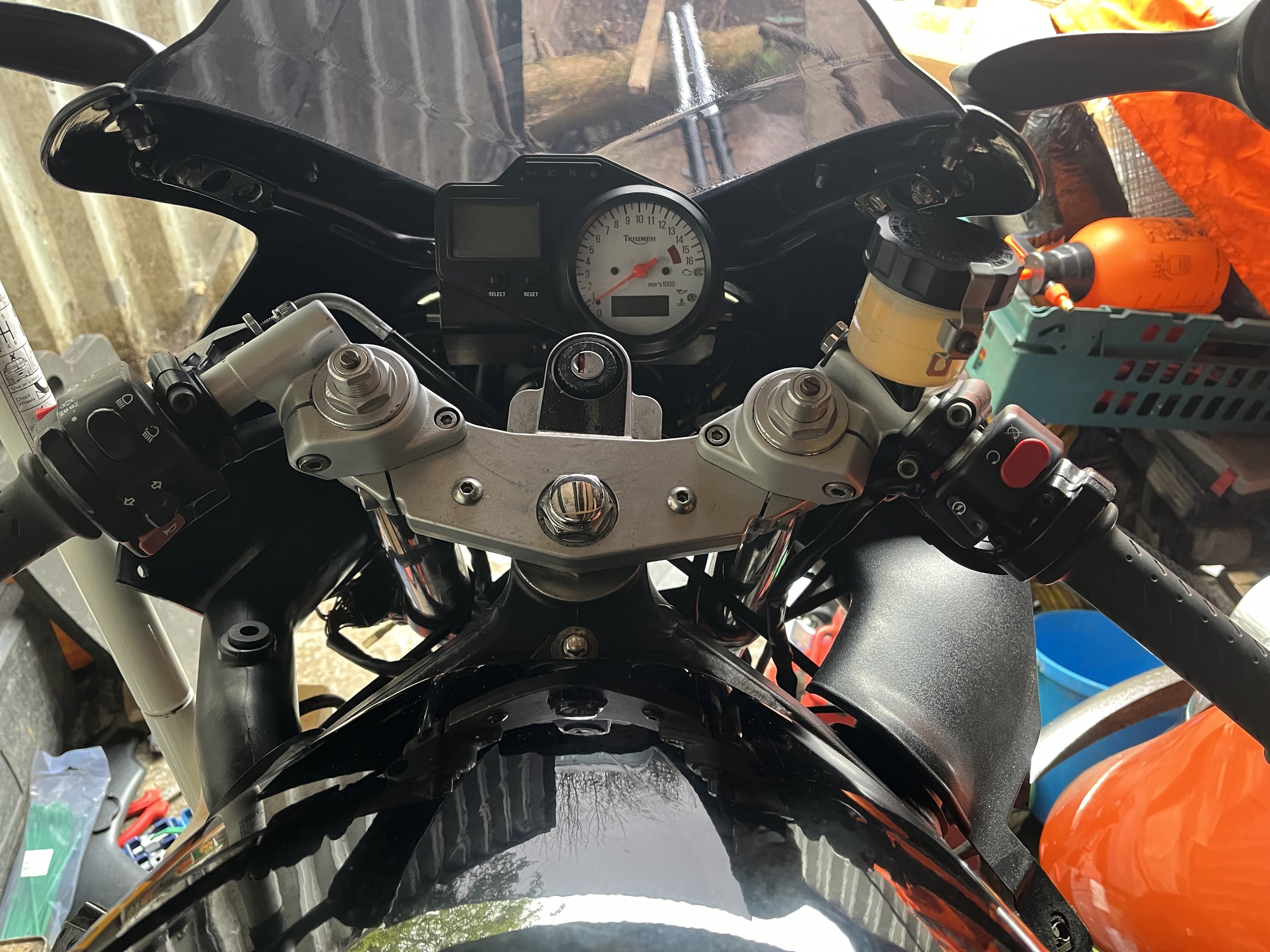

    So i bought a tt600 and have been ripped off, something is twisted at the front end, i thought the forks were bent so put in a new set and its still the same, with the front wheel running dead straight the handlebars point of to the right (see pic) so could the yokes be bent, or the frame twisted, or has it been apart and not put together correctly. Thanks in advance.

    Not necessarily something bent. The forks can get twisted in the yokes. Loosen the bottom yoke pinch bolts, stand around the front of the bike with the front wheel between your legs. Now get hold of the handlebars and give them a few sharp tugs in the direction to straighten them up. Tighten up the pinch bolts and see how it is.
