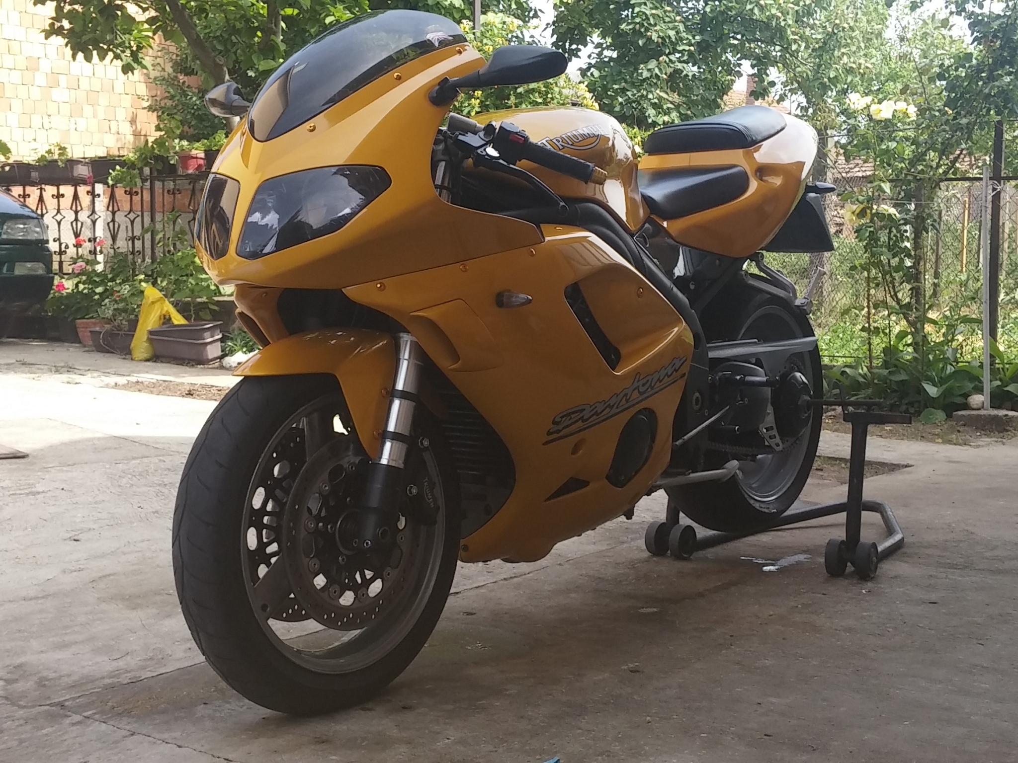

    This is my baby :grinning: :heart:

    It's a real cracker. Don't you just love the sound of those engines.

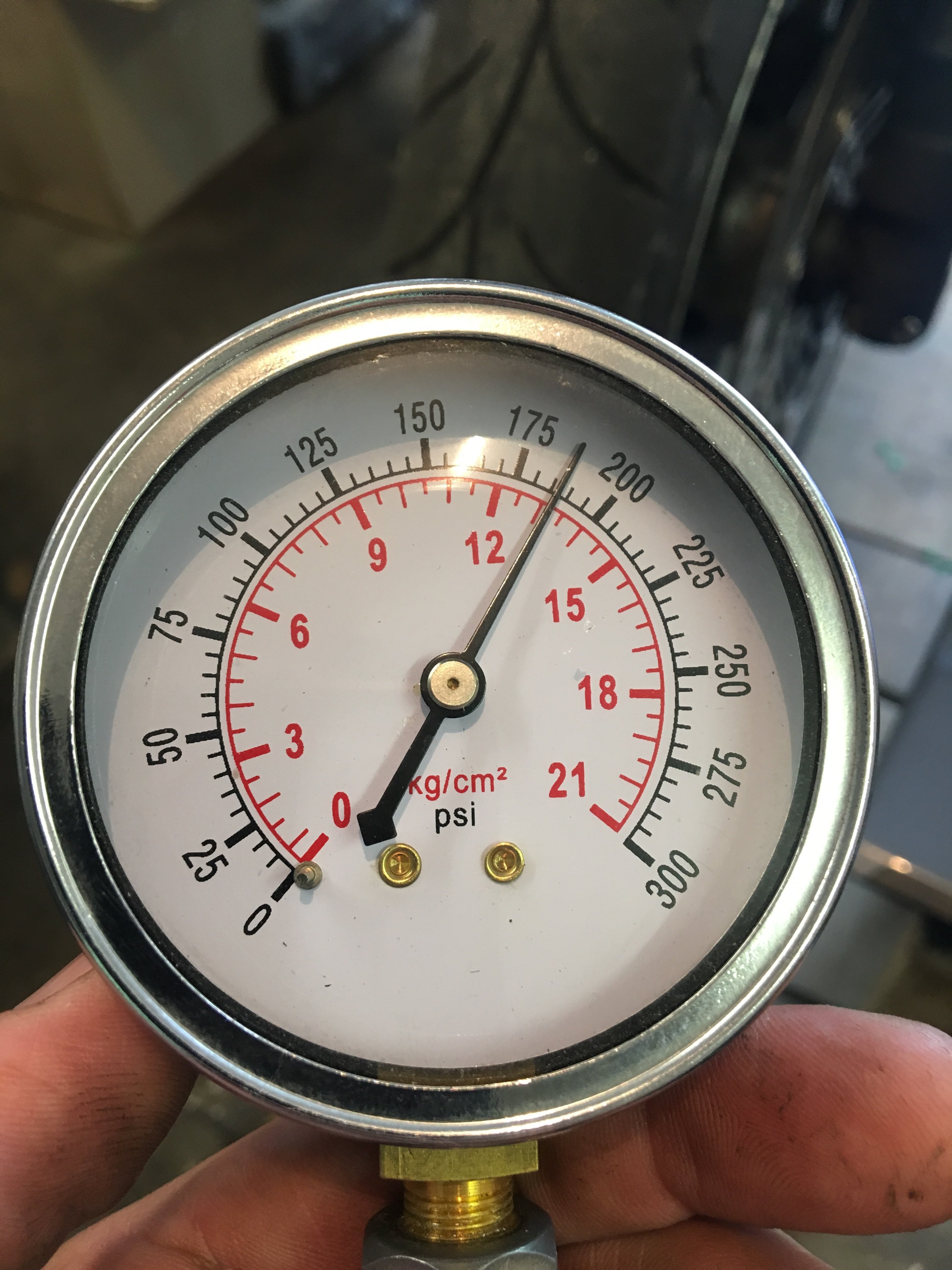

    Compression checked
    I check compression

    Looks good to me where all cylinders within 10% of each other?

    Yes all 3 cylinder have such compression.
