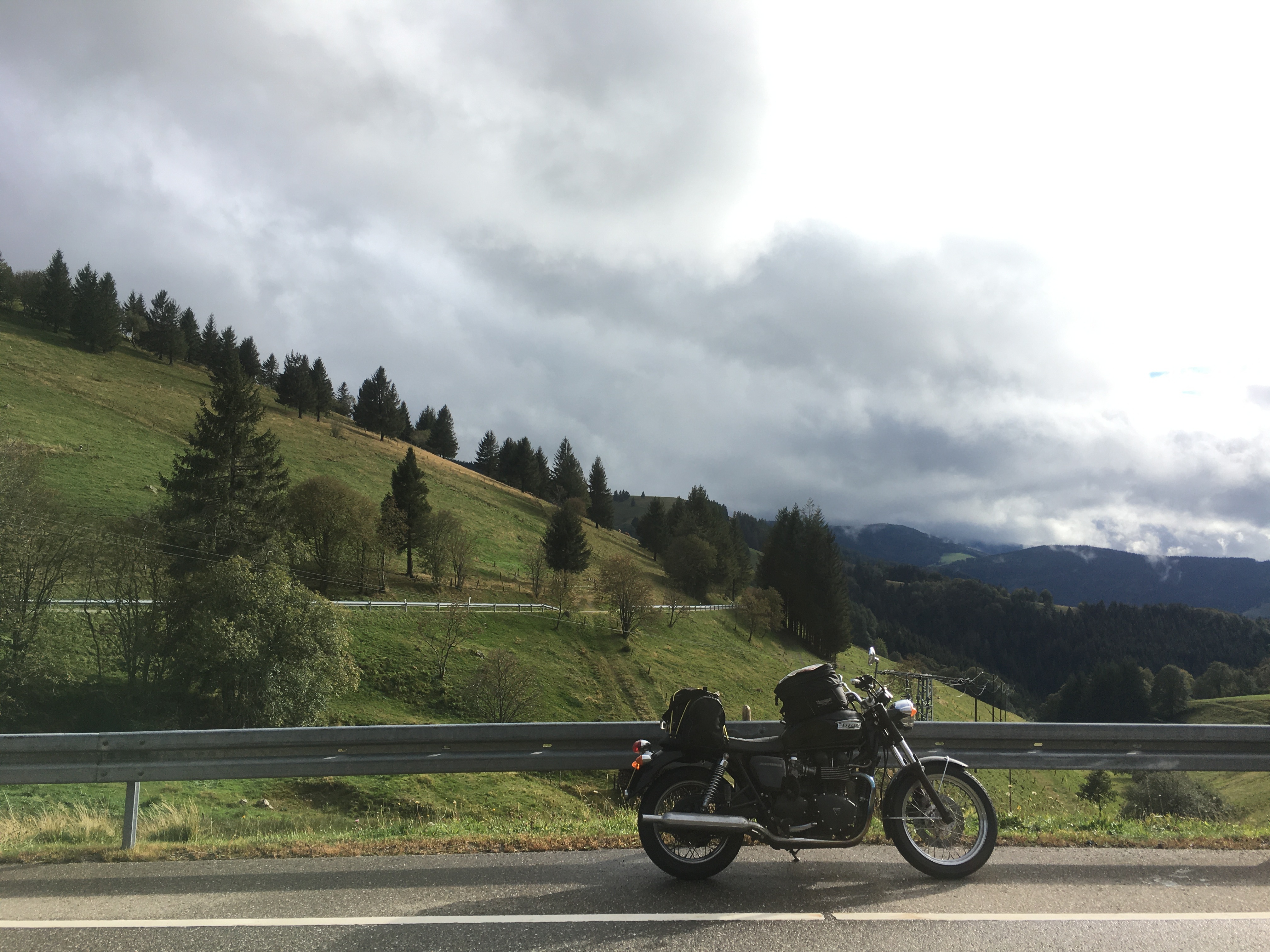

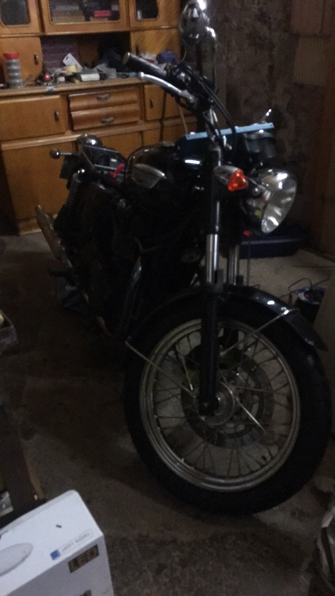

  16. Rolandrat81
    Rolandrat81 New Member
    Feb 7, 2021
    15
    Germany
    Here’s some (pretty poor) pics :)
  17. Sandi T
    23,700
    Greetings and welcome to the forum, Rolandrat! Hope you figure out your Bonnie's woes quickly and completely. Thanks for sharing the photos. I especially like the last one. Enjoy the forum!
