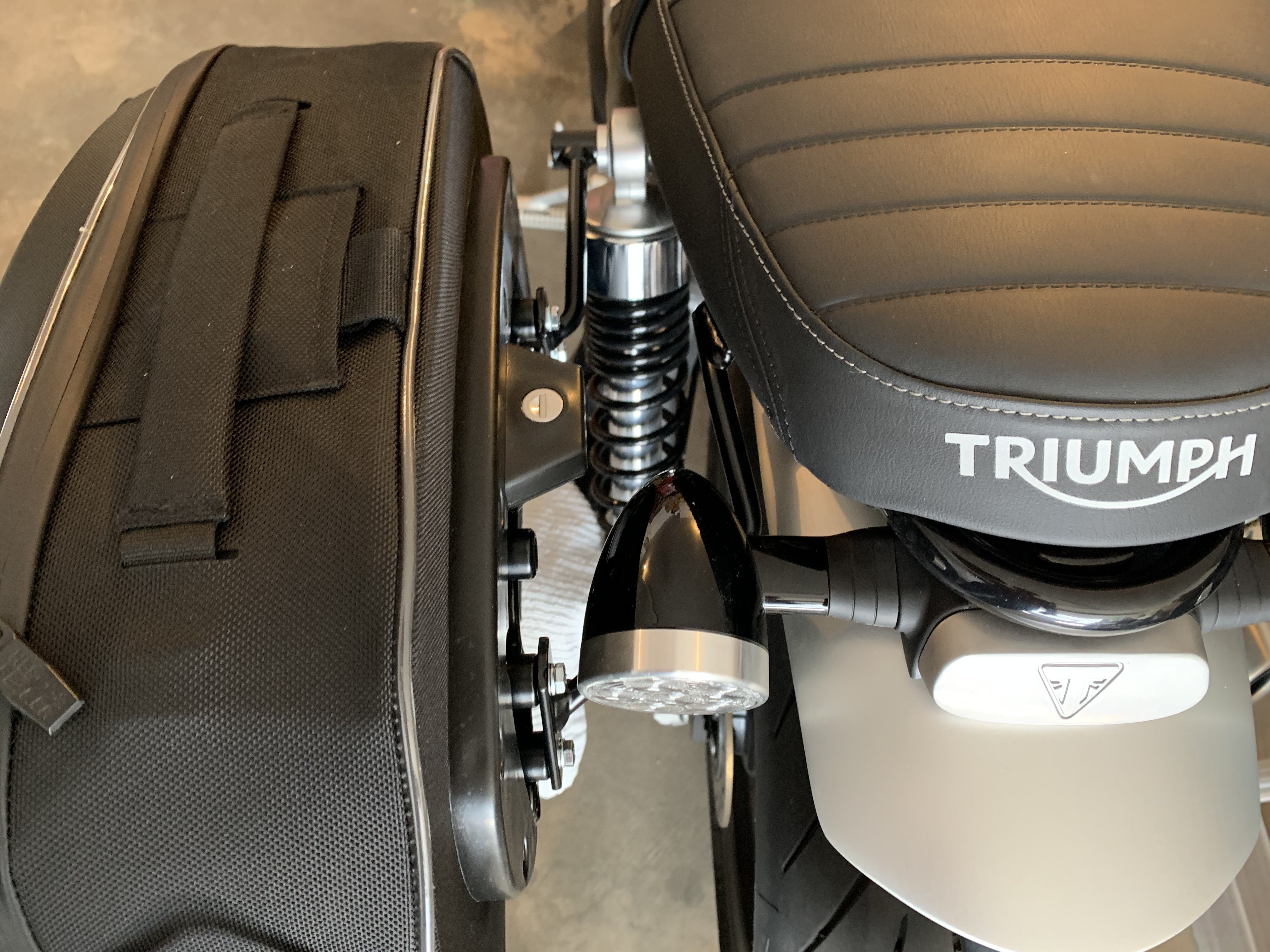

    Today I installed the H&Bs. The Street bags use the hideously ugly C-Bow mounting system. I’ll get over it though, because it seems to be a VERY solid mounting setup.
    Installation was super easy with 5,6,&8mm allen sockets, and the ever present 10mm wrench. I also used blue LockTite on the new shock mounting bolts.

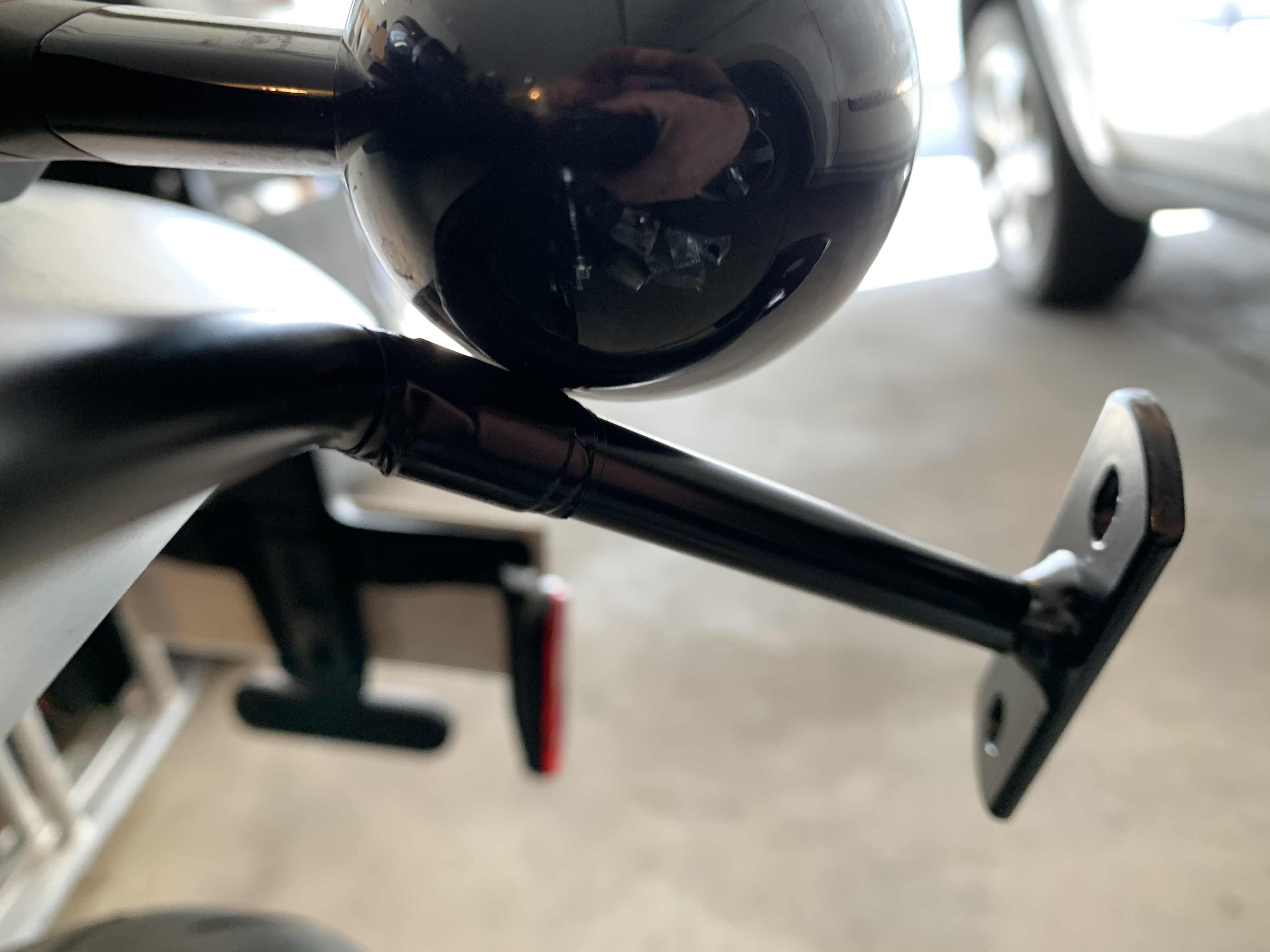

    One word of warning, the US spec Speed Twin has bigger tail lights than the European version, and the rear mounting brackets come in to contact with them. Luckily, there is very little pressure here, so I simply wrapped the bracket with a little bit of black electrical tape in hopes of preventing scratching the bottom of the light. After everything was tightened, they are still in contact, but I think it Isn’t really a problem (see pics).
