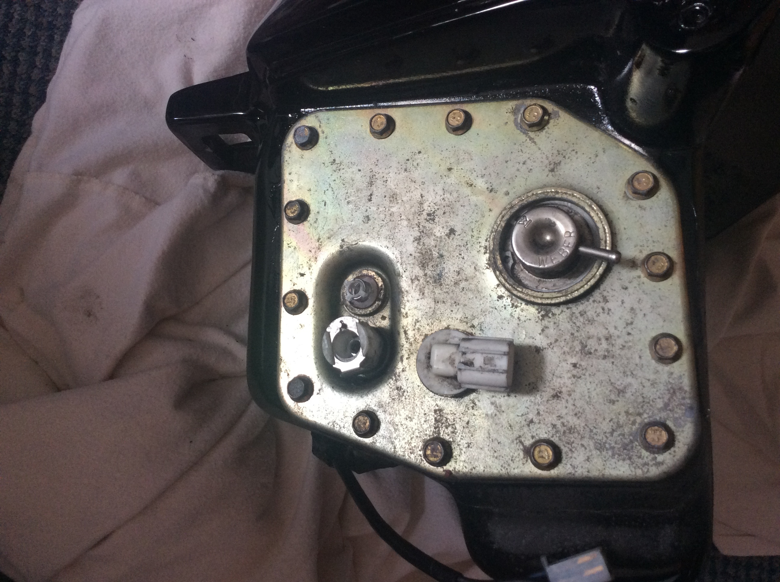

    Ok idiot question coming up am lost ive had my fuel lines off the tank and cant remember which way they go i have a red and white conector please let me know if the red goes to bottom or top its a 2002 955i

    My red conector is at left side and white is at right side of bike i need to know where red one goes on tank top or bottom

    Does red tap go top or bottom

    ? They are all different fittings, so whatever fits whatever will be the correct way round ???

    No they both fit thats the problem

    Both fittings are the same size

    OK, I see one fuel over flow, one power connection, two fuel quick disconnects, one male one female ?

    Dont go by that picture sir am waiting on new part i wanted to know if red pipe goes to top tank or bottom

    Ok update on bike not starting .after checking everything twice scratching my head .found spark ok ecu was down loaded good. Pump priming ok .now back together a third time still not starting so i pulled the fuel lines off the tank again . The dam part i got from triumph the fuel fitting for the tank was stuck solid a new part so althou the fuel pump was priming the fuel didnt get throu what a pain bloo throu it un stuck the new valve and away she went sorted after a week scraching my head
