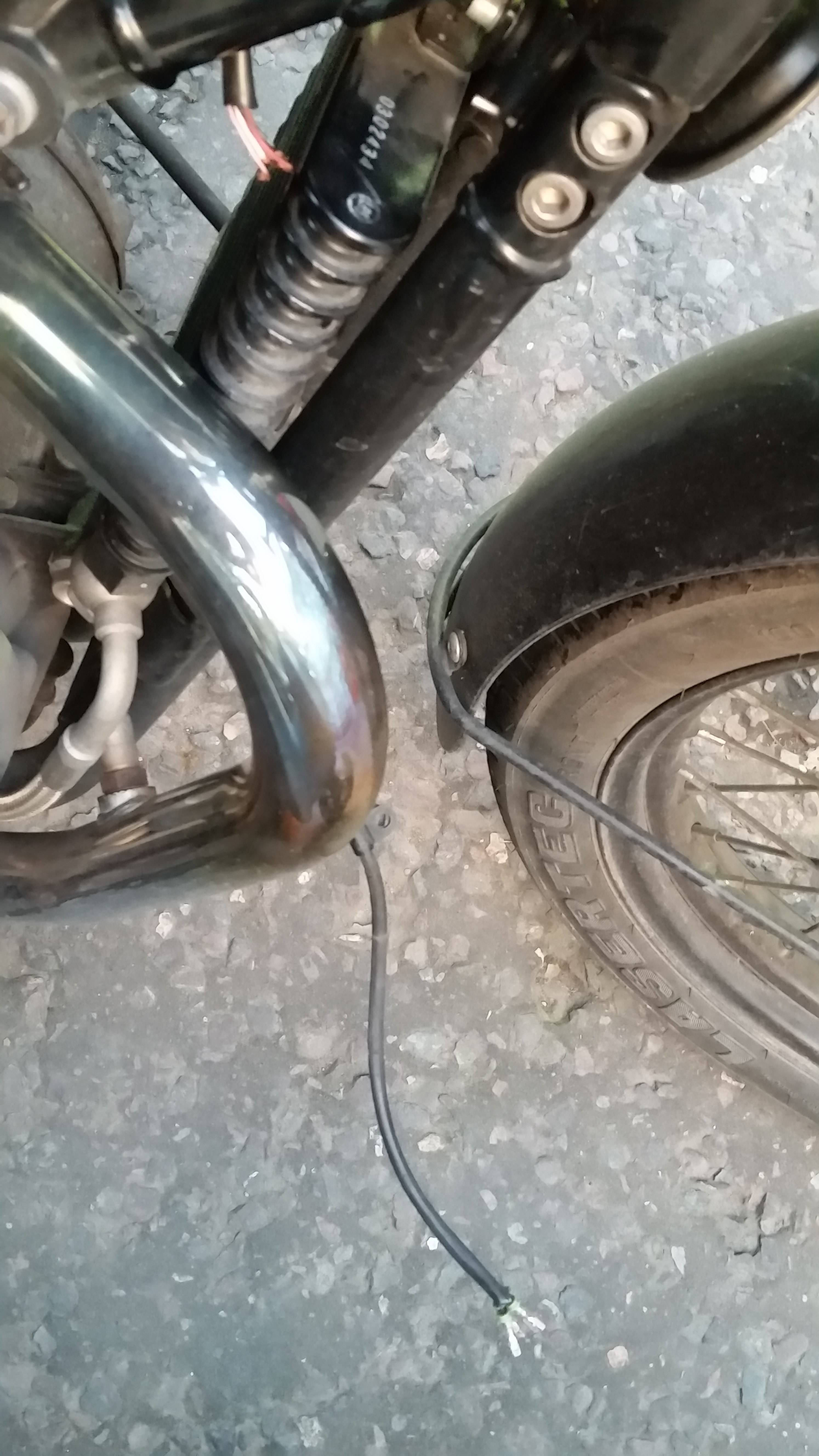

    i got on my bike this morning, which is a 2013 bonneville t100 and realised my MIL light was on. it started fine and sounded ok so drove for a bit when I parked the bike and got off i realised a wire was coming out the front, it was four smaller wires that go into 4 small long rectangular plugs.
    it looks fairly easy to fix if you know which wire goes in where but there are no labels or colour coordination. is anyone able to help? i would be keen to fix this myself rather than be left with a big bill in the garage.
    i have tried to attach a pic below. thank you in advance!

    Hi Ben, That looks like the cable that goes from the O² sensor in the RHS downpipe to a plug under the front end of the tank.
    This is almost certainly why your MIL is on.

    To understand more, it's the O² sensors that feed information to the ECU to adjust fuelling within a narrow range. As you can imagine if one sensor is disconnected it cannot feed info for the fuelling adjustments.
    If you follow the other side lead you'll find the plug & socket for the other sensor as well as the socket for this RHS one.
    MAKE SURE that the cable we're talking about is indeed the one from the RHS sensor so you're sure we're on the same wavelength. Assuming it is, it would be a very straightforward matter to replace the sensor with it's cable and plug.

    Hi Ben it doesn't need a complicated "How to.........." it is literally unscrew one sensor using an open-ended spanner of the appropriate size, screw in the new sensor and pass the cable and plug up to it's socket -THAT'S IT !!!!
