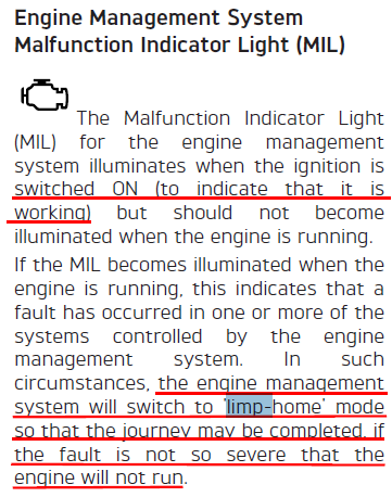

    I have a new Street Twin. Only 1,500 miles and has been fine so far. It might be a bad ECU (engine control unit). My owners manual mentions a 'limp home mode' for the ECU. Maybe that is the problem. See below from the O&M manual.
