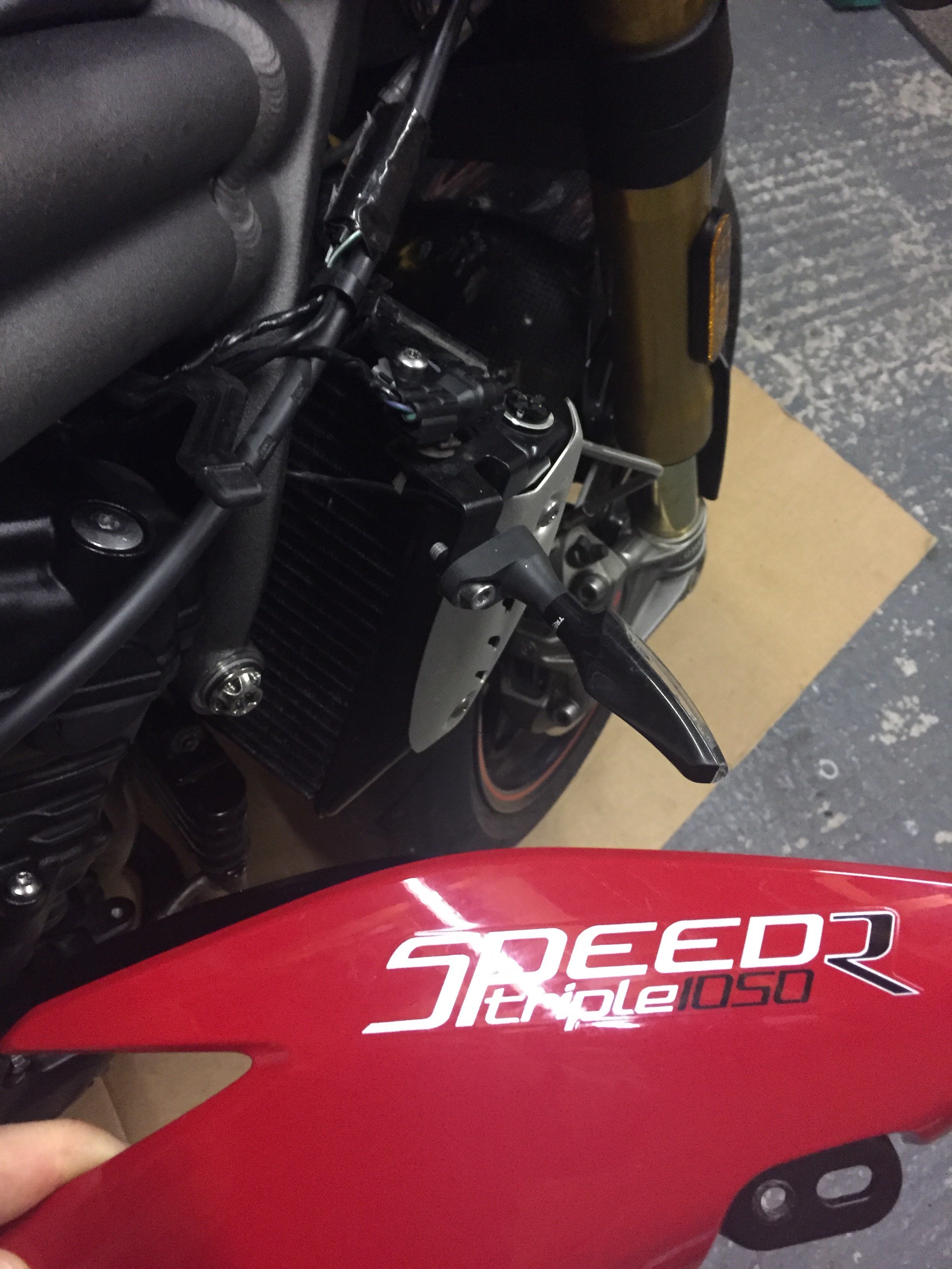

    However, help needed! The previous owner has removed the red fairing side decals to the bike and I want to put them back on which apparently involves removing the indicators and screwing them back on. Just wondering how to remove the wiring to the indicators? Do they simply pull out at the rubber bung where the wire attaches to the indicator? Or is there a connection elsewhere?

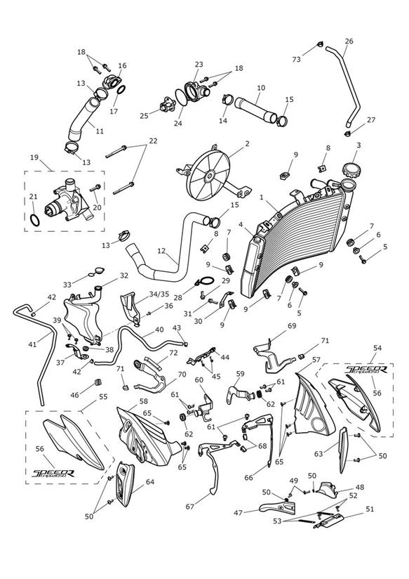

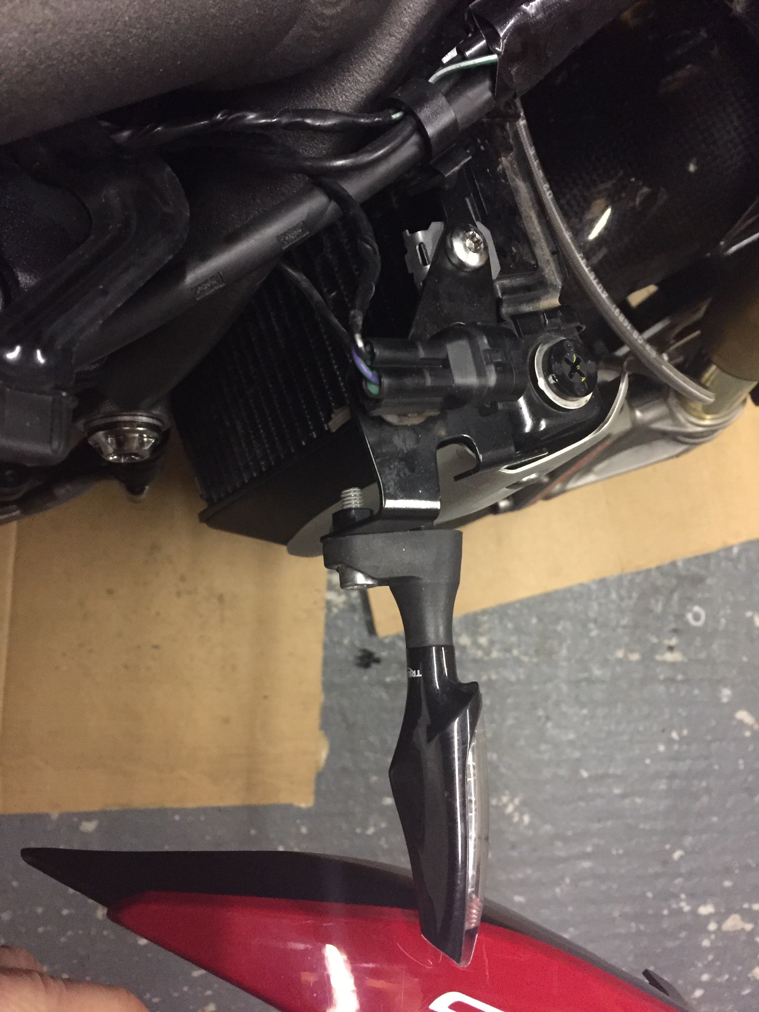

    Follow the wire for about 20-30cm and you will find a bullet connector for each wire
    Twist 90 degree and pull apart
    You should be able to just pull the wire gently to find the copnnectors

    The red fairing should slide into a clip that holds it in position at the front (above the radiator)
    Without this the fairings would be lose and rattle
    The fairing itself would slide towards the front of the bike

    Absolutly fantastic! Thank you very much for the information and your help! Both sides now fitted and done! The bike looks a million times better! :)

    Sorry to hijack your post, but what is that wired plug for
  15. Al86
    Al86 Member
    Jan 24, 2018
    15
    Merseyside
    Triumph heated grips my friend. Plug and play
