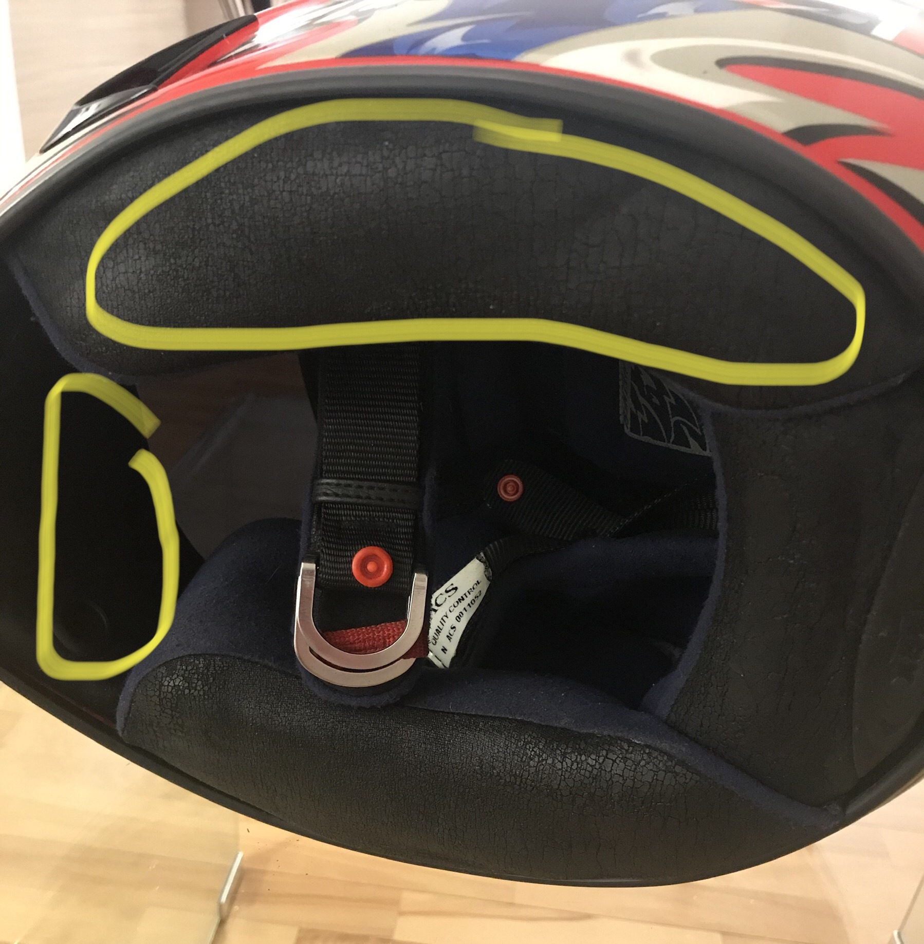

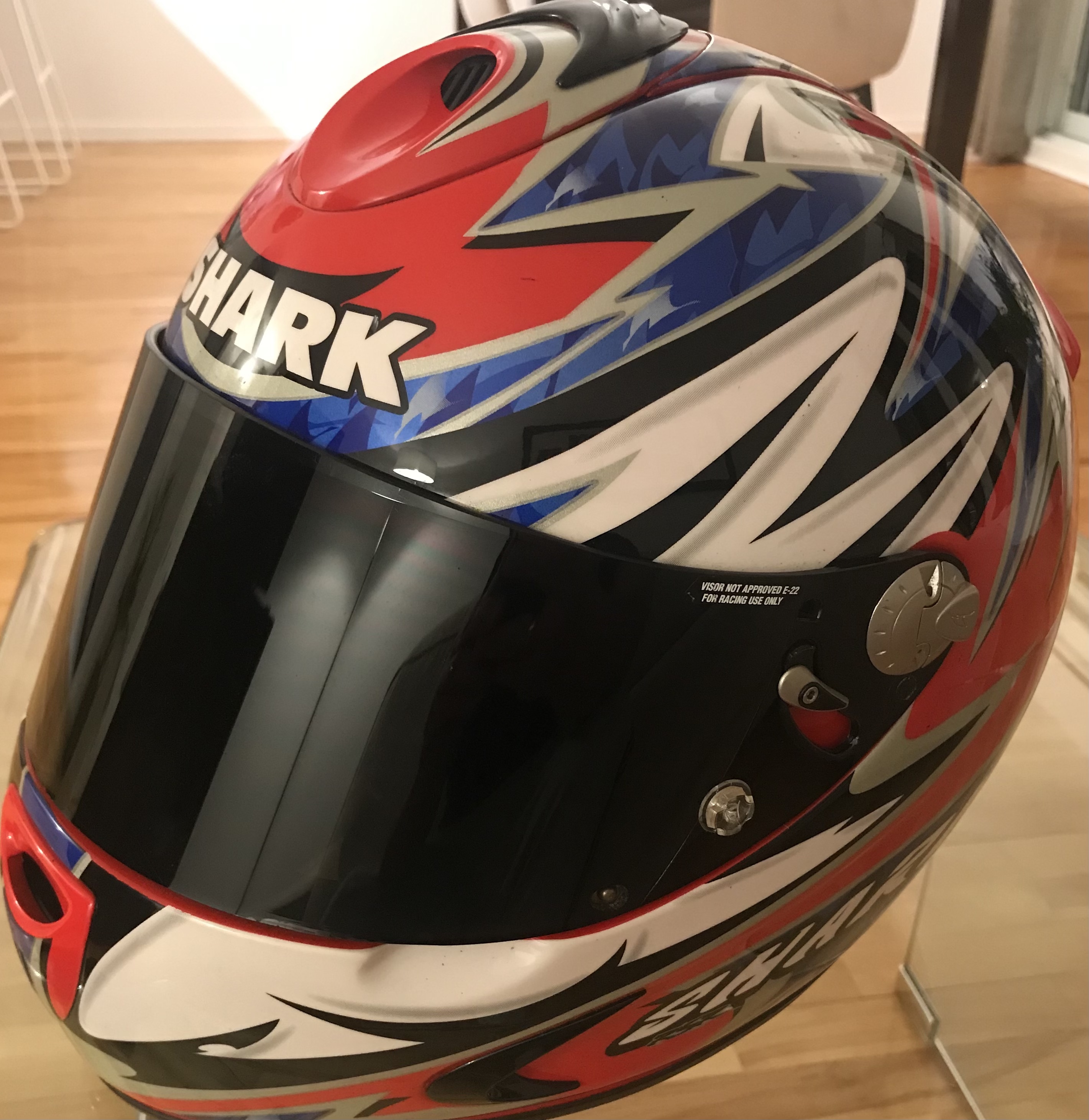

    I’ll try to keep it short. I haven’t owned a bike in 16 years, in two days I’m awaiting delivery of a 2014 Triumph Street Triple. I have a Shark helmet that I still like and is comfortable with two visors and in mint condition. It is almost 20 years old. I’m not one for “safety concerns “, where they say helmets should be replaced every 5 years or so.
    However, the black lining on the bottom of the helmet and the lining that would be right in front of my mouth is very dry and every time I touch it , it leaves a black residue on my hand or any surface it touches. I cleaned it with rubbing Alcohol and Vaseline, feels better but still leaves residue. What can I or should I do ? Should I just invest in a new helmet and toss this beauty out ?

    That is a beauty of a helmet, Jacob. But, yes, I'd strongly recommend that you bite the bullet and toss it out and invest in a new one. The material that makes the helmets protective degrades over time and it's just not worth chancing your noggin with an old helmet.

    Good looking pot plant holder Joseph, max 10 years, :poop: less if you leave in the sun when not riding:sun:

    To a certain extent I disagree with the above. However, I prefer to be driven by evidence rather that possibly’s, maybe’s and potentially fake science wrapped up with a “Safety” label. Overall though, the advice from helmet manufacturers is that you should replace them every three to five years but in the word’s of Mandy Rice-Davies: “Well, they would say that wouldn’t they?” And scientific papers back this up. However, no specific time limit or maximum UV exposure limit is stated in this research, only that there is a direct correlation between UV exposure and degradation on the helmets they tested (in Vietnam). Not surprisingly, helmet manufacturers have been aware of this for decades. So they have been compelled to build products that are not harmed by exposure to the sun, rain, dust, vibration, sweat, or producers applied to the skin or hair. The outer shell will contain stabilisers and UV blockers to mitigate against UV damage. So how long will a helmet last? I really can’t tell you. But I can tell you UV damage will be seen by discolouration of the outer layers. So what it your helmet’s history? Also bear in mind that helmet technology has moved on a fair bit over recent years. Overall it’s NOT a definite “replace” from me but more of a “maybe” or “probably”.
    I’ll suggest the black stuff is the liner edges breaking down. Spare liners might be available. Failing that you could try using leather repair gel to fix it, but I’m not that hopeful but it’s cheap enough to give it a try.

    Definitely replace it, whilst there may not be any evidence of UV discolouration on the outside the inner foam will have degraded, as you have found with the base and part inside the helmet in front of your mouth.

    My understanding of inner foam cores is that they do not deteriorate with time. They also do not “de-gas”. The products used in their construction are very stable and chosen for their durability. The outer shell, liner and strap/faster are the parts that will deteriorate over time. The non-replaceable component is the outer shell that is bonded to the inner foam core. The other parts may not replaceable due to the amount of time elapsed since this particular helmet was manufactured.

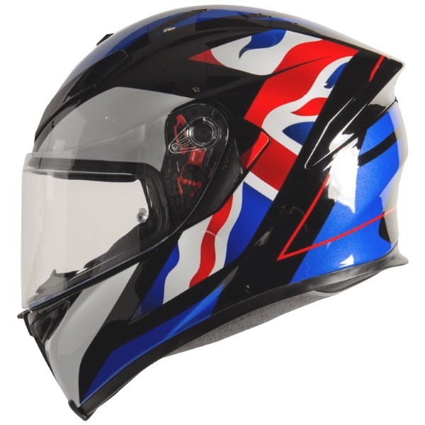

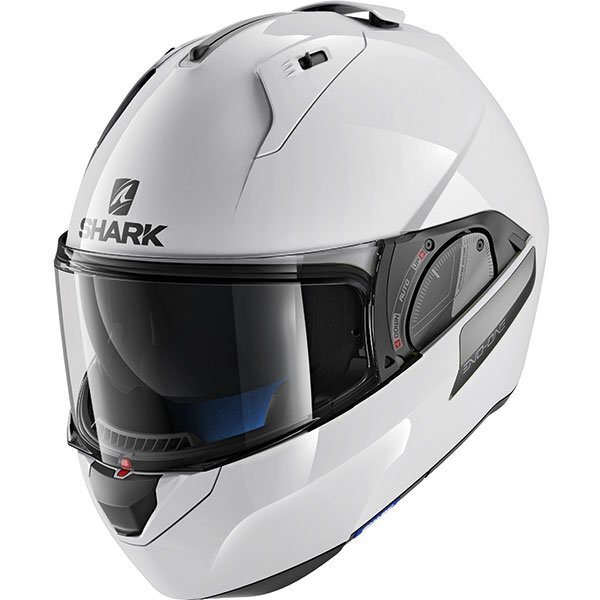

    These are my helmets:
    Two mid-range helmets. I use the Shark helmet for shorter, local trips and the AGV for longer trips and poorer weather. If I had to have one I’d have the AGV because it’s more comfortable, lighter, quieter and more aerodynamic. Both live in their bags/covers and neither are not exposed to excessive UV if for no other reason than I live near Newcastle. A summer’s day is when the temperature gets into double figures.

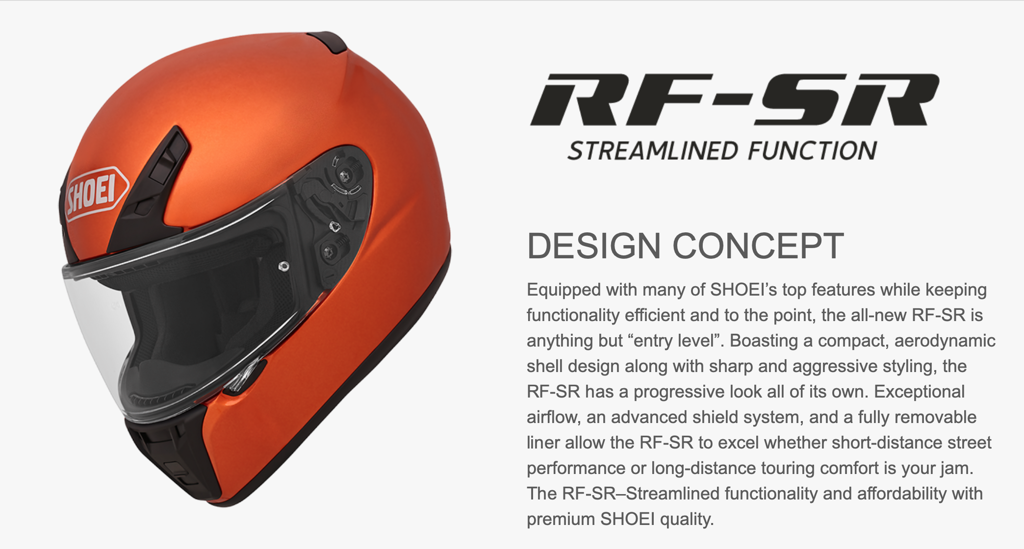

    I've had primarily Bell, Schuberth, and Shoei helmets. This new(er) Shoei model is my favorite and is not cheap but neither is it expensive at $400. It is similar to Shoei's RF-1200 but with a few less bells & whistles and designed for a more upright riding position (cruisers, touring bikes, standards).
