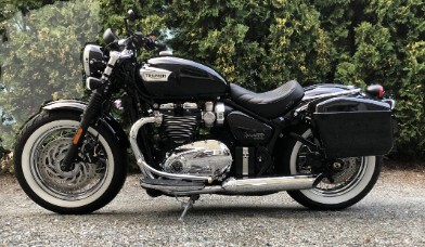

    Hello from North Carolina. I ride a 2023 Triumph Speedmaster. Got it second hand couple months ago and was loving it.
    And then ran into issues and will be asking for help and suggestions here.
    Cheers all !
  2. joe mc donald
    16,013
    @GA Forester Welcome to the family. Nice bike great picture thanks for sharing. Yes if you have a problem then let us all here it. Peeps on here are really willing to chip in with advice and help and all it costs is a big thankyou. How's that.

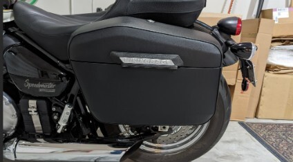

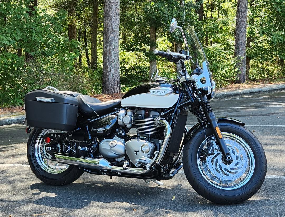

    Now, I'm not "casting shade" your way, and this may just be a manifestation of my slight case of OCD. Also, I realize you have other issues to tend to, but I believe your bags are mounted backwards; left on right side and vice versa. Maybe you like your bags mounted that way (personal preference). The way they are now caught my eye (again - the OCD) because I look at things and see the need for them to flow aerodynamically. So, I looked online for photos of Triumph Speedmasters with bags and every one with the same style hard bags had them mounted opposite of the way they are on your bike, that is with the hump and the diagonal side toward the front. I have slouch leather bags, so maybe I should just keep my mouth shut. Feel free to tell me to piss off.

    @Fork Lock : No offense taken and great observation there sir ! you're exactly right. I usually ride with just one saddle bag I never paid attention to the cues of the slope and that's me being lazy.

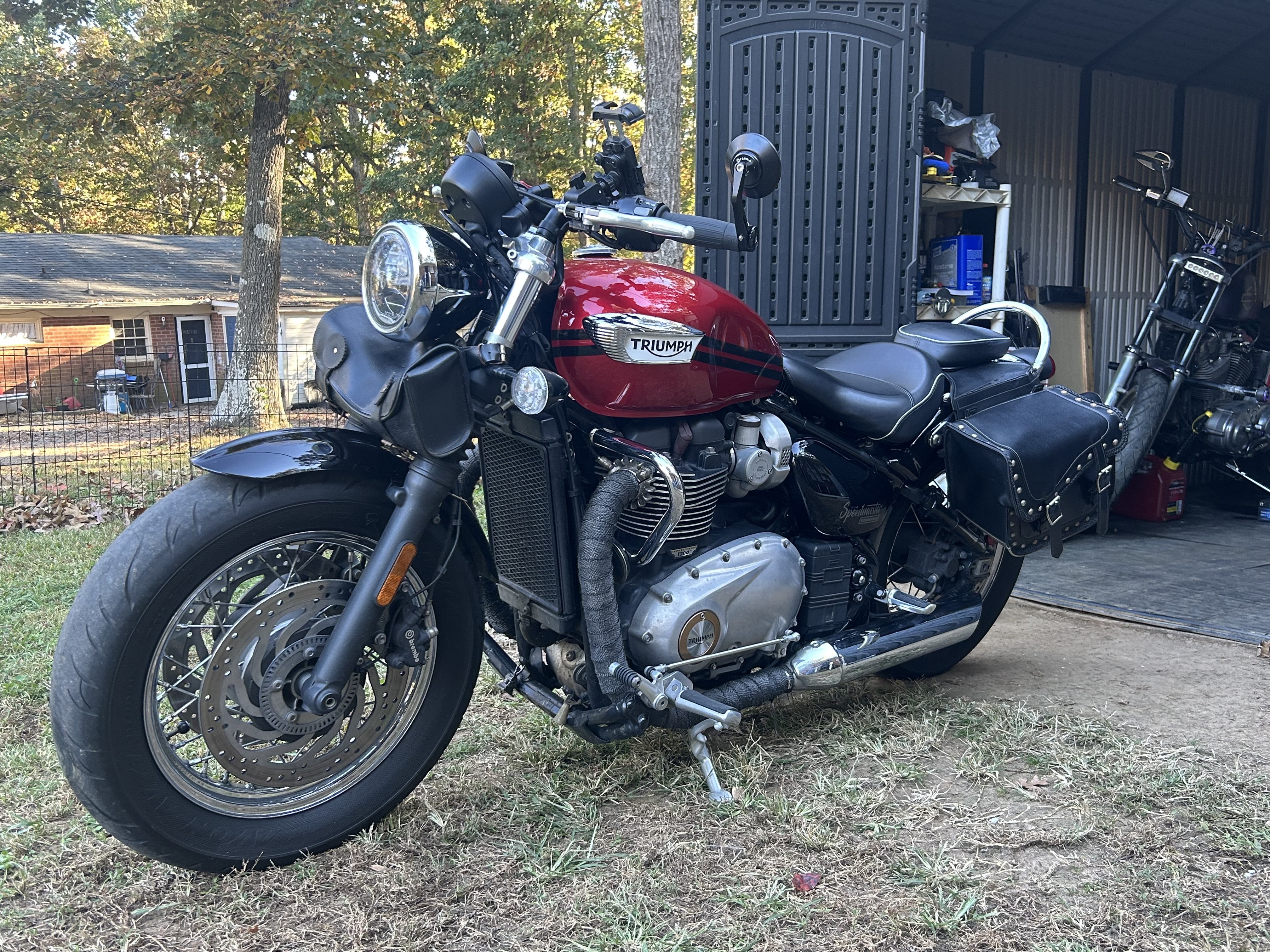

    That's not my ride! I just pulled a couple pics of Speedys with hard bags off the web. Mine has the red tank and black fenders - no whitewall tires. As I said, I have sloppy, leather, slouch bags.

    Now you have me thinking about whitewalls. And I have thought about having my tank repainted to look like yours. I like that color scheme, but I've gotten so many compliments on the red/black combo I've just left it alone.

    @Fork Lock - The red black combo is really nice. Before the Triumph, I had a cafe racer in a red white black paint scheme. I never imagined i would buy a bike in anything but black, but that 3 color paint really caught eye.
    You got a the cute pouch back of the pillion seat.

    Chin bag that there is no room for up under the headlamp. Great for storing little stuff that you don't want to have to root for in the big bags (registration, small flashlight, kickstand puck, etc.)

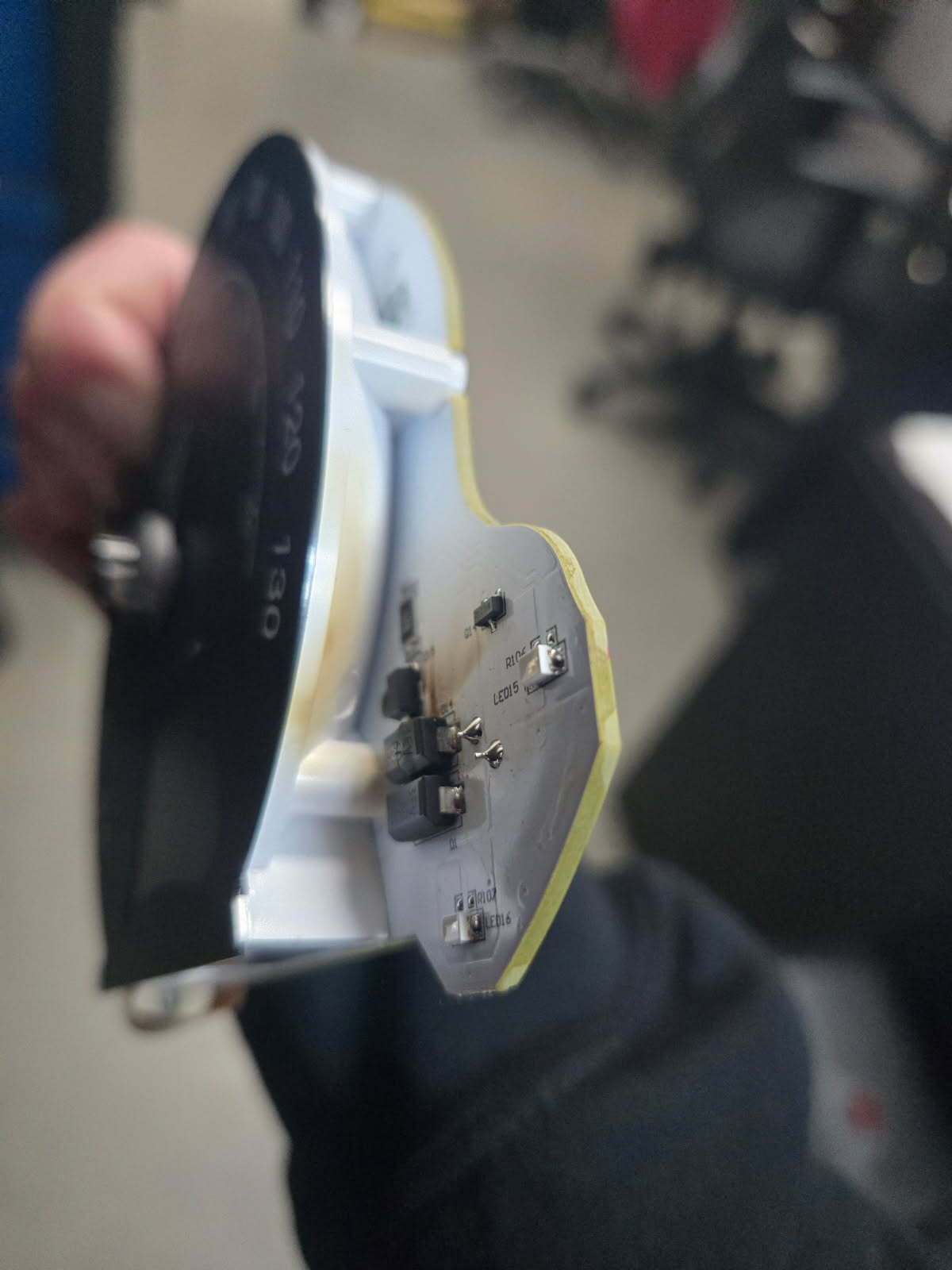

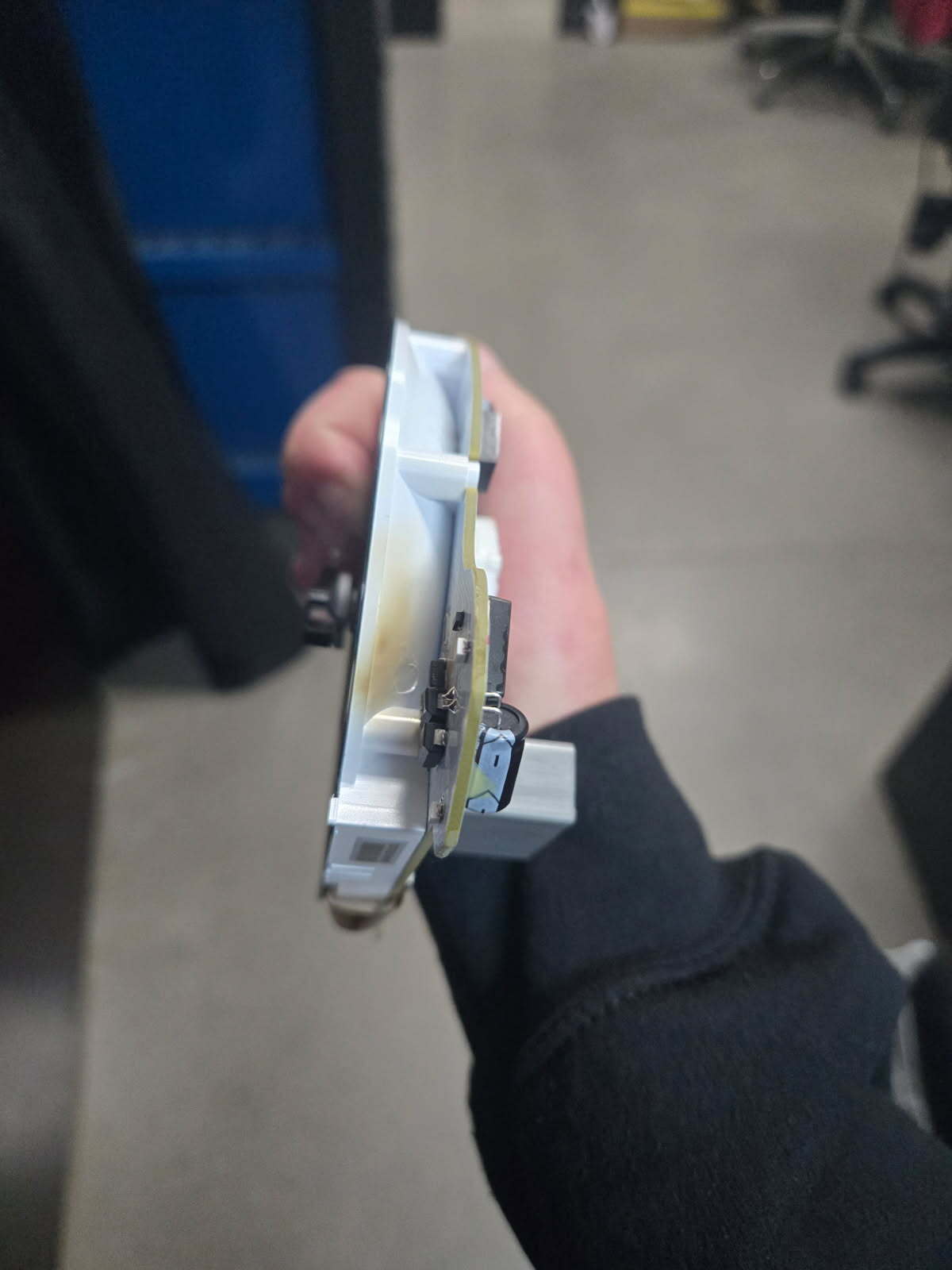

    May I ask what you mean by 'fool around with the battery connectors'? Did you just tighten them up?
    I read many people had the bad/stuck solenoid and battery ground issue leading to either the bike not starting or ignition fuse blowing.
    I feel my problem is past that stage, since it starts but not stop on turning the ignitions / kill switch. No doubt an electrical issue, but dealer tech has no clue what exactly it is.
    Updates on my case:
    Dealer tech raised ticket with Triumph USA, who is contacting Triumph UK tech, apparently no one ever heard this before. So all I am hearing back from them is 'we tried this and that .. nothing solid on root cause of problem' yet.
    Dealer noticed burn marks on the instrument cluster board and suspect something foul there, Triumph wants to try replacing it and see if that fixes the issue. See pics for burn marks. I don't understand how the instrument cluster even burns out with the minimal amt of current it draws in that loop of the ignition circuit, majority of the current is sent to the solenoid/starter part of the circuit.
    Beyond frustrated.
