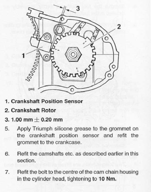

    I purchased a 2000 Trophy a couple of years ago and enjoyed it for the summer. Love the power/torque and the smooth running BBBB. Recently sort out the carbs, rebuilt them, and all new rubber. Seemed to have solved the issues that I had been experiencing but during my last ride it started missing, one cylinder then two, until it quit completely. Had to trailer it home. One coil did not meet spec so changed out the pair. Checked the air gap on the magnetic pickup and found it to be a little tight, 0.03 mm not sure how to make the adjustment on that, doesn't seem to have any room to get any more clearance? jb

    This is pic I have of sensor and there is alittle room to move it but not much crank_sensor.jpg

    Thanks QuadumphUK, I don't know how I'm going to get that gap, the gap I have measures 0.03 mm right now. I've tried with the screws loose moving the pickup to get a larger gap but as soon as I tighten the screws it goes right back. ?

    You just put feeler gauge between sensor and crank pickup to keep the distance. Bit like gapping a spark plug but not bending anything just keeping the distance to what you want

    Yes, tried that, loosed the pickup, inserted the feller gauge and tightened the screws, but after that the gauge is pinched and after removing the gauge and checking the gap it is still the same as when I started, 0.03 mm.:confused:

    Use a .04 gauge then tighten and re check it might just tighten up to .03 or try .05. So on and so forth until when you tighten and recheck it, it is .03
