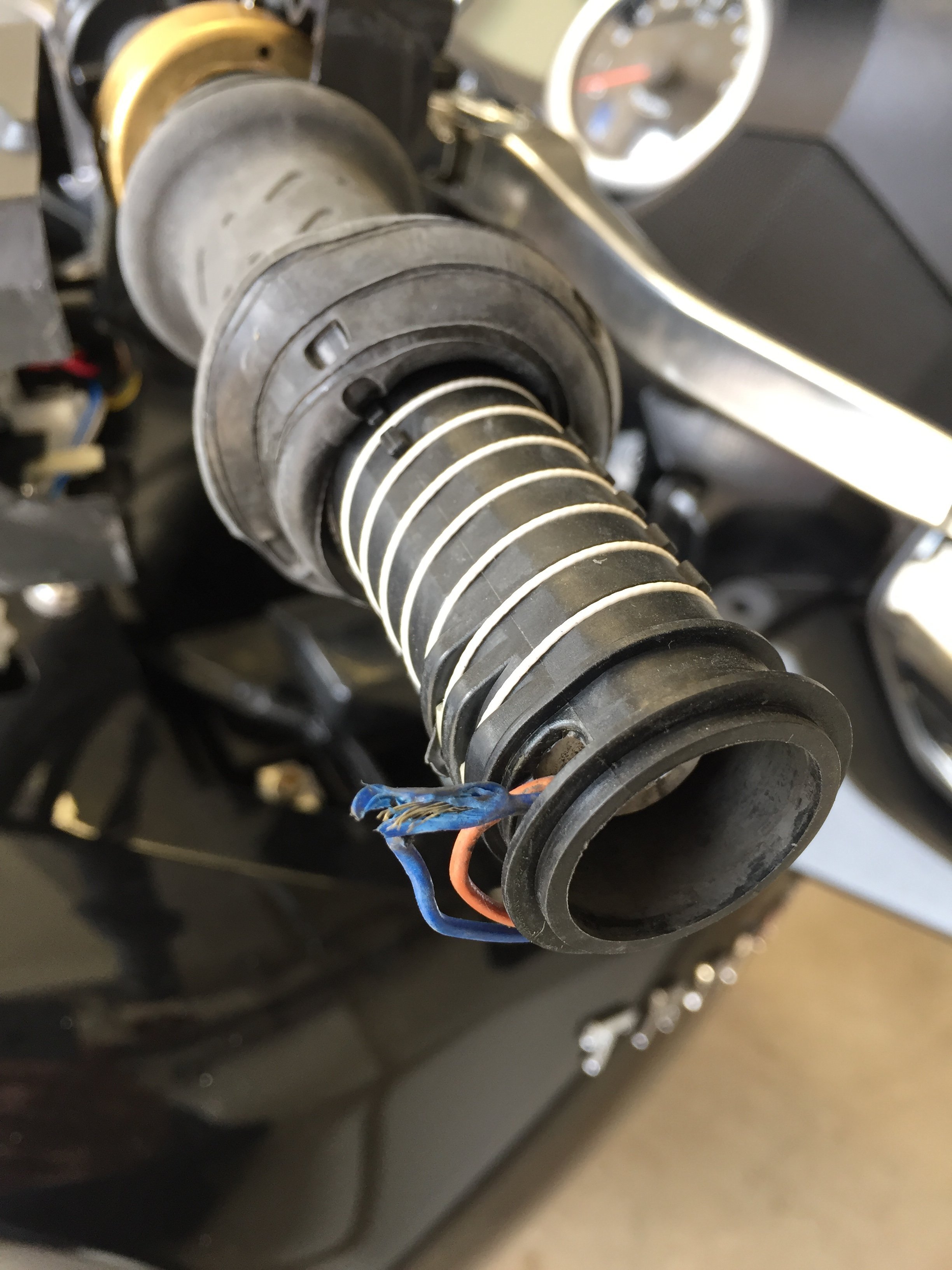

    I had an issue with one of my heated grips on the Trophy and was an easy fix.

    So, that looks like the grip itself is not heated, but there is a heating coil beneath the rubber grip. Is that right?

    Correct, one of the wires was pinched between the end of the bar and the end weight. Just soldered, sheathed and hey presto.
