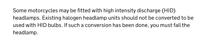

    Just for future reference - from gov.uk website on motorbike MOT testing. As I said, I think this was a new addition to motorbike MOTs. Although, interestingly, doesn't mention LEDs....

    As I mentioned above, the issue with the MOT seems to be HIDs, not LEDs. The problem with LEDs is, I think, that the beam is not as focused as a halogen. The reflector in your headlamp will be designed for a halogen, not an LED, so I suspect the spread is all over the place. LEDs are not as good as a decent halogen in a situation where a halogen was original fitment. I did replace my sidelights with more powerful LED ones, and they give a little more light at the edge of the road. However, if you want more illumination, add auxiliary lights.

    Lamps, reflectors and electrical equipment – 4.1.4 Headlamps – Compliance with requirements – Sentence changed from ‘Some motorcycles may be fitted with high intensity discharge (HID) headlamps. Existing halogen headlamp units should not be converted to be used with HID bulbs. If such a conversion has been done, you must fail the headlamp.’ to ‘Some motorcycles may be fitted with high intensity discharge (HID) or light emitting diode (LED) headlamps. Existing halogen headlamp units should not be converted to be used with HID or LED bulbs. If such a conversion has been done, you must fail the headlamp
  19. Aidan
    Aidan Well-Known Member
    Dec 31, 2018
    185
    thanks crispey - couldn't be clearer than that!
