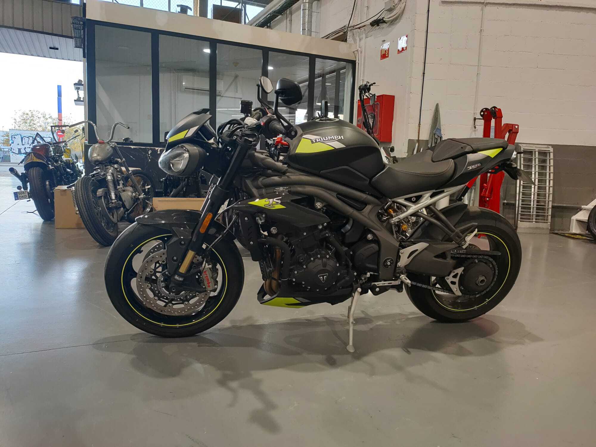

    hi there !
    I'm going to buy a speed but I have to say that I don't really like a lot the headlight, instead I've seen the new Street RS and I think that that headlight would suit really cool on a speed.
    As far as I could see on pictures, looks that it will fit, but I haven't seen in person.
    Do you thing that would be possible ?
    I've made a photo montage and I think that its really nice
    and the original.
  2. Col_C
    Col_C I can't re...Member
    Aug 5, 2015
    1,435
    It's probably doable - if you've got the money! Certainly on older models lights and flyscreen are interchangeable. I've got a 2015 model and gone the other way, going back to round headlights but with a modern led twist. (see avatar) I needed to make a minor wiring change to enable dlr's only, but you probably don't even need to do that. On older models the support bracket for Street sits lower than Speed (but still interchangeable), don't know if that's still the case.

  8. Tomeu
    Tomeu Member
    Jan 8, 2019
    45
    spain
    hi again.
    here you can also see some videos
    https://drive.google.com/drive/folders/1PYZ3rsP8oqFiN4WTNi1OI6jDxwfQaBxd
    by the way I have received a mail
    "“KIT will do Street 2020 in Speed RS 2018-2020 All this costs € 713.50 Includes optics, mounting kit, electrical installation, screws and mounting instructions. Remember that we will need you to send your section of electrical installation in order to make the modifications and prepare it so that the original optics can be reassembled in a plug & play plan ...! If you make a pack of several I can give you a discount with the optics ... Which is what money is worth ... Remember that the kit is tested only for speed triple 2018-2020. I guess 2016-2017 is the same, but we haven't confirmed it. "

  13. SpeedRS
    SpeedRS New Member
    Sep 25, 2018
    17
    France
    This modification interests me a lot!
    Do you think I can order from my dealer in France?
    If I understand correctly, there are just 3 pieces to order. The optics / "X-shaped" piece of metal / one piece of plastic support?
    What about the electric cables?
    Are these parts original or for adaptation?
    Thank you very much !

  15. Tomeu
    Tomeu Member
    Jan 8, 2019
    45
    spain
    TE="SpeedRS, post: 530344, member: 11654"]Good morning all !
    Do you know the Triumph part number to make the modification?
    I can not find the two black metal parts in the shape of "Y" and the power cable of the headlight :([/QUOTE]
    Hi! Those parts are made by Triumph Girona
  16. SpeedRS
    SpeedRS New Member
    Sep 25, 2018
    17
    France
    Hi ! Thanks !
    okay ! These are pieces created by Triumph Girona, I didn't know
    You only needed the "Y" part, 2 cables
    That's all ?
    You did not need the rubber part (triangular shape)?

  19. SpeedRS
    SpeedRS New Member
    Sep 25, 2018
    17
    France
    It’s done !
    :heart_eyes:
