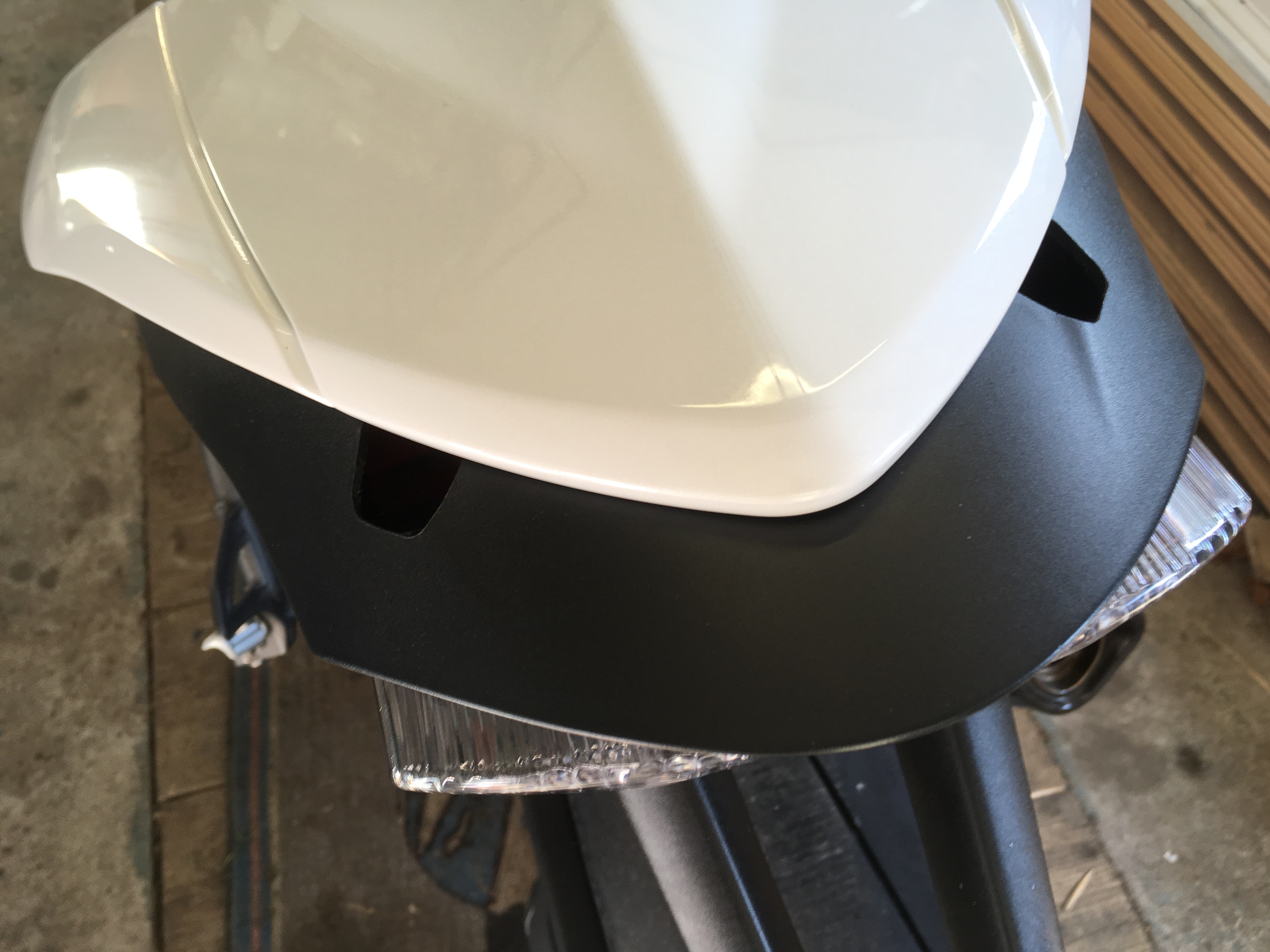

You have to swap the rear light finisher with the grabrail too, as it’s got a cutout each side that the standard one hasn’t got.

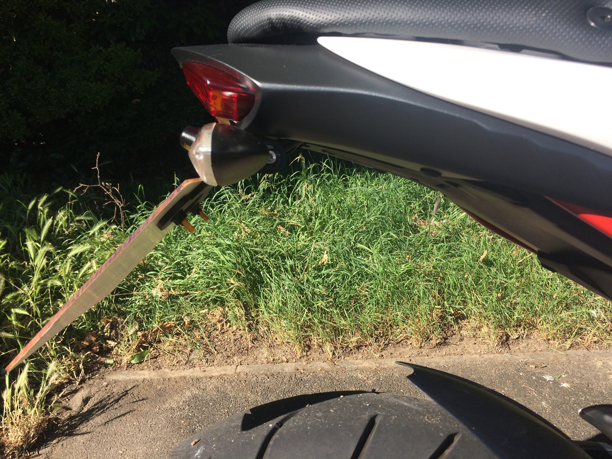

I have a tail tidy now, but if anyone a grabrail (Mint0 Bryan, I have ordered a Evotech tail tidy from Conquest, I get the bike Saturday morning, apparently all the OEM bits are with it, hopefully the bracket you mention is included.
you havnt understood me, the grab rail comes with a replacement black plastic finisher that fits round the subframe and rear light, its not a tail tidy like the Evotech one, its one of the bikes original panels under the pillion part of the seat.
Sorry Bryan, thank you for that, I am hoping to get out for an hour next weekend, if I haven't the components to remove it will be a case leave it in situ till I can sort it out, Thank you for the advice "If in doubt ask"

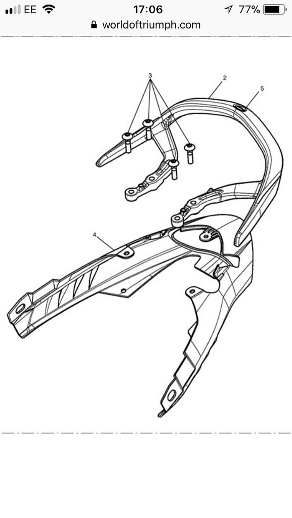

You can remove the grab rail, there are just 2 small cut outs left in the plastic finisher. The black bit around the rear light. the cut outs are under the very end of the pillion seat just b4 the white panel starts.. Untitled by Bryan Haynes, on Flickr Its item 4, you can see the small cut outs at the back. Untitled by Bryan Haynes, on Flickr
Conquest do a nice Carbon replacement but its not cheap! £199 I think, original plastic one is about £70 new, hope you get lucky and the original one comes with the bits.

Bryan, you are absolutely correct, I would imagine the replacement (OEM) section is available from Triumph, I can live with it for now as the weather is a bit shite and I wont be venturing out till it breaks
yes Your bikes one is here. https://www.worldoftriumph.com/partscatalog/catalog/browse/catalog/triumphmc/modelid/610352/
Thanks, Bryan, I got that carbon tail unit for £52 lets hope it fits the 2017 model,,,photos when its on mucka
