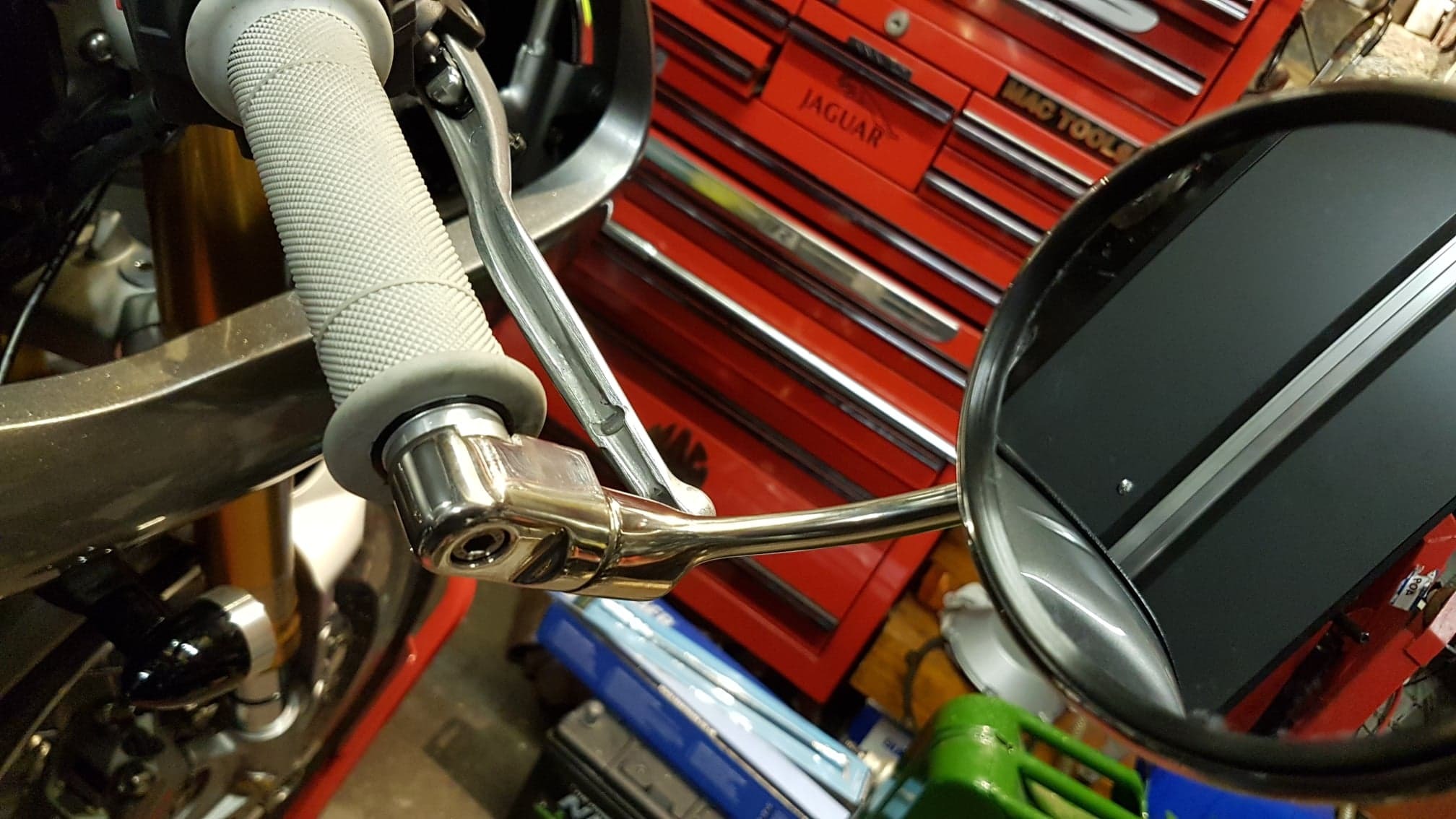

A gratuitous photo for anyone else thinking of doing it. These mirrors are the old Stadium design; beautifully finished, to my eyes more in keeping with the bike's styling than the original items, staying solidly in place and at least on my 1200 R, vibration free. If fitting to a watercooled twin be sure to pay the extra fiver for each mirror to include the T120 bar end adaptor. Per another thread in this forum, my next task is to cover the exposed bar end, join and adaptor with some tubing - ideally polished or brushed.

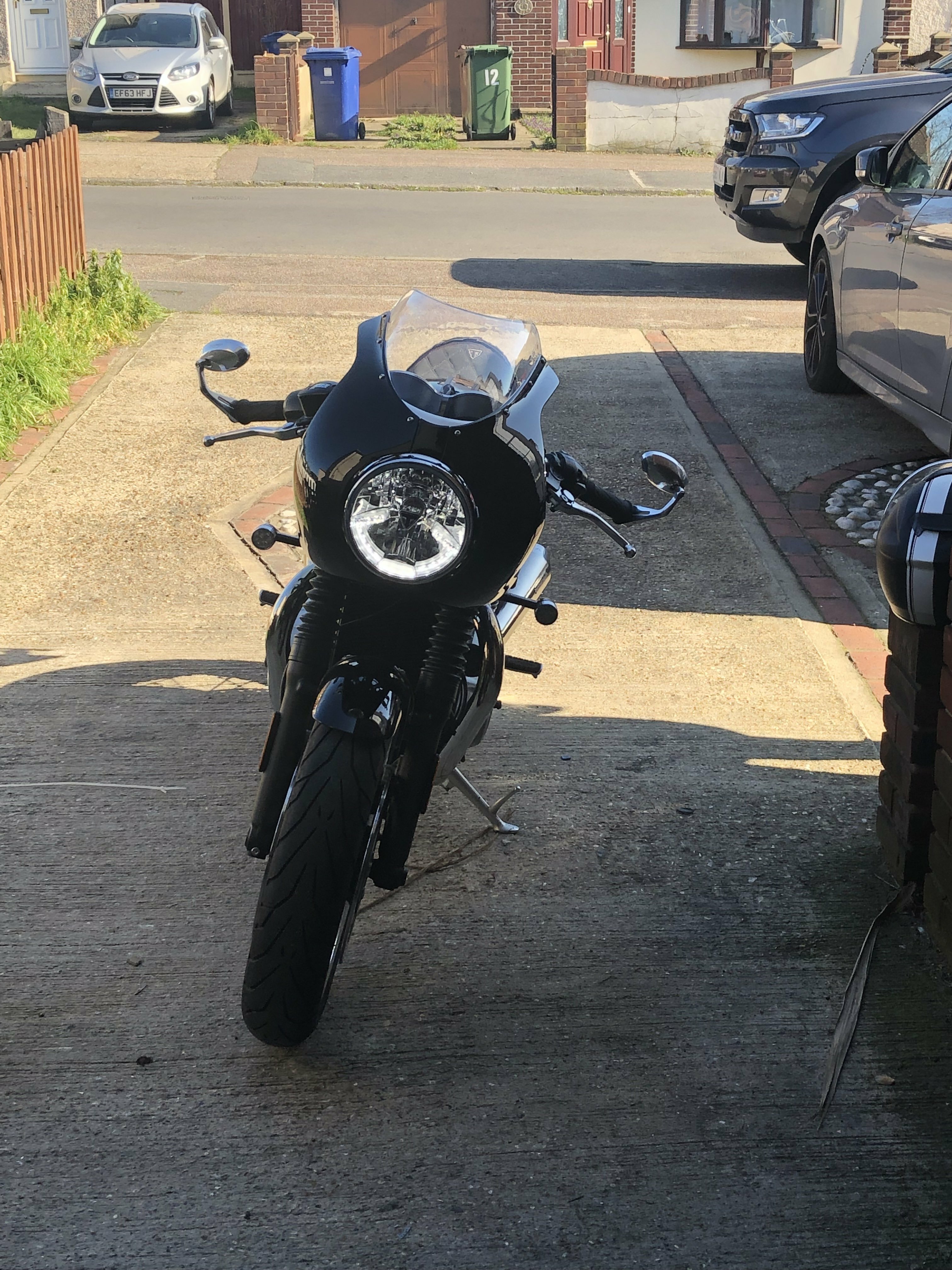

Looking good my man! I have been thinking about getting rid of the stock "mouse ears" mirrors on my scrambler. Can you see anything besides your arm with these? And, I see on ebay such a price disparity. I guess it is like the old saying, you get what you pay for. any opinions?

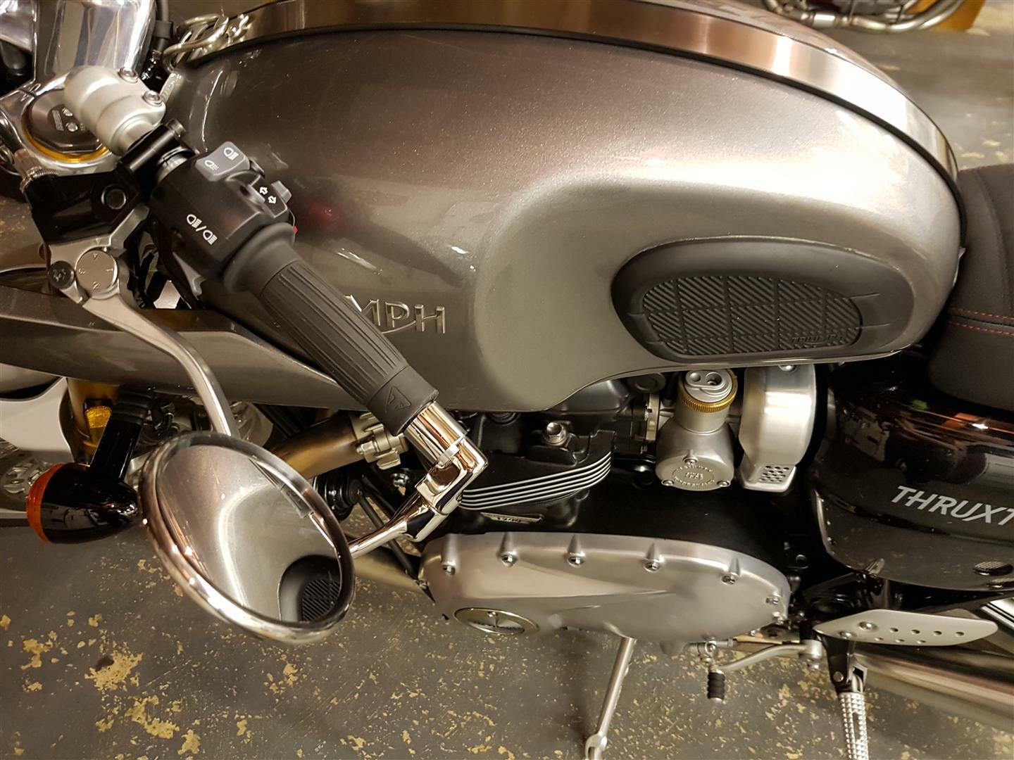

I fitted these to my Thruxton today, and turned inwards you get a width saving of about 40mm and surprisingly good view behind
The mirrors have detents that click the arms in three positions: Inboard, middle, and outboard. I use the middle position as the view is completely unobstructed and the bike can be filtered more readily than with the mirrors in the outboard position - even though I love the look of them even more like this.
I must admit I’ve set them at a slightly weird angle,so I don’t hit them with my gloves but still have good rearward vision
How do you find the overall width? Since I fitted the fairing with the ace bars I found the standard mirrors way too wide. And I know the ones I bought look ridiculously small they are good
