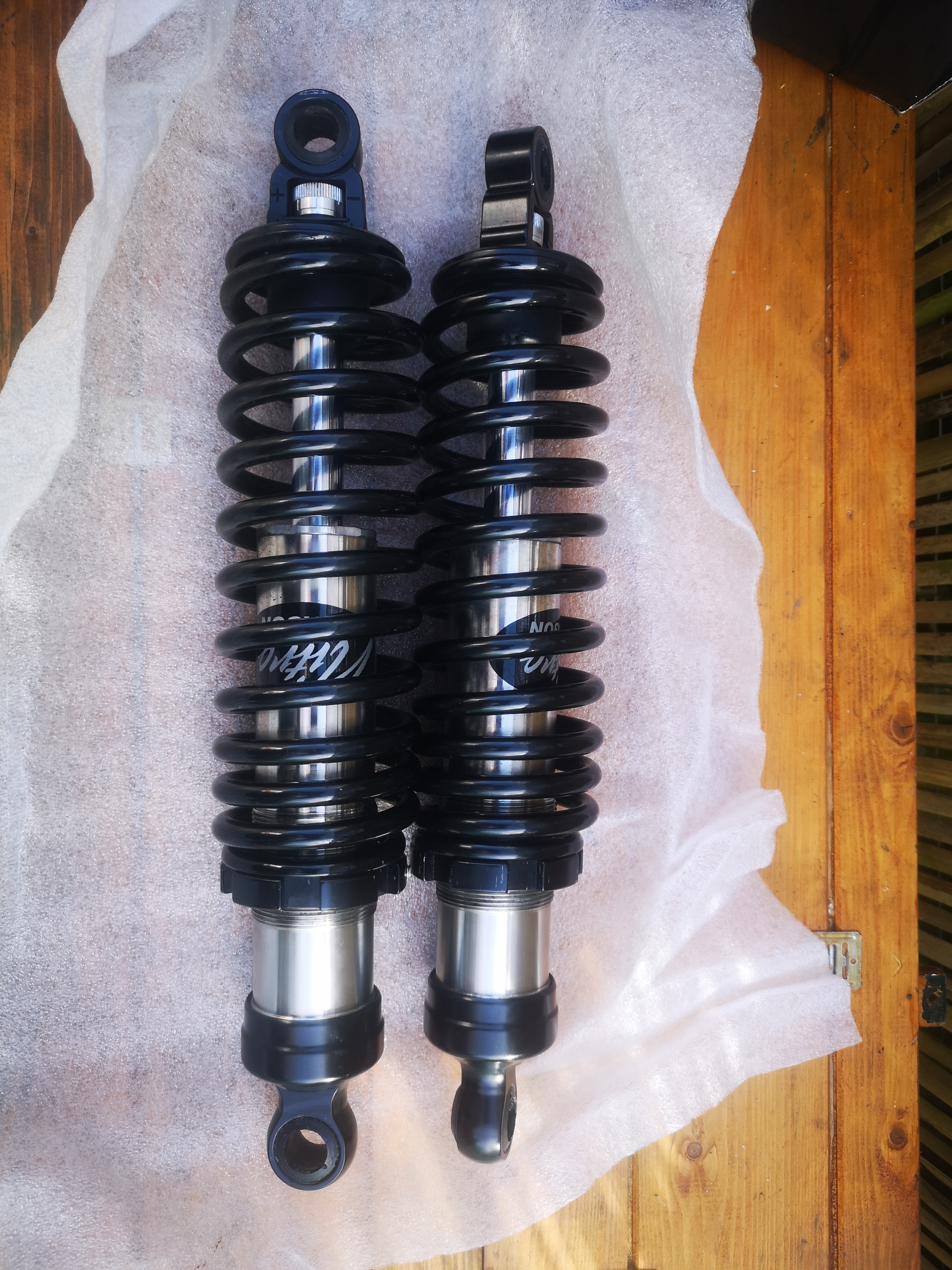

  12. crispey
    7,322
    I’ve got the 2810s on my thruxton and they work fine, you didn’t put them on upside down or anything? There were a few people that queried the fact that the sticker was upside down at one time!

    Hi, if you mean that the collar is at the top then that's the way they were on the bike cheers.
  16. crispey
    7,322
    Yeah sorry but as they look upside down peeps did take the stickers off and fit them the wrong way round
    But not sideways like mine:confused:

    NEW FOREST
    Yep the same, I'm wondering if they have gassed them up too hard?
    Mine are nitros, look a bit beefed up in comparison.
  18. Cupoftea
    Cupoftea Noble Member
    Dec 16, 2018

    Here they are upside down in the picture
  19. crispey
    7,322
    They certainly do look chunky, eat some more pies!

    Just lost 1/2 stone in 2 weeks, not putting it back on, too many jackets to make fit. The springs are 11 or so turns, and most other shocks are only 9 at the most.
