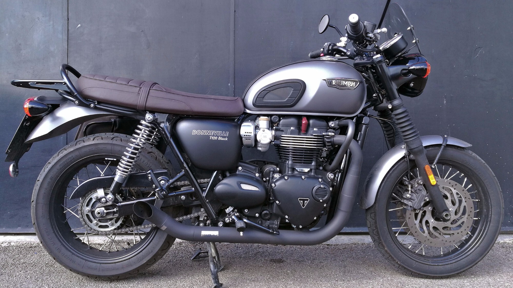

    I would like your opinions please!
    I'm considering upgrading my 2021 T120 with Hagon's Custom Classic, or Nitro, rear shocks. I'm looking for a firmer, more 'tied-in' ride, but I have to be honest and say the change is principally aesthetic.
    Custom Classic:
    Nitro:
    So, would the good folk of the Triumph Forum lean towards the period shrouded Custom Classic, or towards the newer Nitro?

    I have Nitros on my T100. Absolutely fantastic kit and easy to tweak preload and compression/rebound. Firmer but SO much better roadholding.
    Just say, your second pic is of the 2810 models I think, not the Nitros.

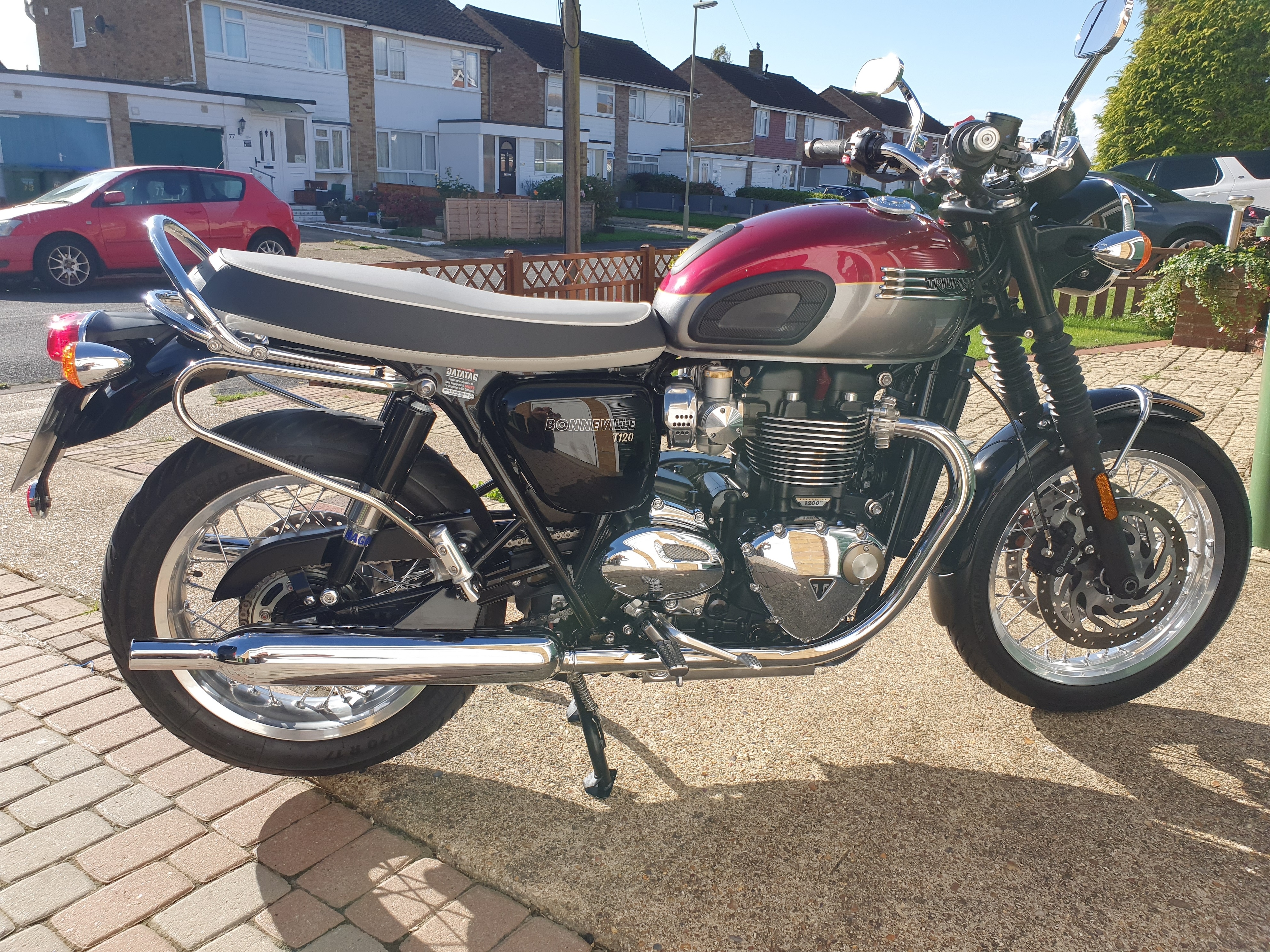

    I have Hagon 2820 shocks on my 2020 T100 and really like them. A nice improvement over the stock springs and not quite as expensive as the Nitros. Might be all you need.
