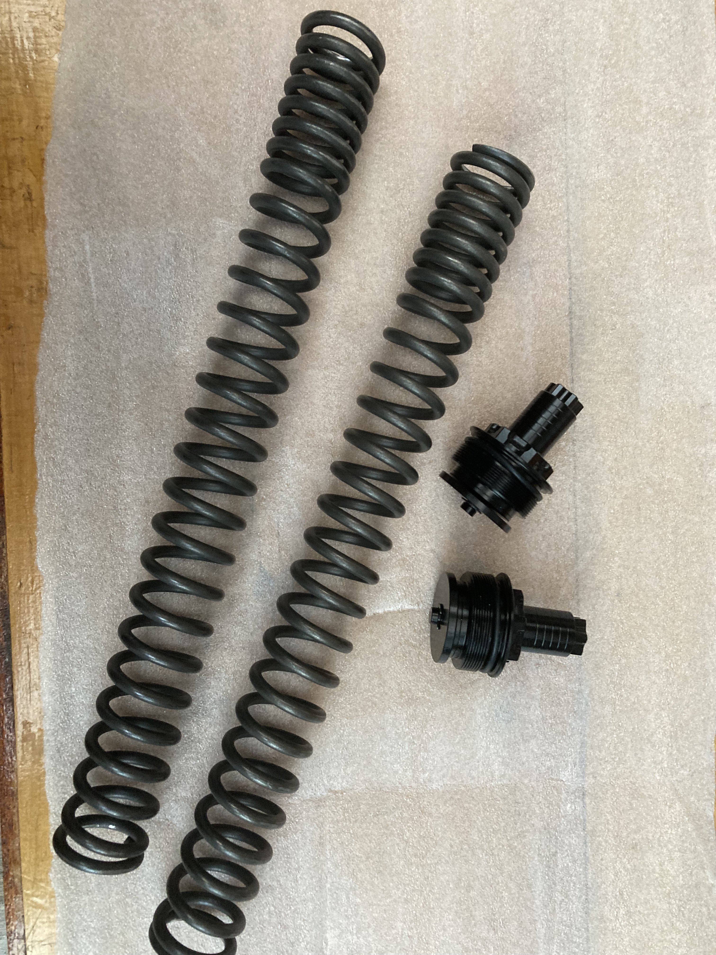

    I thought I may as well do the front end at the same time. The TEC progressive springs and adjusters arrived today.

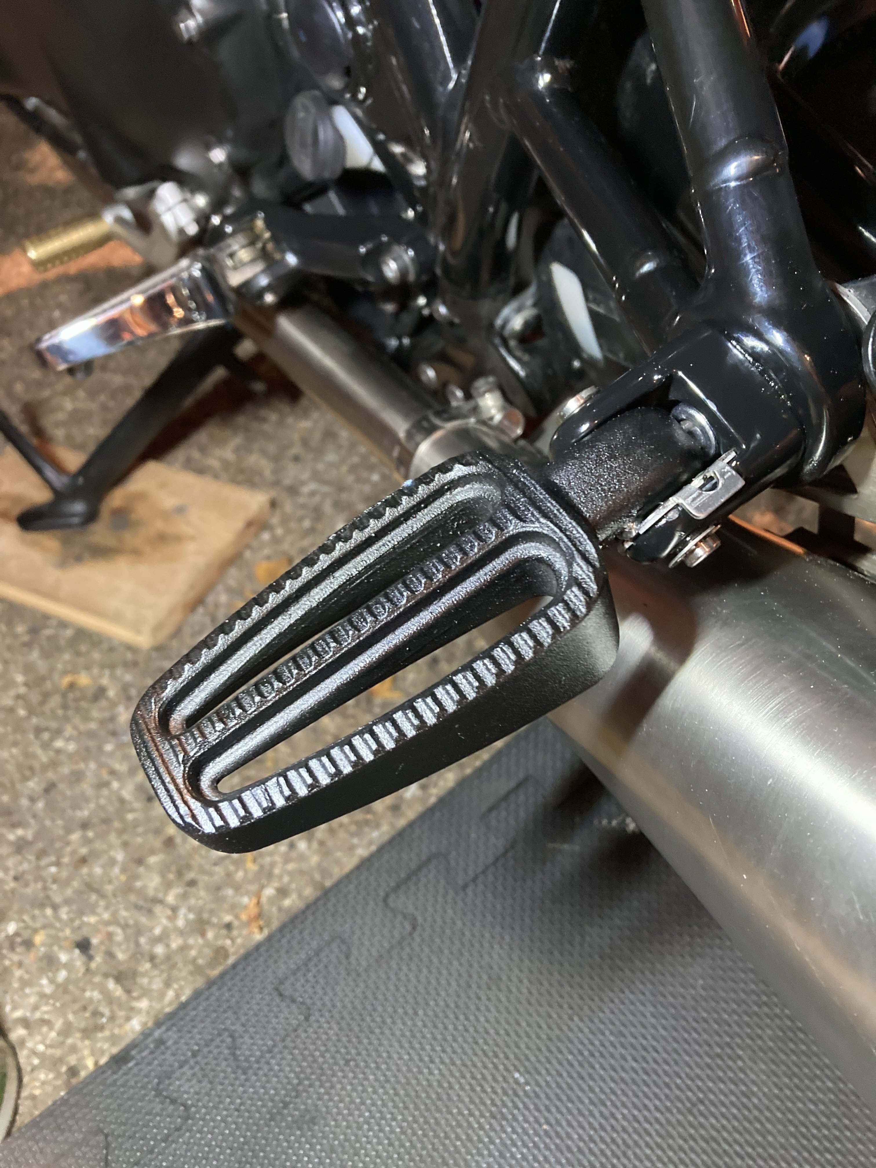

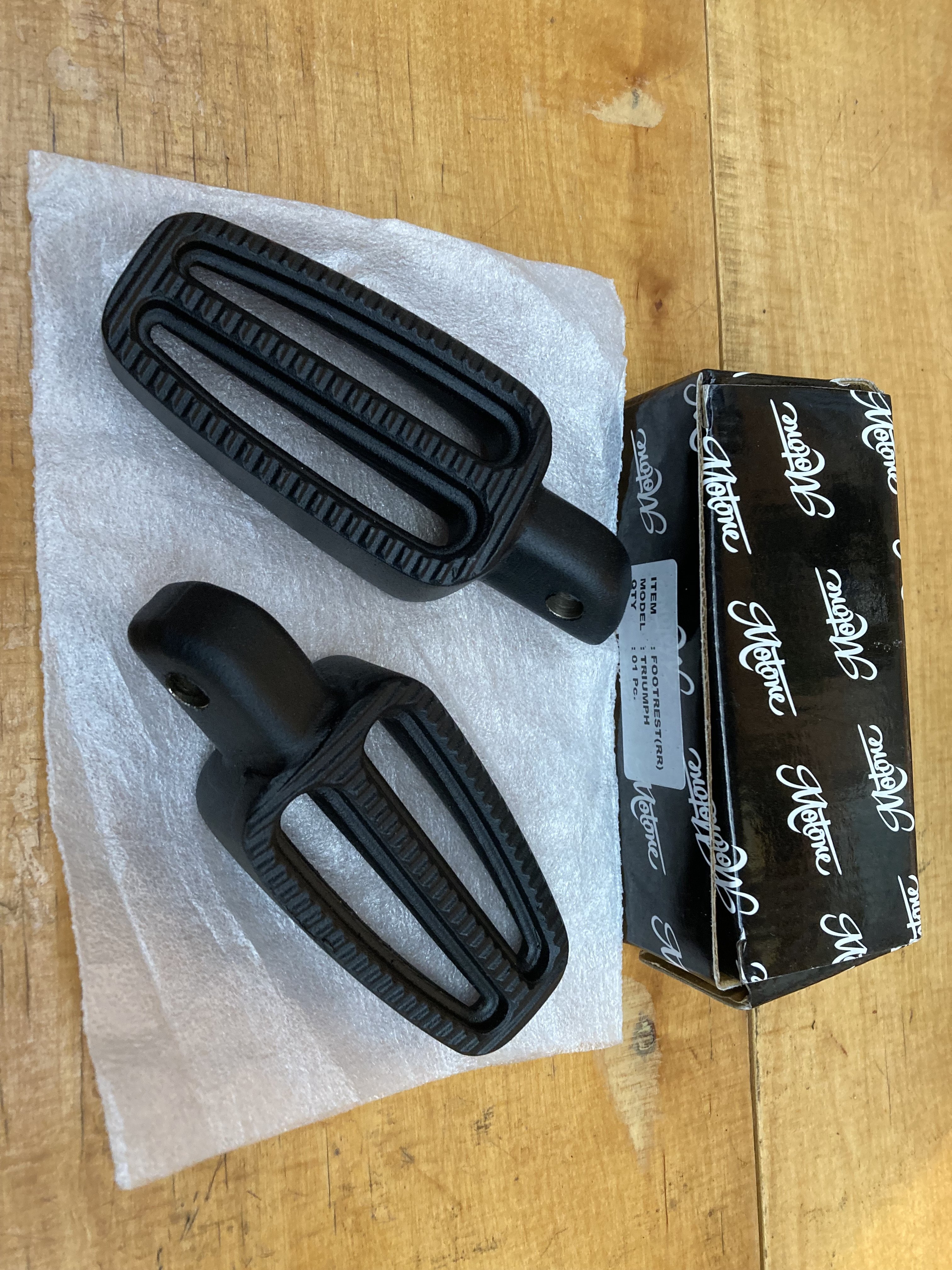

    Also decided to get the Motone pillion foot pegs. I fitted the riders foot pegs some time ago. Motone don't normally sell the rear ones separately but I made a call and we did a deal, which coincided with their 22% black Friday discount.
    I started to fit them but managed to lose the tiny E-clip that secures the footpeg bolt..on both sides! They pinged off and disappeared into the darkest recesses of the garage. I have no idea how they can be removed to avoid this happening. The result was that I had to buy a box containing a lifetime supply of 100's of E-clips, of varying sizes, and I am now waiting for it to be delivered.
    No idea why those pics decided to duplicate themselves, sorry.

    Hope the Kitchen refitting has gone / is going well. When you get round to fitting this kit, do let us know how it went and what the bike is like afterwards.
    I'm working on my list of pre-riding season mods, which will include fitting the YSS valve emulators (the the same as in your kit and I've already fitted TEC progressive springs).
    If you haven't already done it, when you take the drain bolts (what Triumph unhelpfully call "Capscrew Oil Lock") out of the forks, please could you take the time to measure them and let me / us know the dimensions of the bolt (I want to replace mine)?
    Does the instructions in your kit give any guidance on how much preload to put on the emulator valves for different rider weight / riding styles? The instructions that came with my valves only gives details about how to drill out the Piston Dampers and that the valves come pre-set to two turns.
    Looking forward to hearing how it goes:).

    I think I've described the difference the TEC springs made in other suspension threads, but they can get buried with time.
    My Street Cup was ordered with Triumph's Fox rear shocks fitted, so I can't describe what difference they made, but I'm happy with them as delivered; set at the softest spring rate and the damping set to normal. If anything they may be a little firm.
    As for the TEC progressive front springs I'm delighted, especially for the price: They looked well made on delivery and fitting was simple, supported by watching TEC's fitting video.
    I did place the TEC spring side by side with the standard spring before fitting, and it looked like they may be a few millimetres shorter, which might suggest a very slightly softer ride, but I doubt it.
    For me the improvement in ride and handling was noticeably better: Before fitting I found the front end very harsh with little sense of what's going on under the wheels:(, especially on our uneven, poorly maintained UK roads.
    After fitting, test rides (that included deliberately aiming for sunken manholes and shallow pot holes) revealed a much smoother, more compliant ride with more of a sense of what's going on under the wheels:).
    And of course all of the above was improved even more when I recently replaced the stock Pirelli Phantom tyres with Avon Road Rider 2s:cool:.
