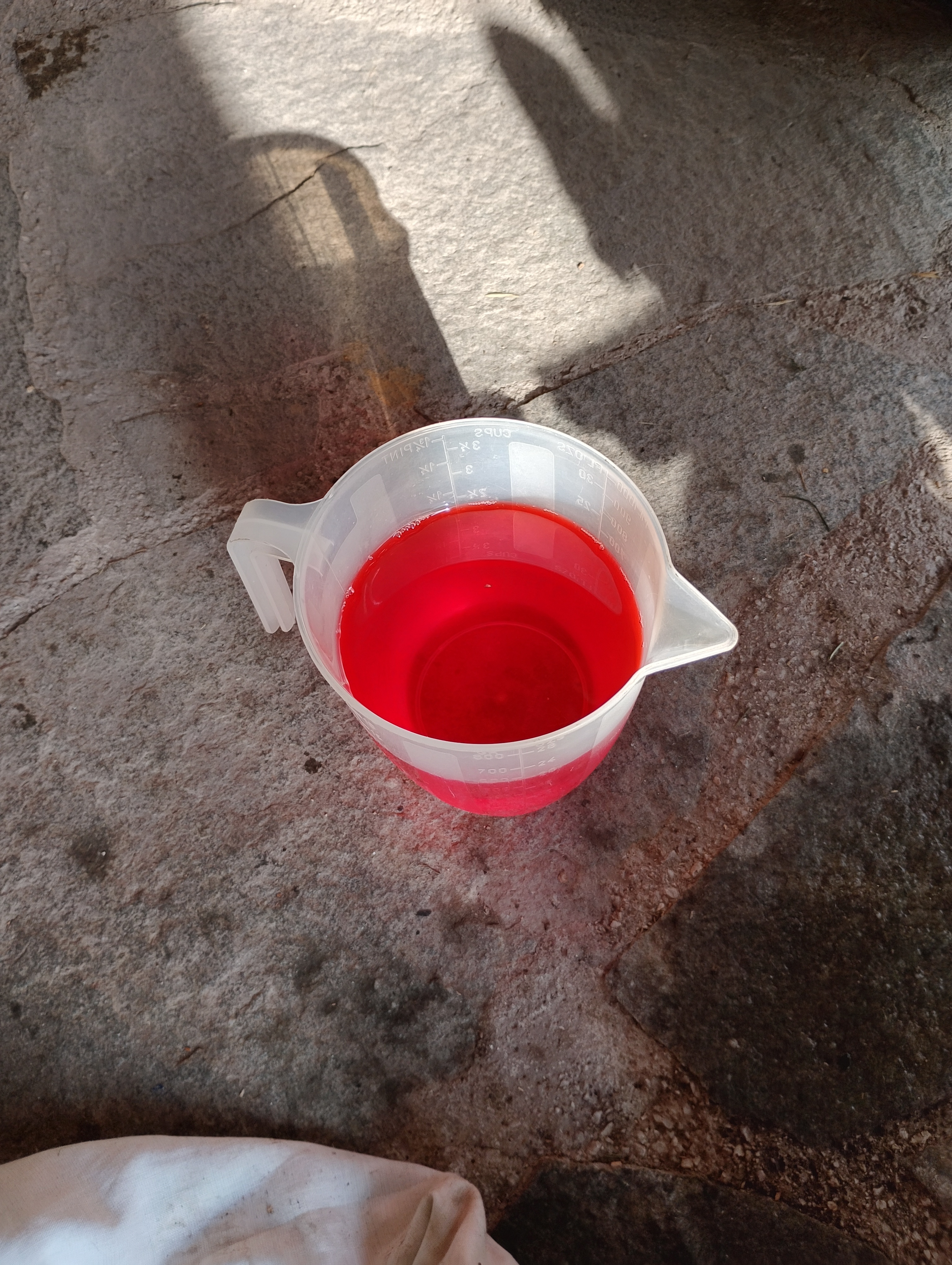

    As I am going through the newly acquired bike as we do not have up to date service records so have no idea when most things were done, checked and renewed in most cases. We know when the Oil, Oil filter, Air Filter, were changed as the seller did these for me he also fitted new Triumph front brake pads and of course the new Bridgestone tyres. This morning I flushed the clutch fluid through would have done the front brake but one screw does not want to move so need to get a new cross head bit for my impact driver.

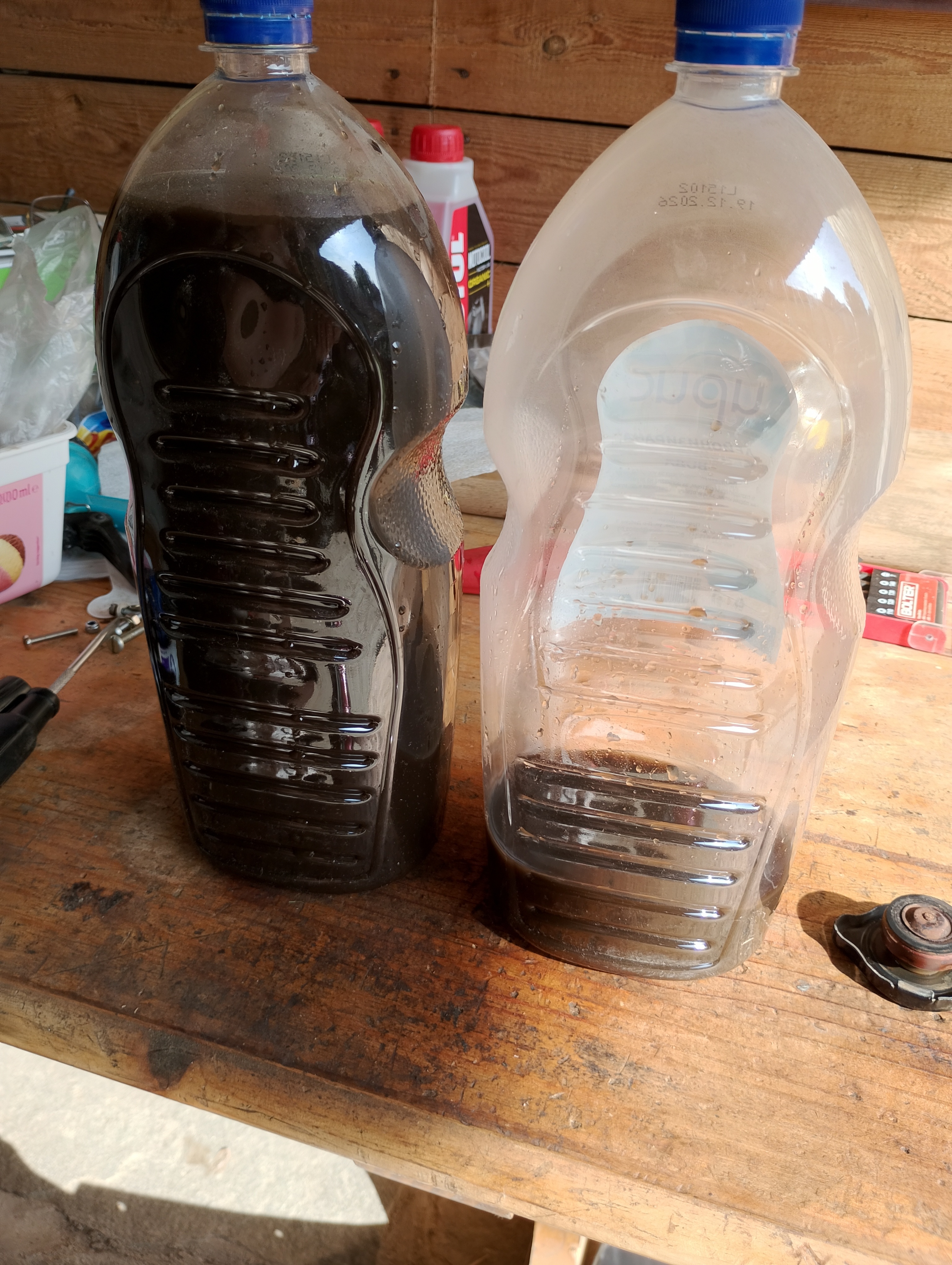

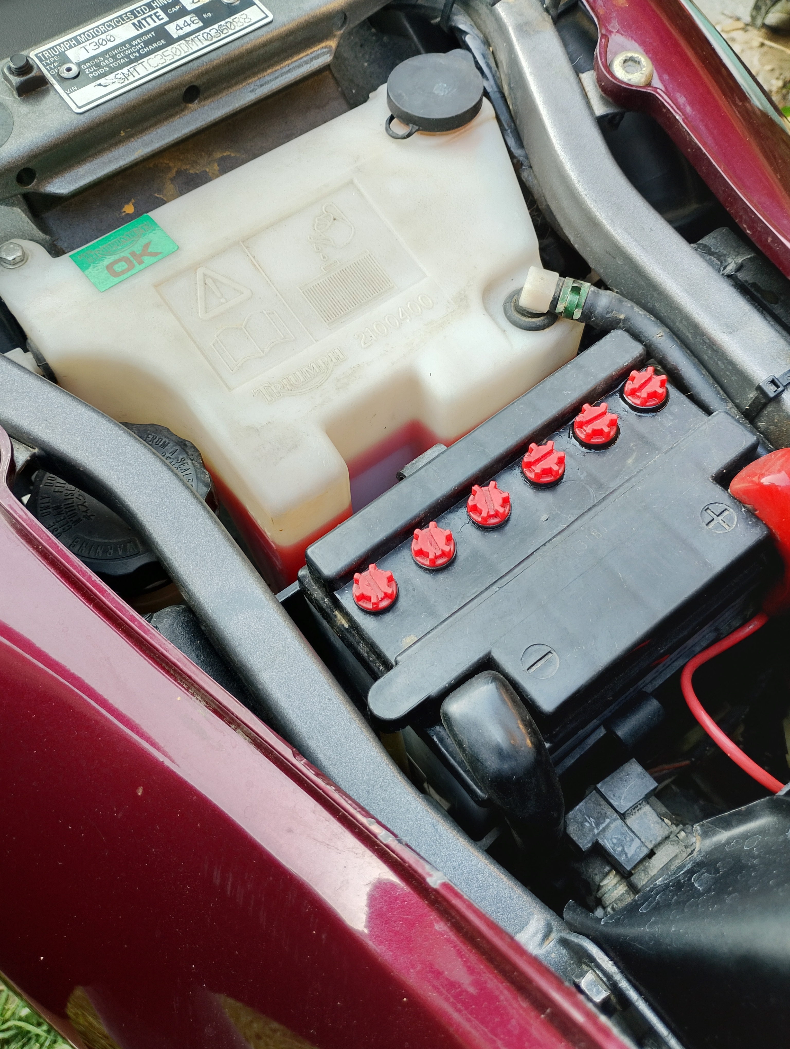

    Change coolant

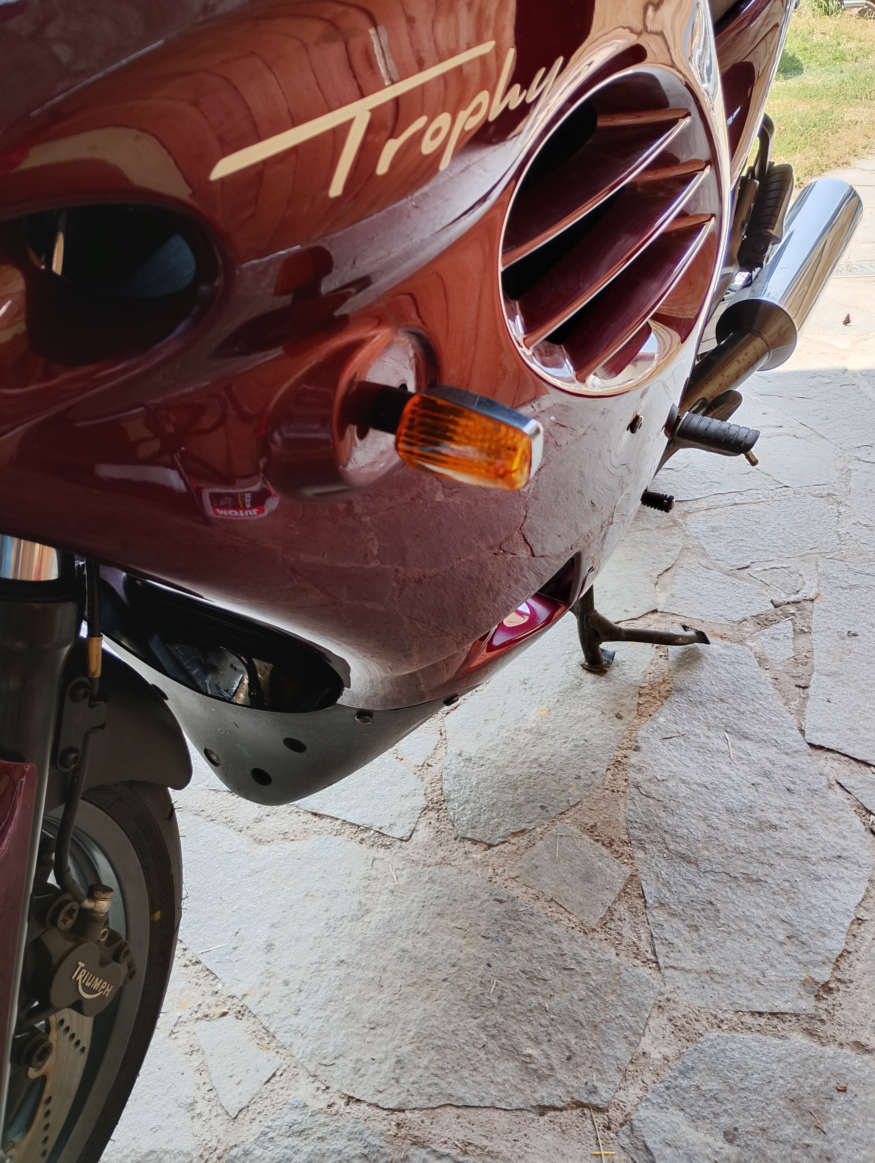

    Sort flashers out flashing too fast due to car relay being fitted.
    Get new front left indicator and fit.
