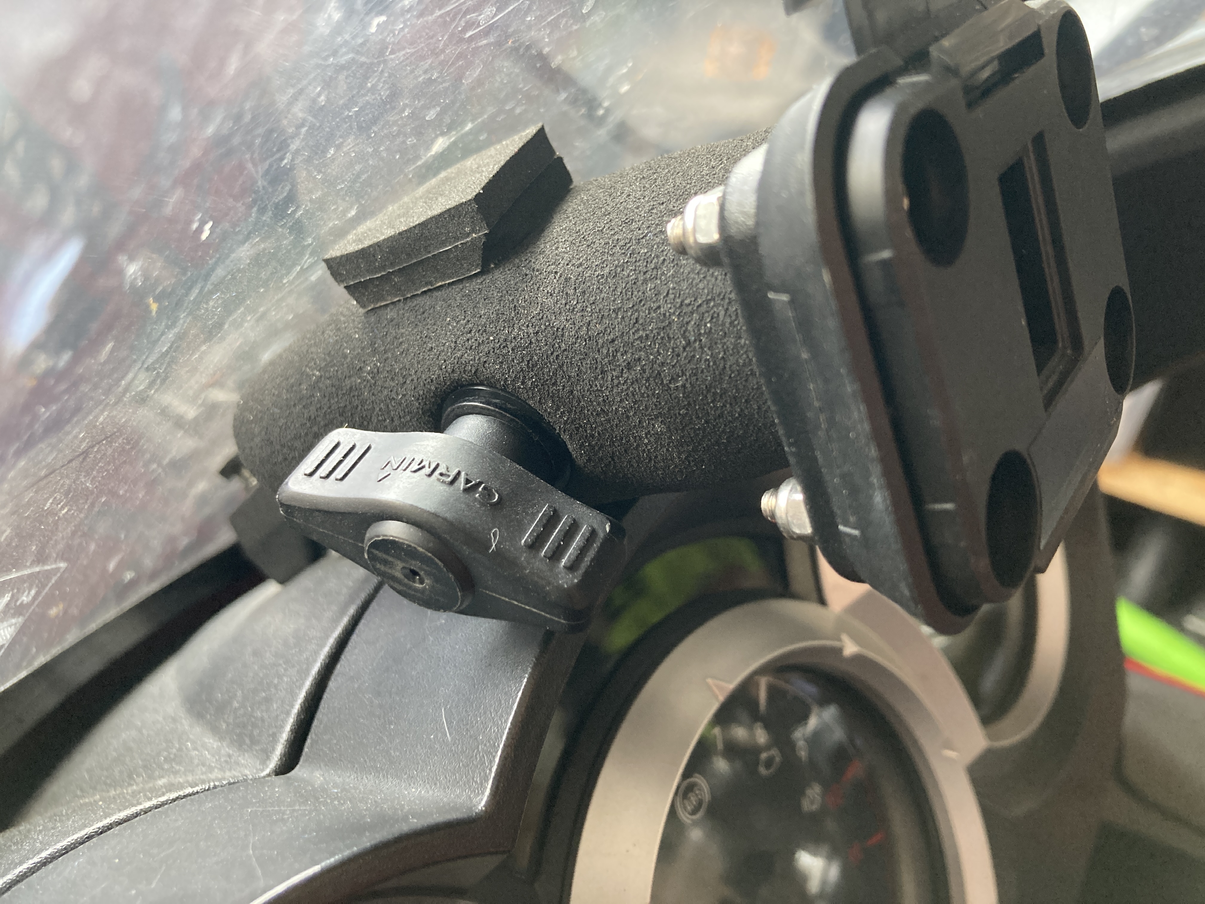

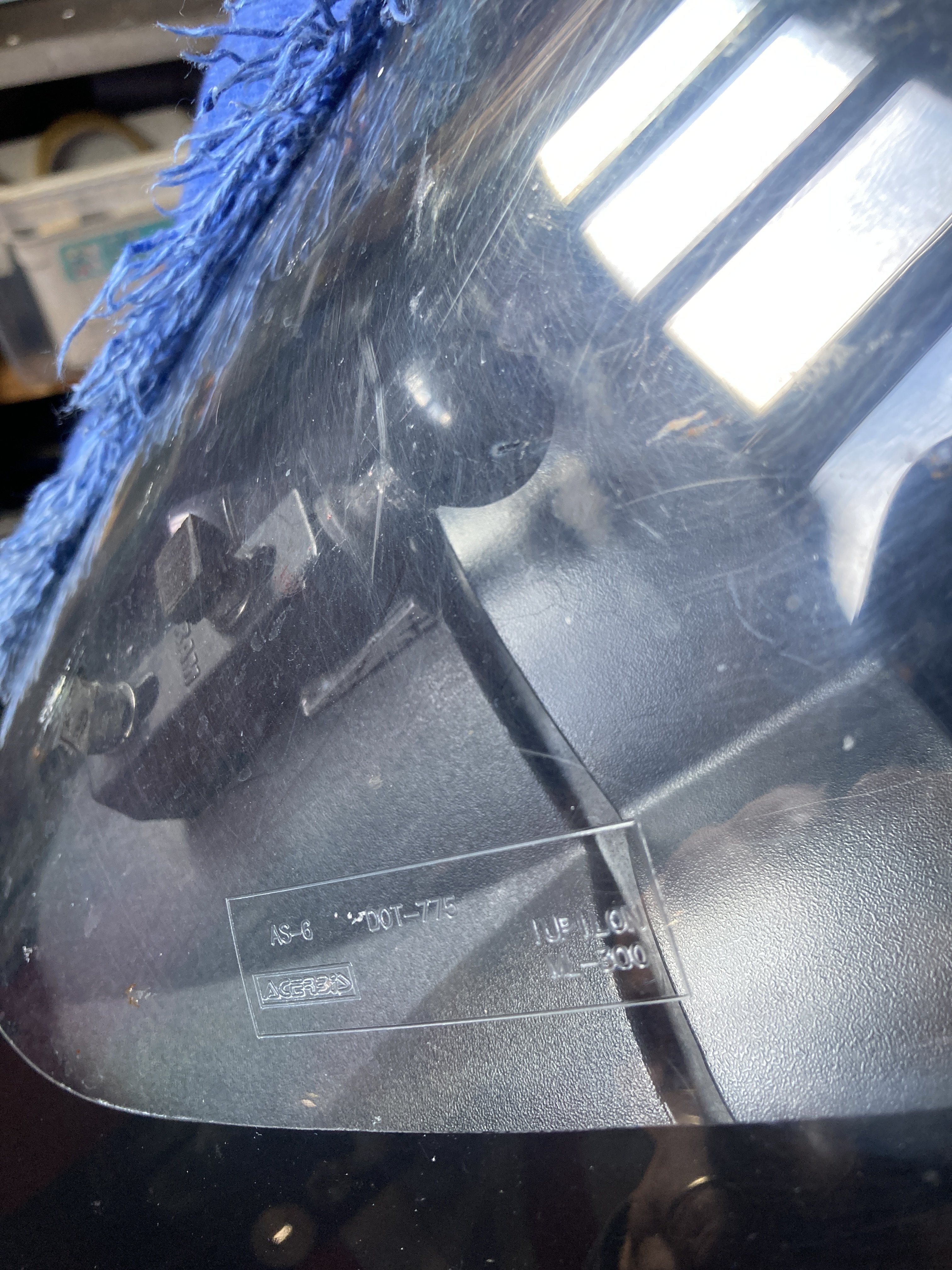

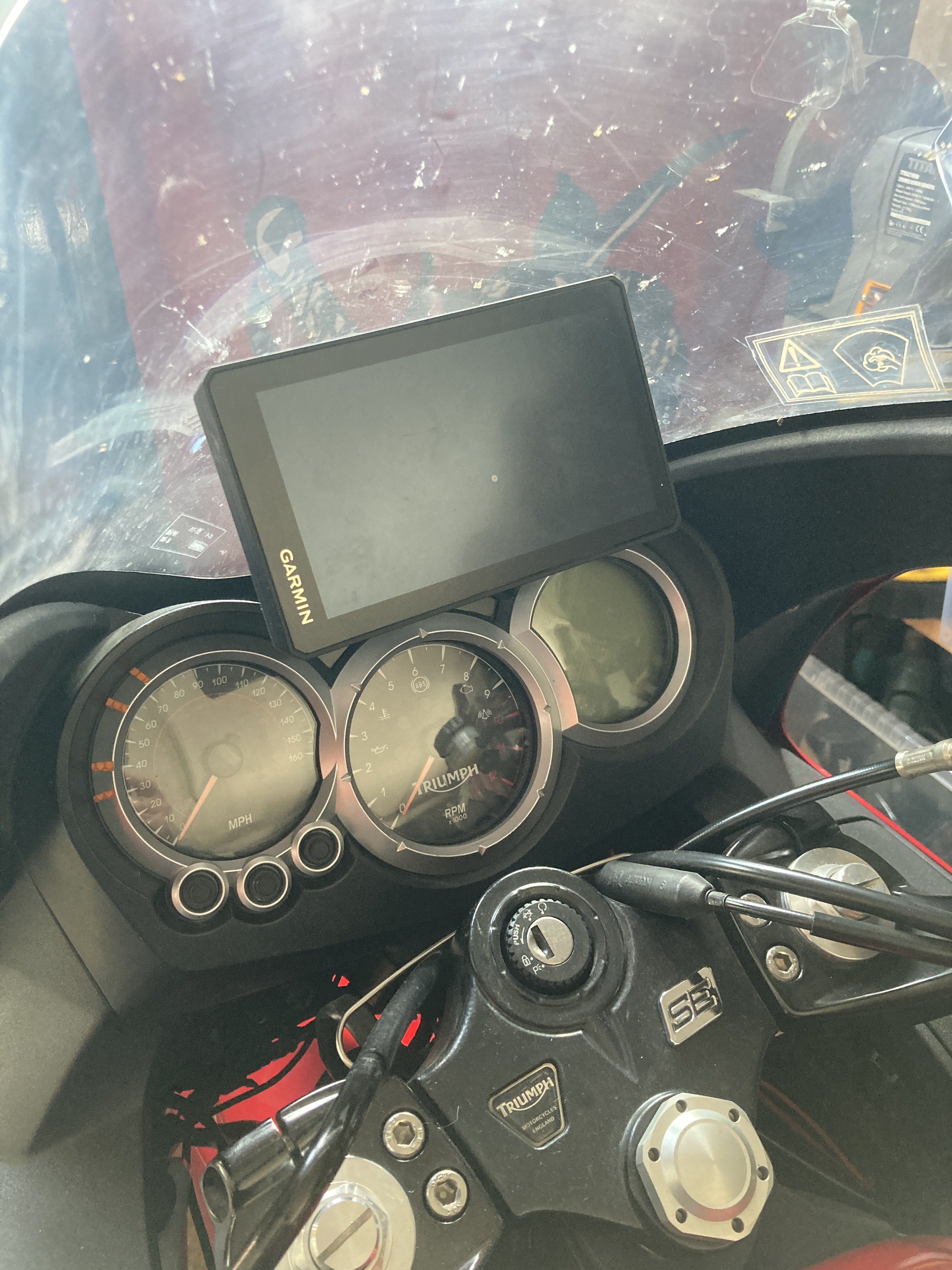

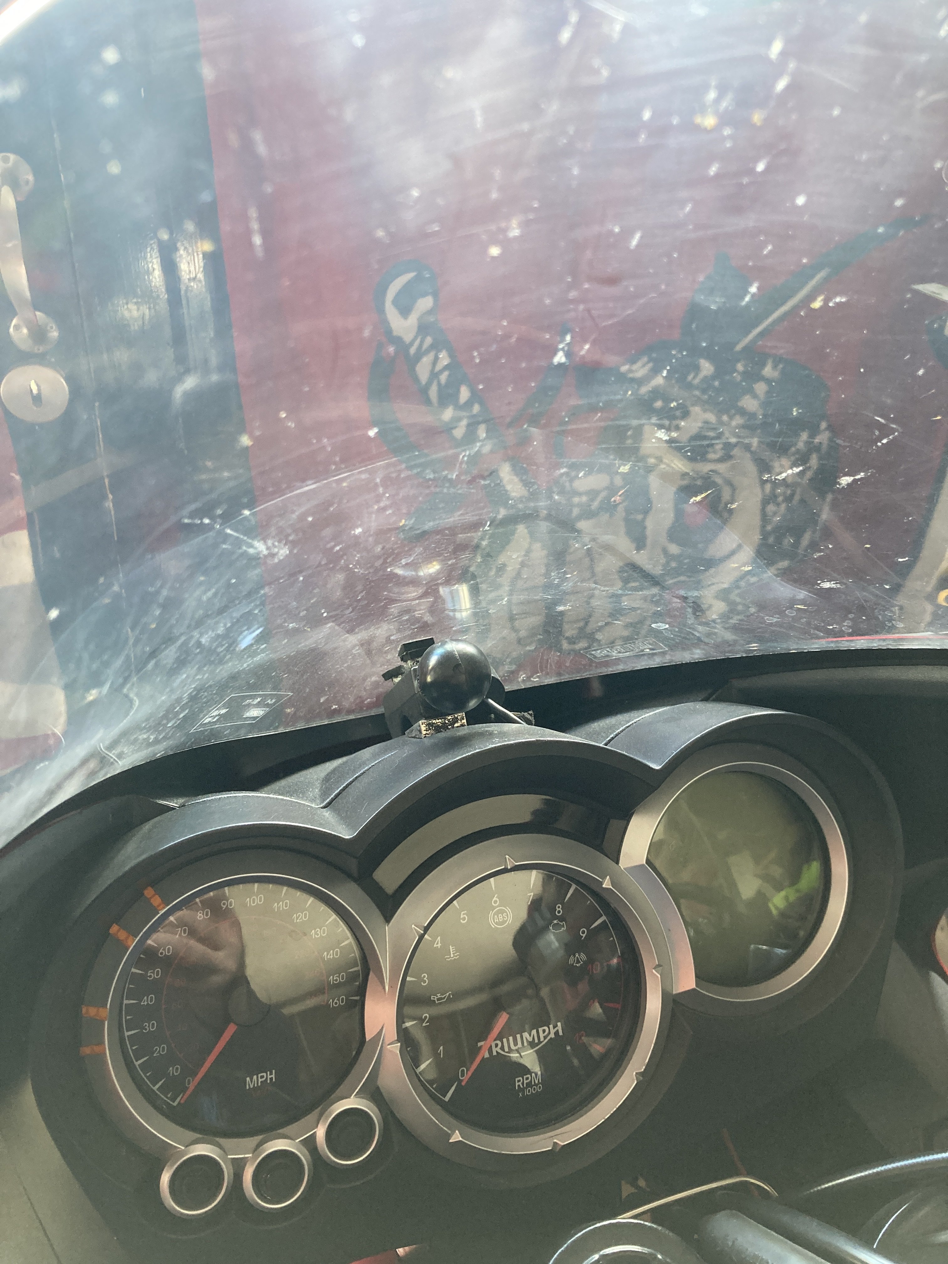

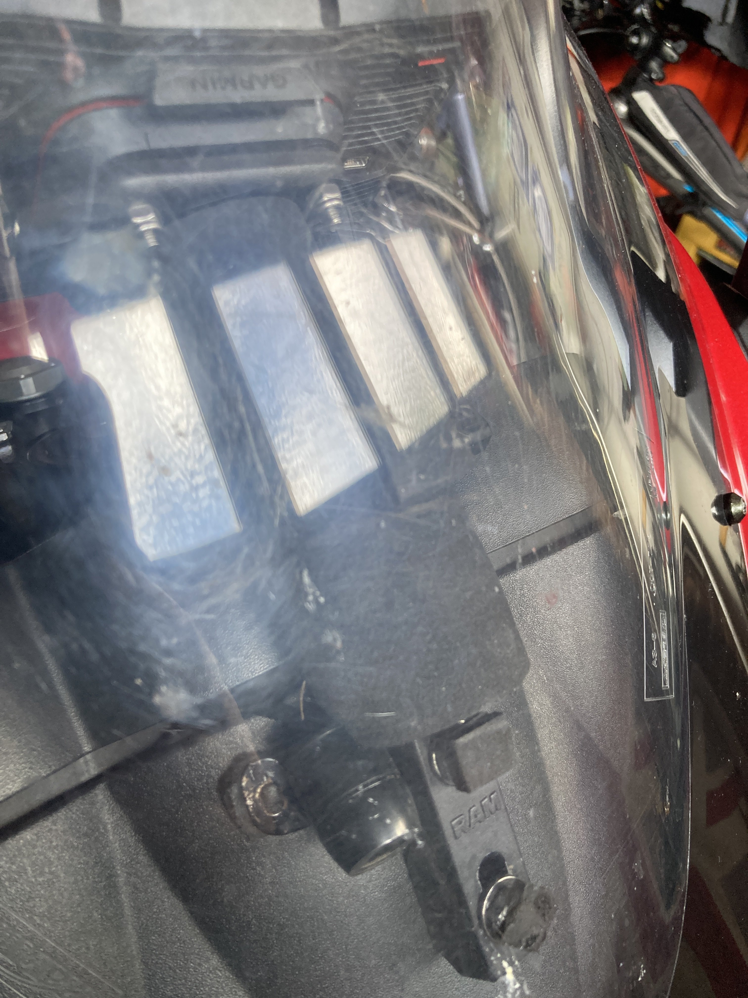

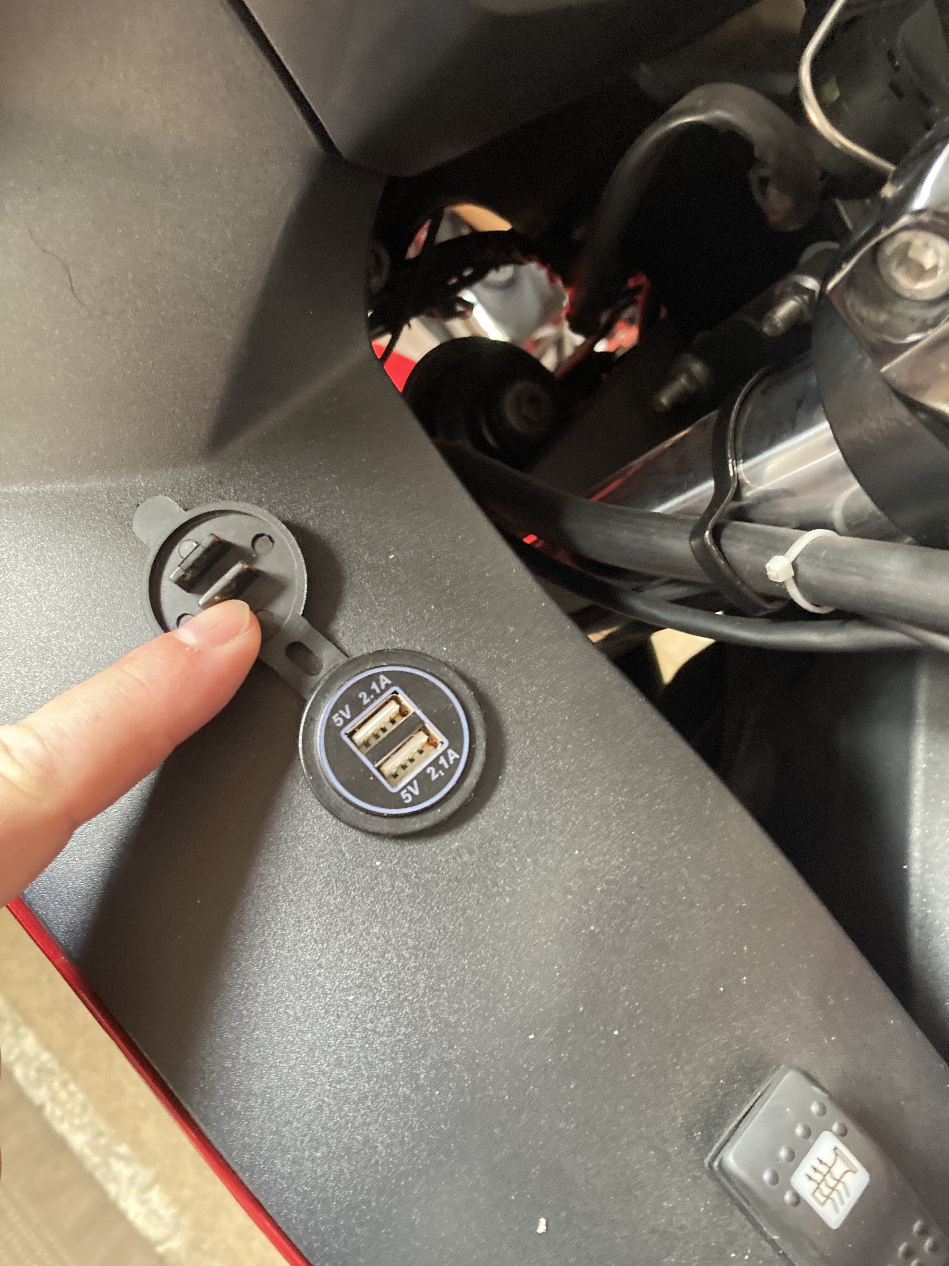

    Welcome to the forum. I have a 2016 Sprint GT which is great, apart form an intermittent starting problem. I think it is battery related. R.e. the sat nav mount, the most popular mount seems to be mounted on the steering boss - however, I never liked it as it was too low. There is almost nothing else out there, I assuem du to declining Sprint ownership. Anyway, I have a custom mount which I have made form RAM bits - it's bolted on the the nacelle thing under the screen and then I use a longish connector to bring the sat nav connector out to a reasonable distance. It looks a bit ugly, but works. However, it won't work with a standard screen as not enough room (I have a touring screen) and it is a bit tight with my Garmi Zumo - a smaller sat nav would work better. I added a USB port to the left hand fairing cover to provide power (there is a hella type connector, but it's too far). Some pictures attached.

    That's great info - the bike arrived and it has the touring screen to I can implement your method
