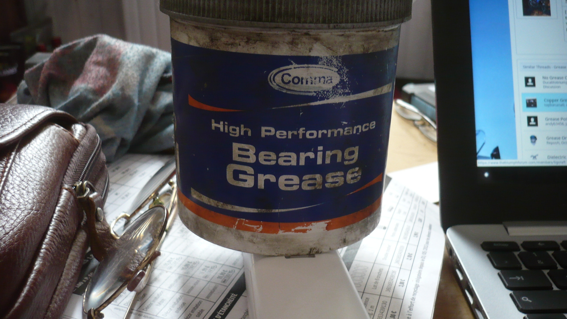

  15. thebiglad
    5,064
    Yes it is, just not as a bearing grease. Get specific bearing grease and you'll be fine - I use this stuff :

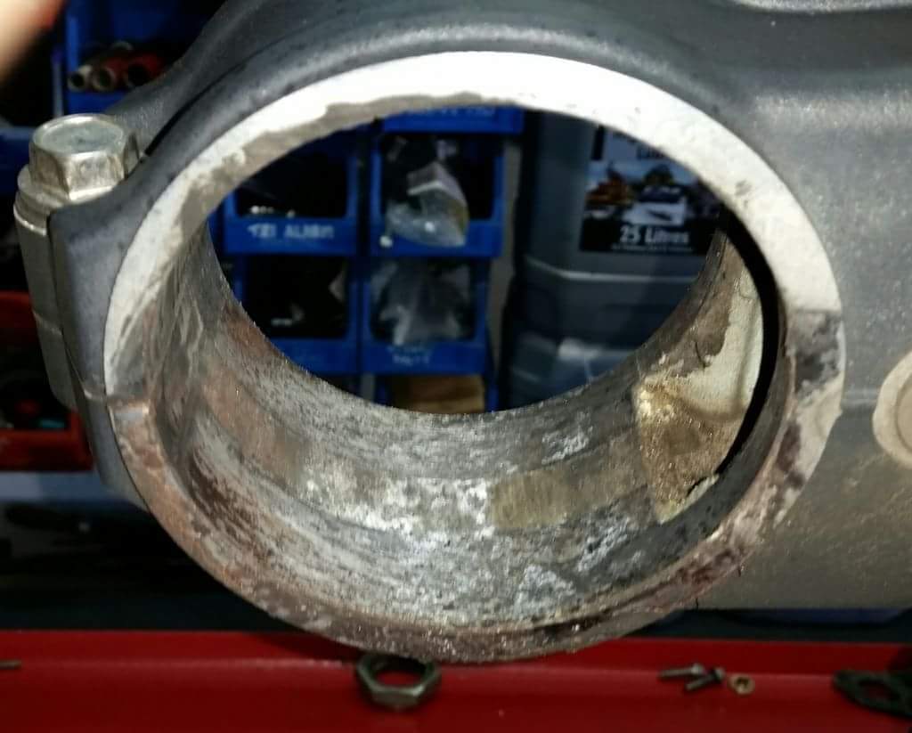

    These might help
  19. t552
    t552 Senior Member
    Nov 17, 2014
    415
    Bristol UK
    Good vids. But why go to that length and not remove the eccentic when they give so many problems with corrosion?
    Btw copperslip is what they use at the factory here.
  20. topbanana0
    topbanana0 Well-Known Member
    Mar 27, 2016
    226
    South Wales
    Yeah while your there, might as well do it.
