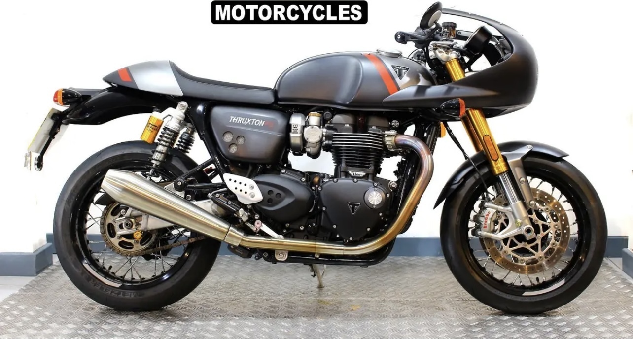

    I’m torn between getting the new FE or do I go for a 2nd hand RS, seems the Matt Black&Grey ones can be had for around £10-£11k. Also seen the Silver and Green for around £13K.

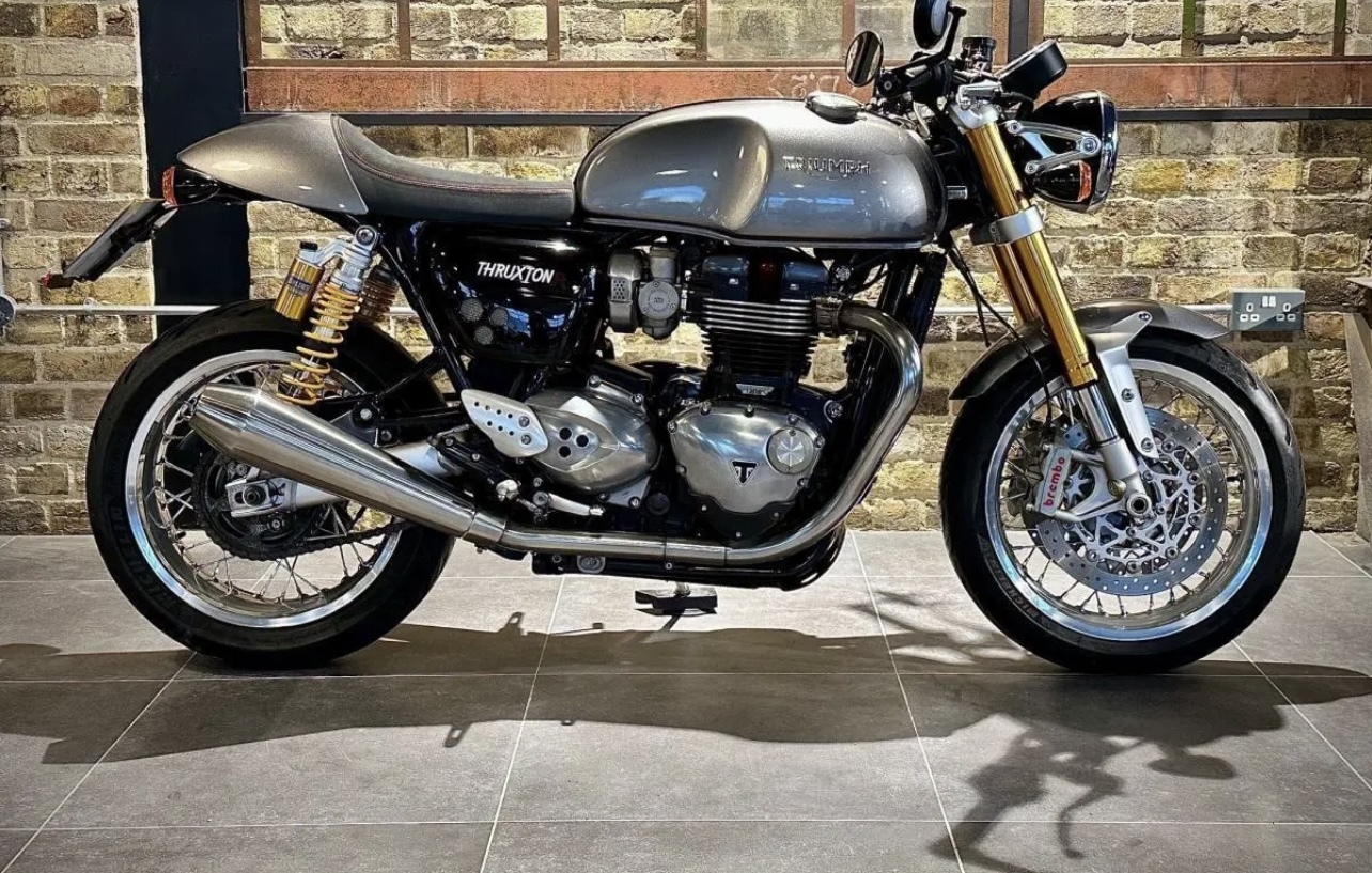

    Then just today I’ve seen a lovely 2016 Thurxton R in the Silver which is £8k cheaper than the FE, I could get this and would not be feeling guilty as it’s way cheaper than the FE.

    Thruxton RS £10500
    Thruxton RS £12500
    Thruxton R £8000

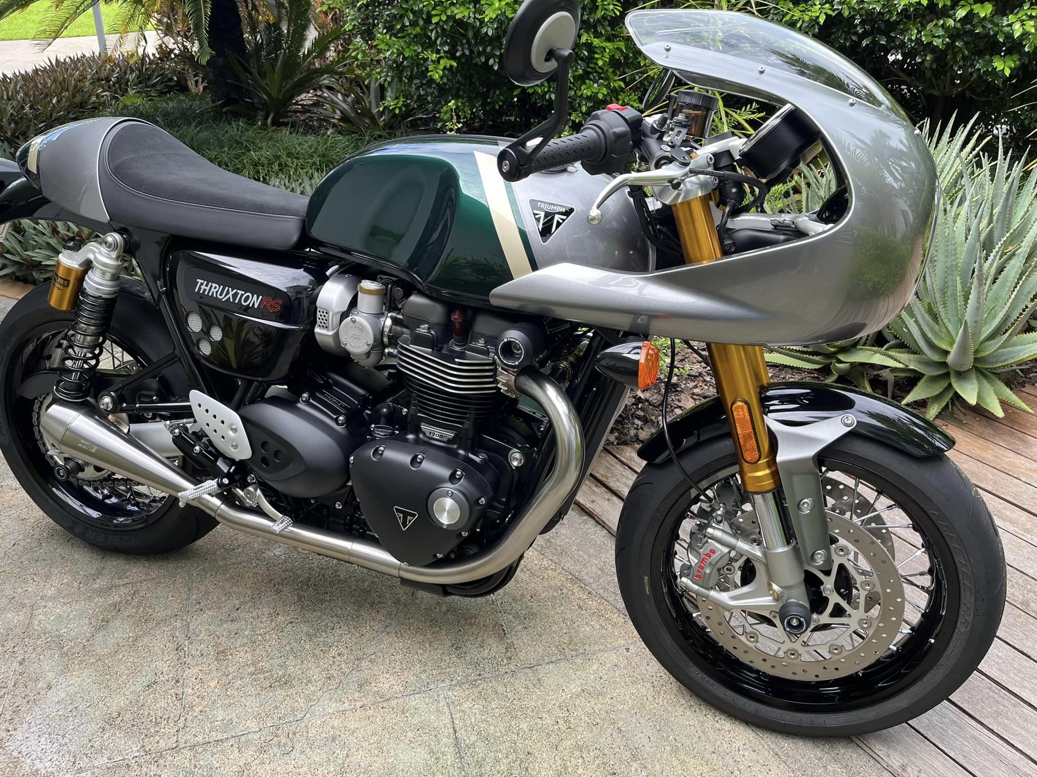

    The Grey/Green RS I am really tempted by, its actually less than £12k now and sounds and looks superb (had a video sent over to me) but its too far for me to go and look over.
    I'm waiting on hearing back about the Silver R and thats actually just been dropped to £7k.

    Found a better pic of the Silver/green one, it does look very good to be fair.

    Nice colour scheme. Other than colour and not knowing how much smoother the rs is compared to the R I’d argue that there isn’t a whole lot of difference between the two. Looks wise its down to colour scheme the R has aged very well. Not sure if u clocked my additional comment re difference between faired and un-faired and clip on height the difference is significant.

    I have exactly the same R as the photo shows: Silver Ice colour.
    Pricewise I would go for the R. There are only differences in colours (rims, springs, casings..) It is the same bike but with a few less hp but still plenty to get speeding tickets! No less fun on the R than on RS or FE. But in the end, it is all about personal taste and budget ;). Have fun and ride safe!!
