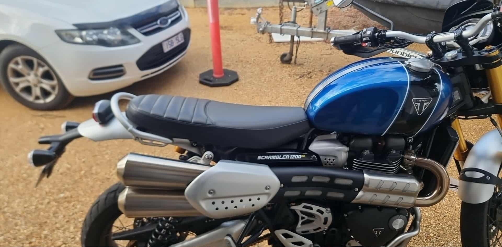

    My 1200 XE Scrambler came due for a service so I did it myself. Oil, filters, coolant etc. Now how do I get rid of the "service due" symbol on my display.?

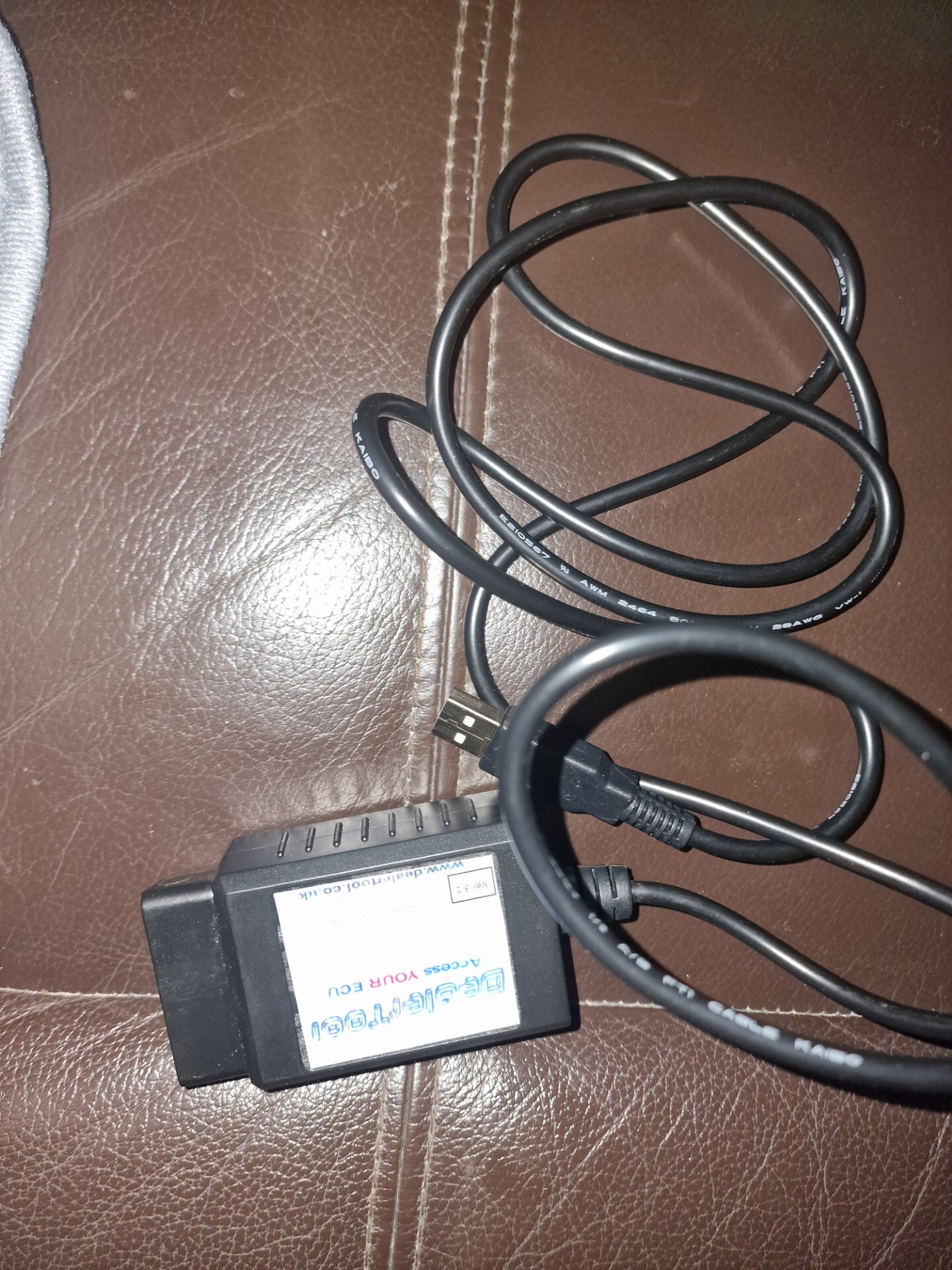

    The OBD unit is plugged into the bike's diagnostic socket, and you download the software from either Tune ECU or Dealertool, personally I would buy the Dealertool, it costs £65 and will perform what you require for servicing. It will clear the service light, allow bleeding of the ABS brake system, throttle body balance, etc. You will need a laptop running either Windows 10 or 11. I have attached a photo of the Dealertool OBD.

    @Neiljw Welcome to the family. Nice bike thanks for sharing the picture.
