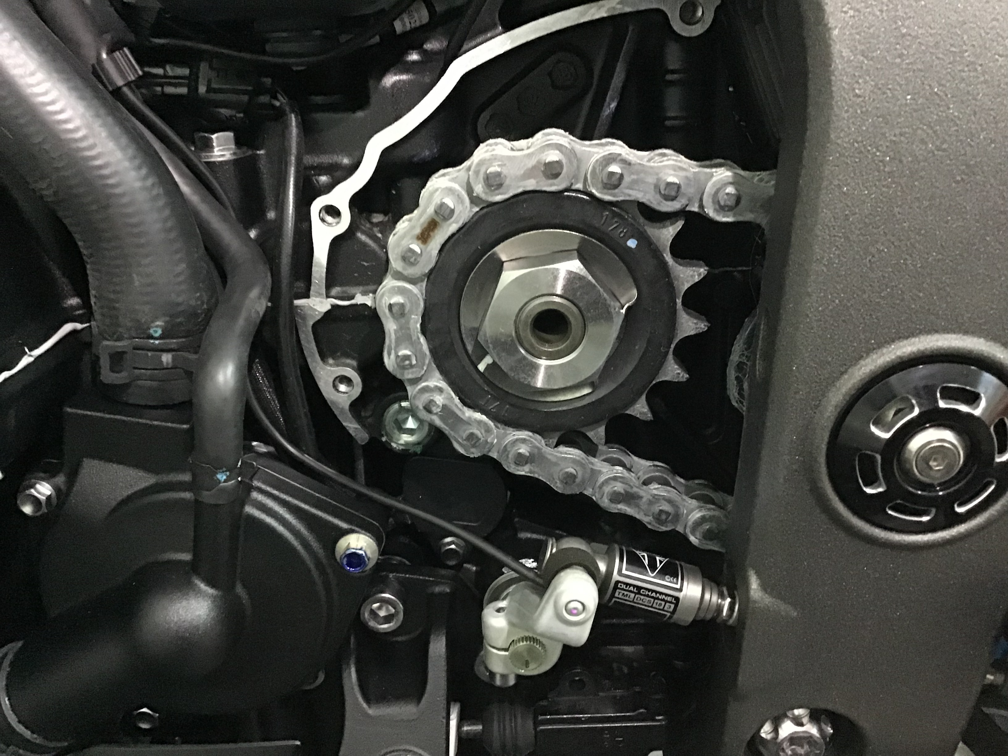

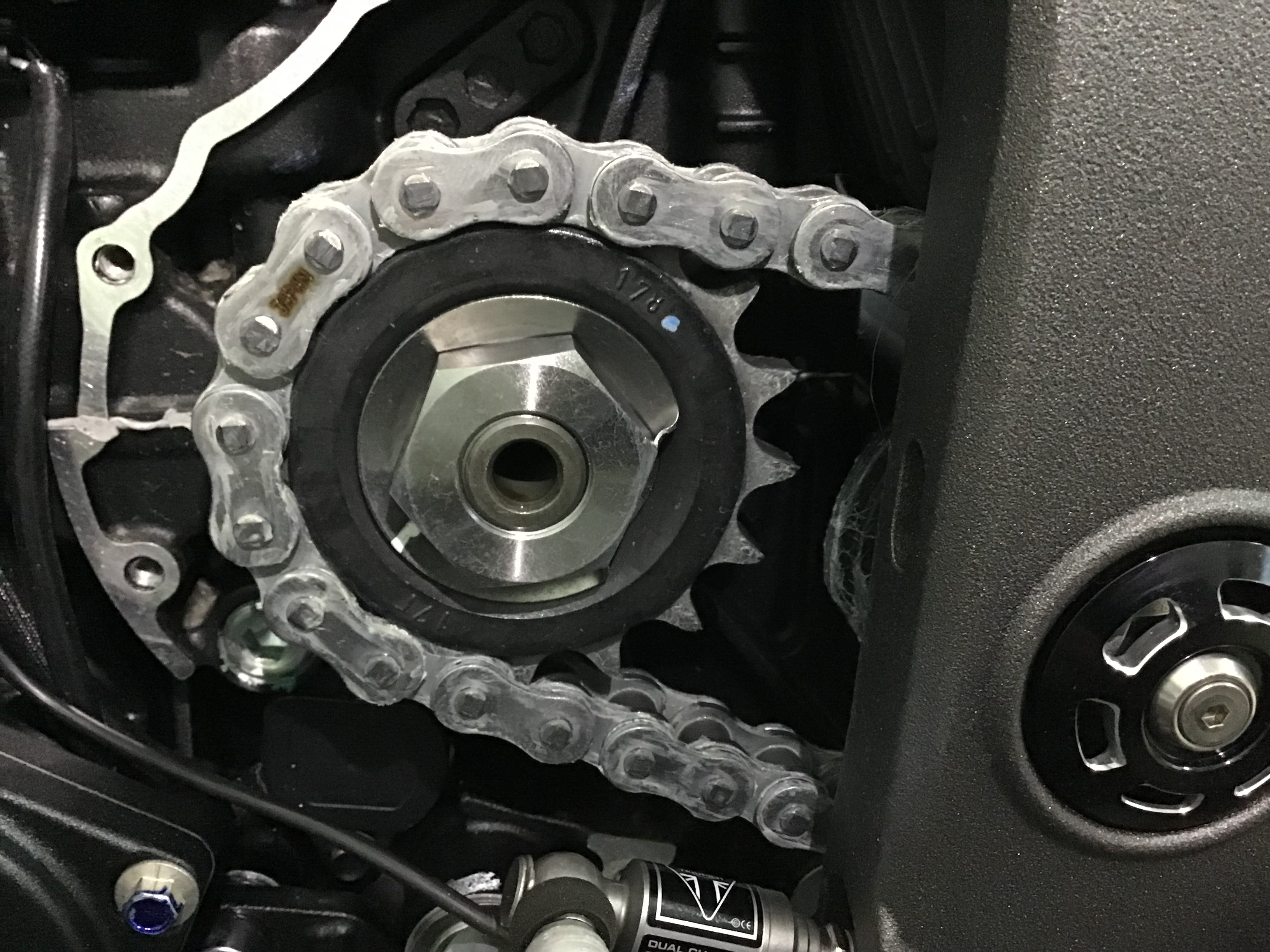

    Ok, I had to check it out. 17T is what it is. See photo below. Also, it looks like I maybe able to keep the cover off, as there are no wires/cables in the area to interfere with the sprocket.

    Why would you want to keep the cover off? You’re just going to end up with chain lube all over the area that looks so nice and clean at the moment. That sprocket will be spinning at a fair old rate and any lube, even that waxy shit that is on there now, will fling off all over the place.
  18. SteveRS
    SteveRS First Class Member
    Jan 12, 2019
    862
    British Columbia
    I use very little lube, again jokes welcome. On my Street Triple I only used WD40 and only a light wipe down once a week. There was 0 fling and the chain was spotless for 15000 K. I’m not a fan of sticky lube which attracts grit which in return destroys sprockets and chains, unless cleaned frequently. I have some Motul, I hope I spelled it right, I may try it and if that flings I will use the cover. I would prefer a nice CNC aluminum guard actually. We’ll see.
