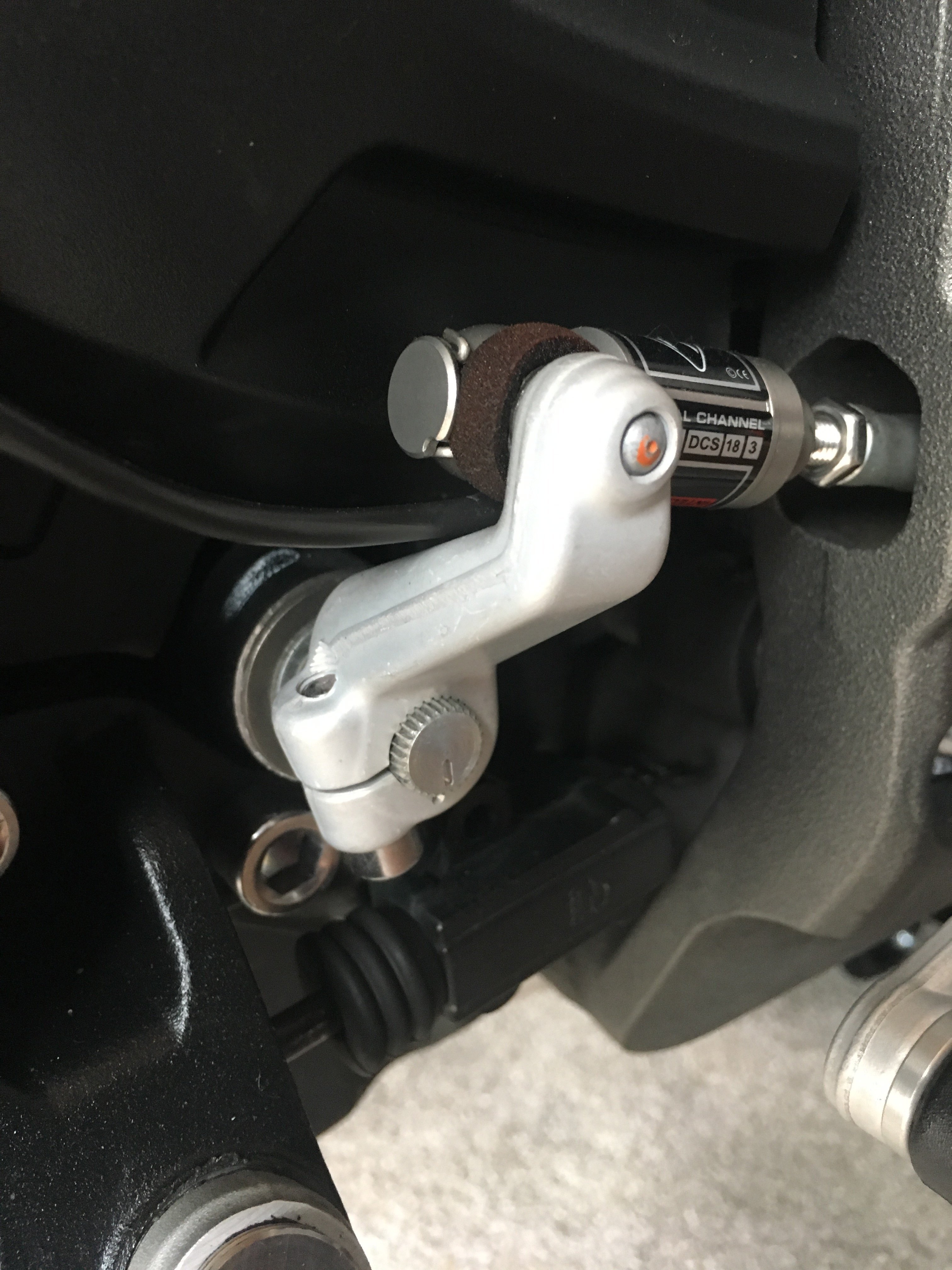

    I believe it is fairly easy to adjust the gear shifter but has anyone done it? I need mine slightly higher but as you can see there is a mark on the bolt and the arm which are currently aligned so I wonder if that’s just the default setting or if it must be left there??
  2. SteveRS
    SteveRS First Class Member
    Jan 12, 2019
    862
    British Columbia
    That needs to be left in place. To adjust the length, you need to remove the rod from the output shaft lever and use the nuts on the shaft to adjust the length. I just reread that :joy:. Anyway, I was under the impression from several sources that the length of the rod had to be a specific length in order for the quickshifter to work, but that’s actually not true. I found it easier to adjust it when the rearset was removed, which is just two bolts by the way. Once the rearset is removed pop the rod off the output shaft lever and pull it through the hole from right to left. Make the adjustment then reinstall. Keep in mind that I don’t use the quickshifter, so I can’t comment on it’s performance when adjusted, but others have and they say it works fine. Holy, that was longer than I expected.

    I wouldnt touch it, it's the original shift arm not the machined/altered one.
    If you move it and it starts touching the qs your problems will be endless, trust me!
    I suggest you read through "speed triple rs 4th gear problem"

    The reason the arm and shaft are marked is because the gear position sensor (on the other end of the shaft usually) and the quickshifter need to work in harmony and just one spline out will upset it all and the left hand won't know what the right hand is doing.

    The reason that the arm and shaft are marked is that there is a cut out (notch) on the shaft.
    There is a hex screw that holds the arm on the shaft (which you can see in the photo). In order to ensure that the arm is in the correct place (not too close to the gearbox, and not too close to the end of the shaft) there is a cutout on the shaft into which a portion of the hex screw locates.
    Basically, if you don't line up the marks the hex screw won't go it, but visually you won't see why - hence the marks. This is why you cannot (at least on my RS) move one tooth either way to adjust the gear shifter.
    You can - QS or not - change the length of the rod to make the same adjustment. Hope that makes sense!!

    If it was me, and I was adjusting the gear linkage for comfort, I would fit the new arm with the cutout (Part T2085100, pic below from another thread) while I was doing it.
    The issue is that with the original arm, on most bikes, the quick shifter barrel only just clears the arm. And on many, the barrel of the QS just catches on the arm, sending false signals and generally messing things up - hence why Triumph gave us a new part **.
    If it was me, I would be concerned about adjusting the gear linkage and then inadvertently ending up with a QS that catches on the arm.
    I would hope you could request the part free of charge via warranty, but then they may want you to be experiencing issues first - for which you can always fib a little to get what you want.
    Changing the shift arm is actually even less work than adjusting the linkage, so I'd go for it
    ** I am aware that there are other issues with the QS, gearbox (especially 4th) etc etc. I just concentrated on why you would (or wouldn't) change the shift arm, as that was the question posed.
